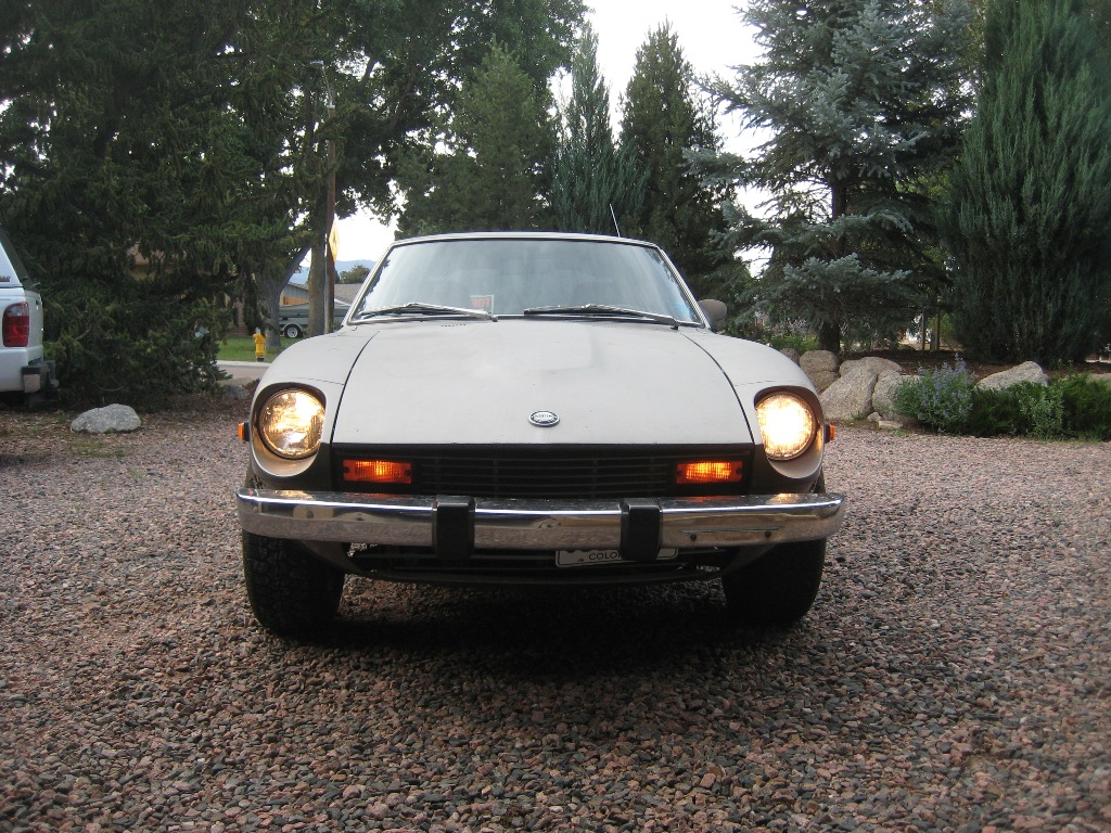

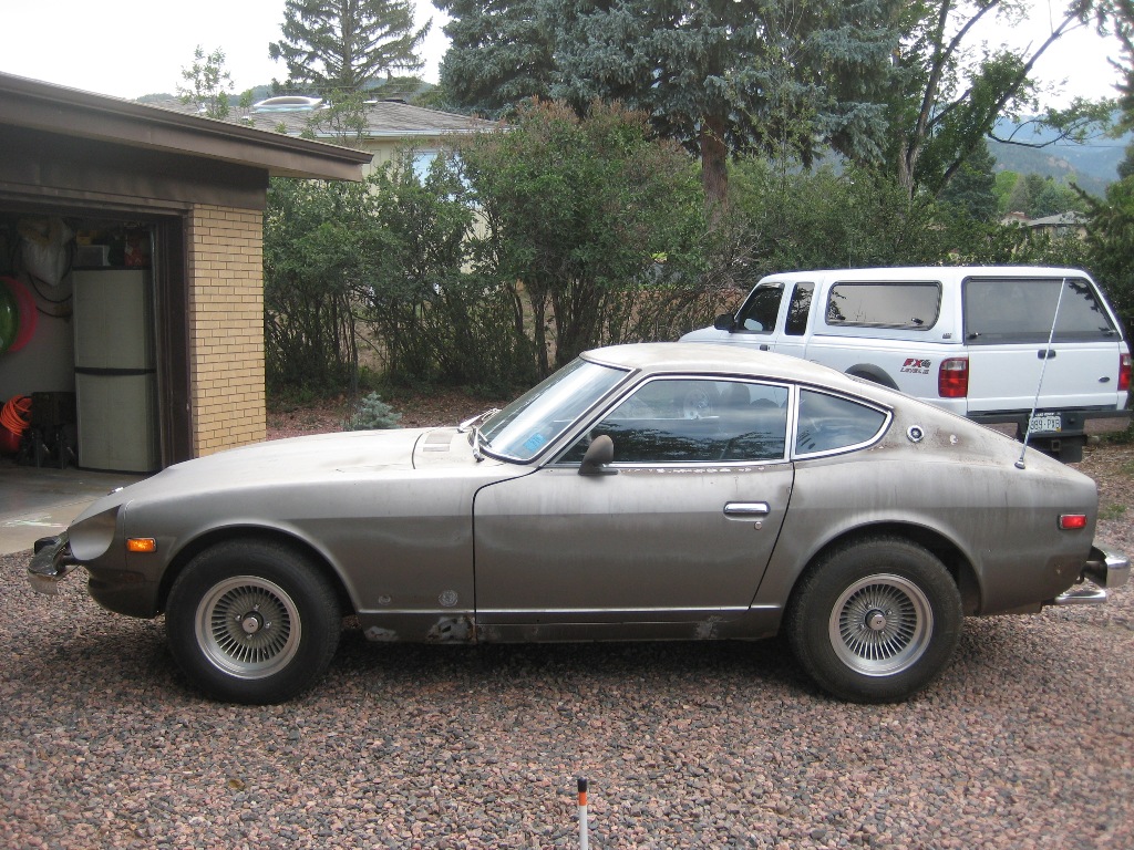

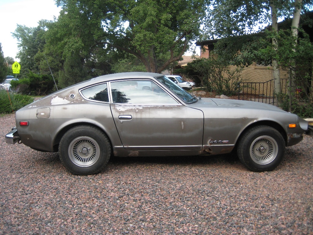

Hello everyone. I have recently purchased my first 280Z and wanted to introduce myself. Ive had a couple 300ZX and have always wanted an S30. I have big plans to restore her to her former glory. It is a 1975 280Z 4 speed manual. Color code 214 dark brown with black interior. The body is in decent shape just needs new lower fenders replaced and 1 small hole in the drivers floor pan. Also the inner fender area above the frame rails have the typical Z rust. Battery tray isnt too bad just surface rust. The previous owner started sanding down the car and primed the rusted areas, but it will need some major restoration.
My plans are:
Strip down and disassemble to the point where I feel comfortable putting back together. :laugh:
Media blast
Replace rusted metal areas
Paint and new undercoating
Reassemble with new or restored parts/hardware
Motor will be sent out for rebuild
New interior installed
New wheels, brakes, suspension, glass
Piece of cake, right??? LOL
here are some pics of the day I bought it. Let me know what you guys think!
