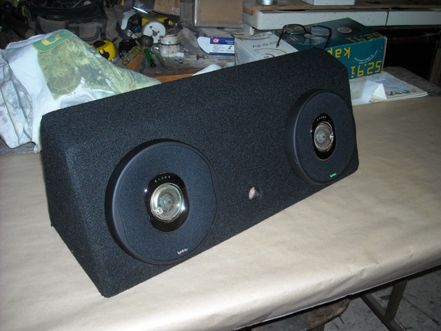

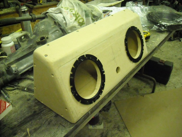

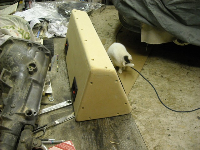

Well, I got the speakers started trying to come up with a box that fit into the back corners of the Z,but no matter what I came up with it always seemed that most of the sound was going to hit the back of the shock towers so have built a box to sit dead centre but snug up against the latch.

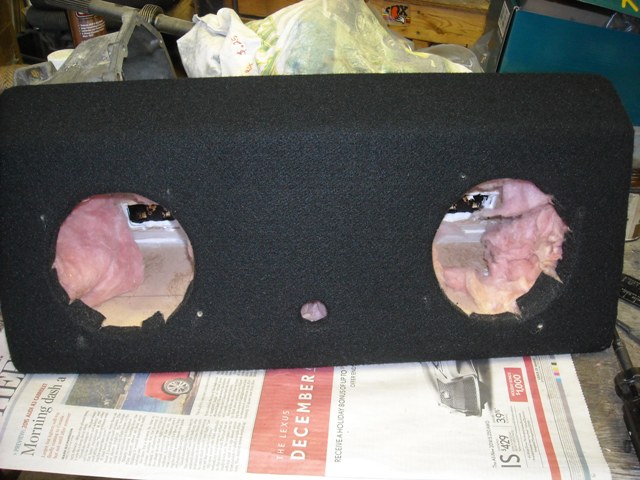

Everything I read about ported vs unported was just frankly confusing so I ported the box and I'll rig up a solid plug for the port and see which one sounds better.

What I read recently is that a ported box is louder for the same amplifier power than a closed box but to get the same bass response from a ported box compared with a closed box with sound deadening inside you need a bigger ported box. Does that have any agreement with what you read? I thought the explanations regarding ported VS non ported that I read were confusing too. I'd really enjoy reading your ported VS non ported test if you do that. Nice job on your speaker box!
