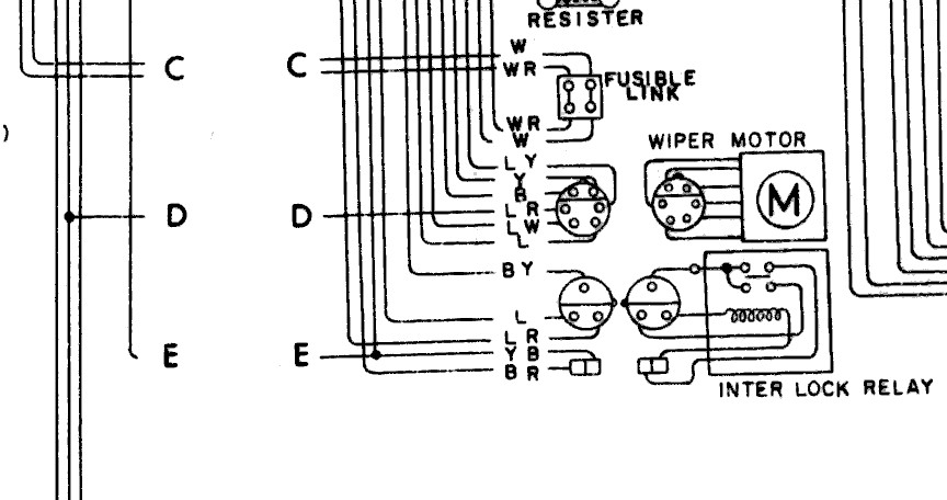

I'm going to guess that you jumped the wrong wires. Just because everything worked fine before. On the 76 cars, the power to the starter solenoid and the power to the ignition system are all on completely separate circuits, initiated at the ignition switch. Odds are you've jumped switched power to the starter solenoid wire
The wiring diagram for the 260Z is harder to look at but here's a link if you want to dig in - http://www.atlanticz.ca/zclub/techtips/wiringdiagrams/74_260z_manual_wire.gif
https://www.classiczcars.com/topic/48111-starter-question/#findComment-437695
Kind of what I was thinking. I jumped the blue and yellow/black based on what I read on another thread here.
I'm open to suggestions.:)
https://www.classiczcars.com/topic/48111-starter-question/#findComment-437699
You could reconnect everything to see if the switch is bad. If it still does it, ordering a switch might be a good idea. If not, you've ordered an extra switch.
I copied the relay picture. I didn't follow all the traces but yellow/black is power to the starter solenoid (it's where "E" goes). Black/yellow is the other side of the relay, which I think is what needs power. SteveJ probably knows but maybe you went yellow/black, when you should have went black/yellow, and connected switched power to the solenoid.
