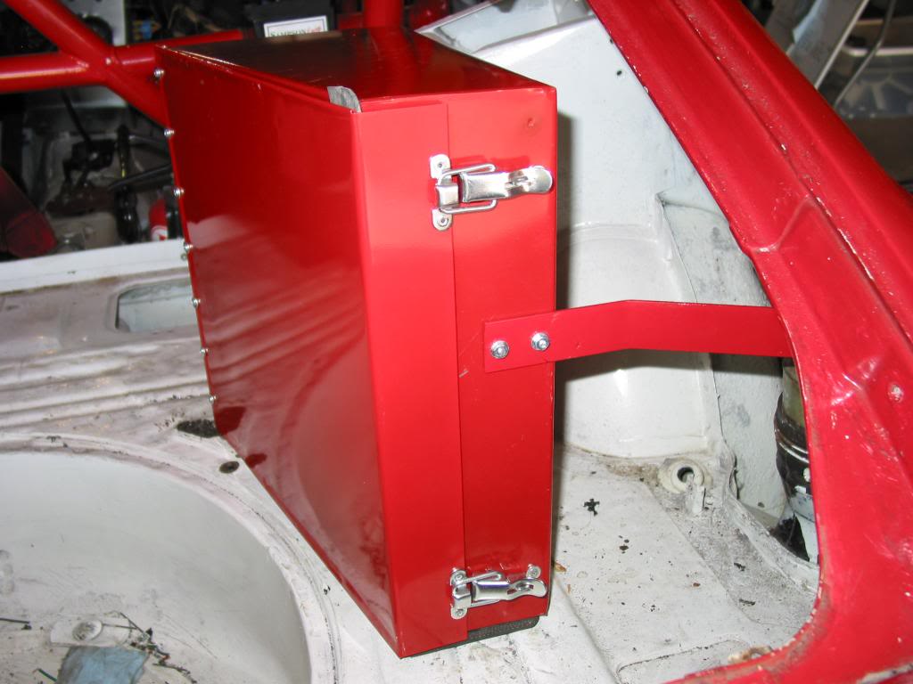

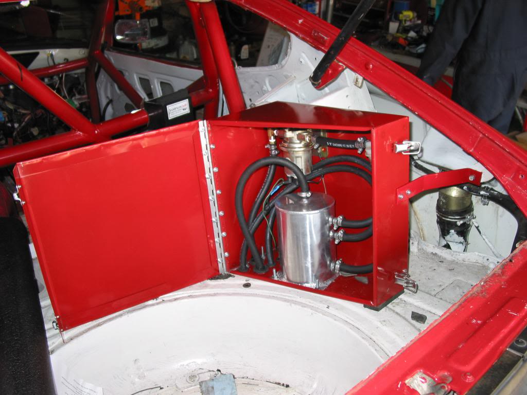

I run the Carter pump in my race car and it works great. My installation won't really help you though. I run a surge tank to maximize the range. Before the surge tank, I could only run about 1:40 on a tank, but now I can run a full 2 hours which is our driver stint limit. I run a Facet pump to get the fuel into the surge tank and then the Carter pump to feed the engine. The Carter is fairly loud, but it is inside the car. The Facet is much louder and it's under the car.
