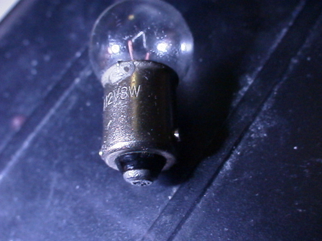

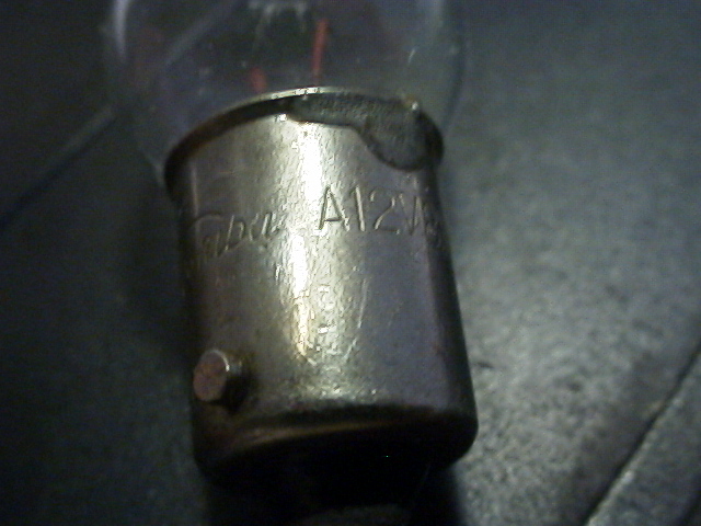

How do I identify a replacement lig ht bulb for the engine bay trouble light? The bulb in the one I have says Toshiba A12V8W on it meaning 8 watts but when I got a spare at the auto pa rts store the new one wasn't as bright. I compared current draw and the original 8W bulb is showing just over .5A while the new one is at .12A.
Both pictures are of the original light bulb:
The "posts" that stick out the sides are in line with each other. I have seen bulbs where the posts are offset but not on this bulb.

I googled the number and found this site List of automotive light bulb types - Wikipedia, the free encyclopedia.
I think the my docket is wrong, so I checked mine in the car. Its a BA9s 12V 8W which is the miniture bayonet.
Found this site for the LED's: BA9s LED Bulb - 4 LED | BA9s and BA7s LED Bulbs | LED Car Bulbs | Super Bright LEDs
The BA9S-W4-90-12V looks like it might come close to what you want and they only cost $3.

Thanks for the info! That website lists an old designation for the BA9 as T4/8 which seems to suggest they used to make it in an 8 watt rating, now it looks like the BA9 is available only as a 4 watt. That LED version only draws .23 mA but is listed as a replacement for the 4 watt BA9 if I am reading that right. I wonder if the original bulb rated for 8 watts got a little too hot for the miniature bayonet socket with that much wattage in such a small package. No problem for LEDs though. Thanks for providing clarification. I found some light bulbs with a BA9 base (miniature bayonet) on eBay, #1895 Lamp, 3.78 watt. Should work okay.
