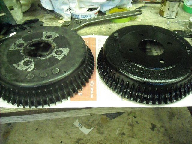

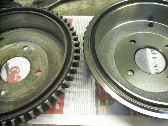

Just for anyone interested here is the original aluminum drum on the left and new cast iron on the right,
Aluminum drums are 4lbs a pc. cast Iron are 12lbs. Not happy about that but the old ones were 4mm over the max dia. so it's no wonder I could never get them to lock up.
except that 16 pounds is unsprung
Very true, but unless you seriously autoX or track your car, I doubt you'd really notice any difference.__ Also, stiffer springs and better shocks can help to somewhat offset the added unsprung weight penalty.
For most of our "weekend" or daily driver cars, the impact of cast iron brake drums isn't going to be an issue.__From my perspective, it's more about keeping our cars on the road.
Heck, I don't "jump & rebound" like I used to either, but I still get around just fine! ;)
There are companies like Whitepost Restorations that will turn and re-sleeve your aluminum drums with brass linings, keeping them lighter than the cast iron alternative.
http://www.whitepost.com/brake.html
They do great work, but it won't be inexpensive. I suspect re-sleeved drums might not be acceptable for a track car, but they work fine for street use or light autoX.
