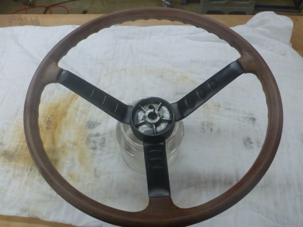

After reading several posts on this project I refurbished my Z's steering wheel as follows:

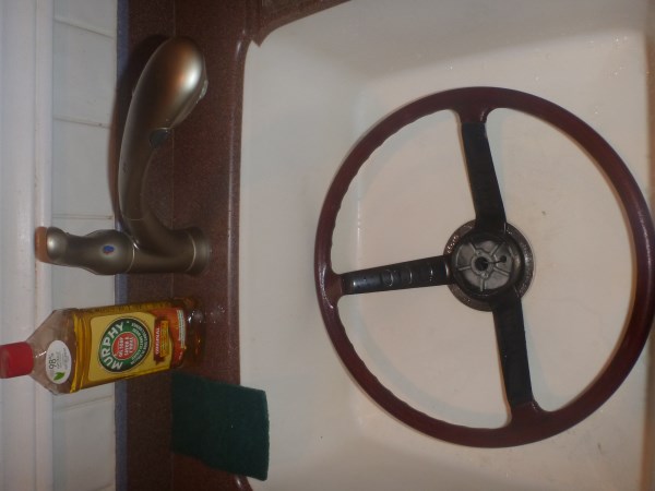

1) I cleaned the grime off the rim with a green pad and Murphy Oil.

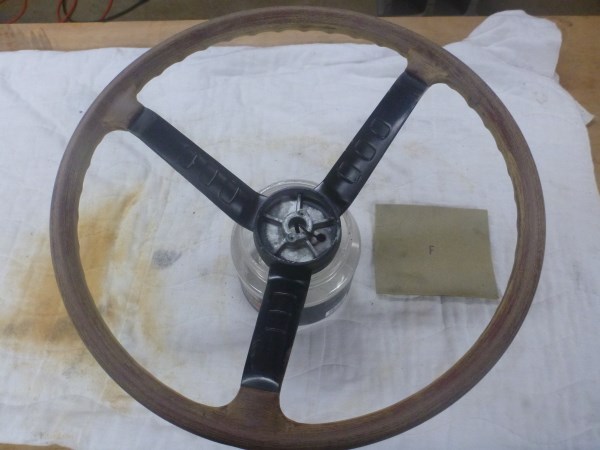

2) Next I sanded the wood/epoxy rim with a fine sanding pad.

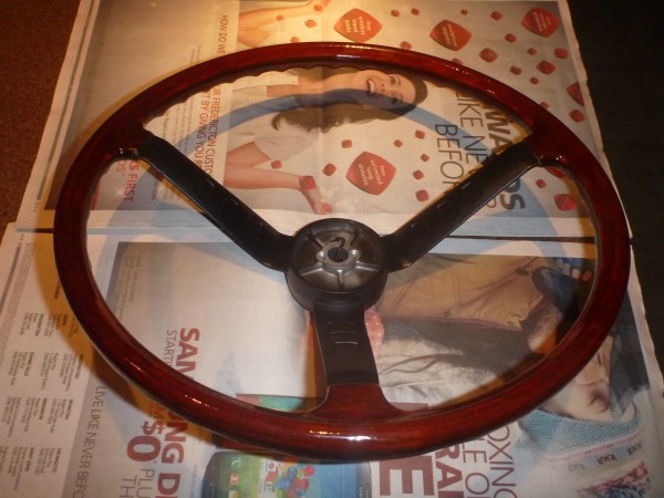

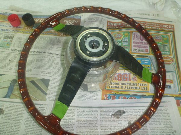

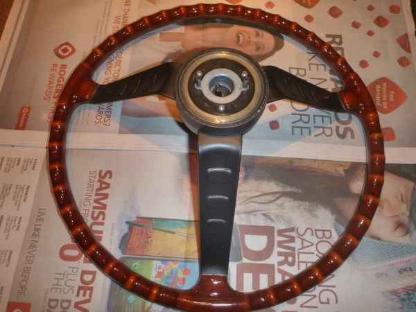

3) After taping off the spokes I covered the rim with 'Famowood' Gloss Glaze Coat.
4) Taped off the finished rim then sanded (to 400), primed (self etch) and painted (semi gloss enamel) the spokes.
George
