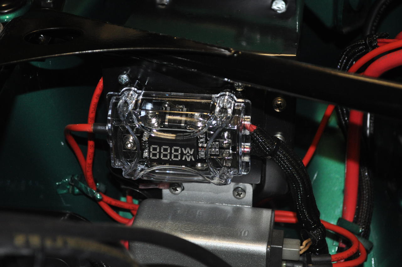

Having said that, the wiring diagram I used from the FSM was from a 74 so there should be good correlation. I have attached a PDF showing a simplified version of how it was wired from the factory as well as how I rewired it with a new external fuse block. I've also included a picture of the fuse block install as well.
Hope this helps.

Hyper, I'm unfamiliar with the 240 wiring, but I did my '78 280 rather simply, somewhat like you show. I attached a second battery cable from the starter post to the maxifuse block. I then had one fuse for each circuit (mostly white and white/red wires -- the later 280 having about 6 circuits, as I recall). Then I added a back-feed circuit just for the alternator, with a generous ampacity of fuse -- 80A as I recall. I connected this circuit directly to the alternator with a new, heavier gauge wire (6 awg, as I recall), stripping out all the awful (factory original) mess of branched white/red wires. I think I used my 8th fuse position for my stereo system.

I do not think that edit is correct as the original fusible links were powered separately and each link protected a certain part of the electrical wiring system. At least that is how my car was originally wired and I spent an inordinate amount of time trying to get these diagrams correct. However, with the replacement fuse block that I used, the input feeds are ganged together and so there is only a single supply source that I use with the new fuse block. That is why you see them connected together in the "new" wiring diagram. Let me know if you have any other questions on this and I'd be happy to help you out. From my experience, this looked like it was going to be a lot more complex than it actually turned out to be. A couple of other points as well.
1. Your car still has the "shunt" which is used to drive the ammeter in the car. You will need to hook this up correctly so you still get accurate readings for charge / discharge on your ammeter.
2. Not shown in my diagrams is an alternator upgrade that I also completed as a part of this. It simplified the wiring significantly as I used a "one wire" alternator that is internally regulated so I was able to remove the old mechanical voltage regulator as well as associated wiring, and the new alternator wiring was simply a single wire from the charge output to the battery. Couldn't have been easier and the improvement in the performance of the electrical system is like night and day. Went from a 60 amp output to 140 amp so I have plenty of available charging power if I need it. Happy to give you the details of this if / when you need it.

Yes the fuse block I chose is very cool and adds a nice look to the engine bay. On top of that, you are 100% correct that it will also display both voltage as well as current (alternates between the two) and this can be very handy at times when trying to troubleshoot an electrical issue. I am happy to get you the details of this block (manufacturer, etc) if you are interested. I spent a lot of time looking for something like this but this is the product I ended up with. Very happy with it so far and certainly a vast improvement over the worn out fusible link system that was in my car.
Hope that helps.
Mike.

The part is made by DB Link / Strandflex and the part number is SFANLFB12DA. It uses mini ANL fuses and is very well made. I am happy with the product as well as the upgrade. You can get it am Amazon here:
Amazon.com: DB Link SFANLFB12DA Strandflex 2-Position Digital Mini ANL Fuse Holder: Car Electronics
Not bad for $32.

I believe that Nissan changed the size and location of the shunt over time. I recall that in the early Z cars the shunt was actually located behind the gauge itself, while in later years (not sure exactly when this started), the shunt was moved to the engine bay and the physical size of it grew significantly. I suspect that this had to do with the ever increasing electrical capacity in the car and the need for a much heftier shunt resistor to measure current for the meter. I also suspect that this is why they ultimately moved to a volt meter (like in Sarah's car and the later 280's).
In any case you can see most of the shunt in the picture I included above with the new fuse block. It is the large silver box just below the fuse block and it houses a very large resistor / shunt that is capable of passing all of the current that the car requires.
Mike.
