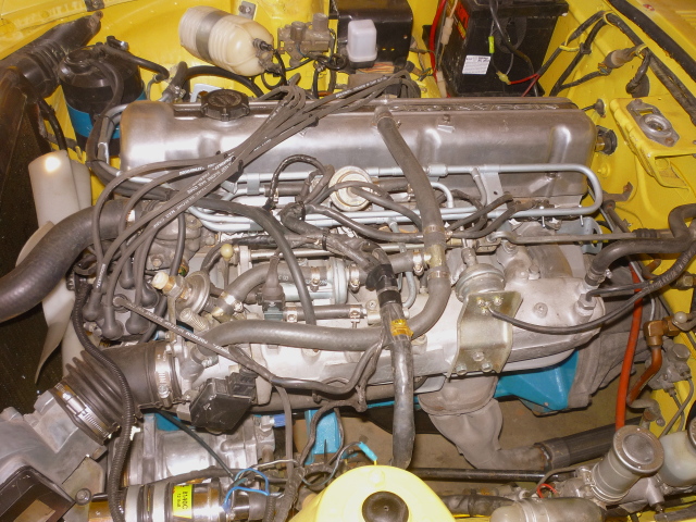

Zed, I'll post a pic of my intake later today, I tried to copy the pic from my FSM, but couldn't get a decent copy to post, I'll see what I can do later, because it is curious to have different diagrams from the same year FSM, curiouser and curiouser. I wonder of if a CA car has the heater and Fed models don't? I know the CA model had an EGR and the Fed model didn't.
Zed, here are a couple of pics, one of the engine bay and one of the AAR, hope this helps with the quandary. No heater lines to the AAR. The engine bay pic is probably not real informative, sorry.

I'm going to guess that somebody removed yours. The block would be mounted using those two bolt holes, but with longer bolts. A sandwich. To remove it you'd just use shorter bolts. The block is ugly and a real pain to get the coolant lines connected, and is a potential leak source. Not a big deal if the power to the internal heater still works. It does take about 40 seconds or more to fully close the valve using just electrical power though.
You can pinch either one of those hoses shut to see if it's the valve staying open that causes the high idle, as siteunseen suggested. If the hoses are old though, they might split. Then you'll get a really high idle that never drops.
