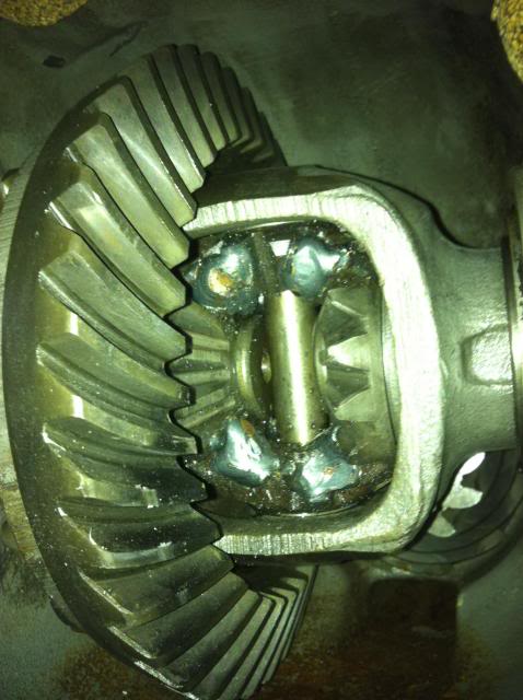

One of the guys restoring a 240K sedan has an example of a R180 welded.
Its in post 145 of this thread: http://www.classiczcars.com/forums/open-240k-discussion/44259-terrys-project-240k-2.html
IMG_2335.jpg Photo by terry_350 | Photobucket
Shows what Zed is refering to about welding a standard (spider gear) diff.

I wouldn't sugest doing it to a street car. I don't think Terry is that impressed with it either, but his car my have had a previous life as a "paddock basher".
That happens often in Australia. Farmers give their kids the old retired family car to dive around the farm and to give it better traction, they weld the diff.
Yep, been there, done that so to spreak.
Chas
