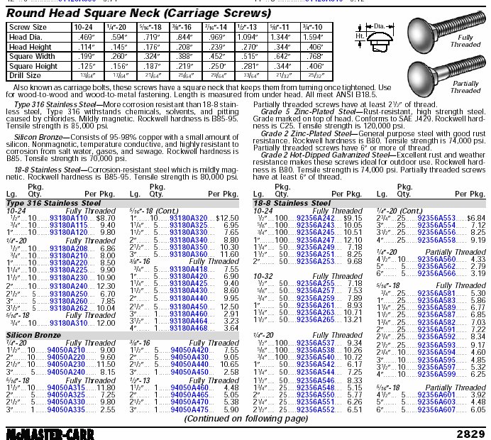

I'll comment on this, because I just went on a quest for chrome carriage bolts.
I wanted 1/4 and 5/16 chrome carriage bolts to replace the bolts that hold the end pieces of the rear bumper on and four 5/16 bolts to fill the holes from the overriders. You'd think that in a city like Los Angeles, this would not be hard to find. I went from Hardware store to another, Auto part stores, hot rod shops, even a Harley shop - no avail. I finally found them in the largest independent hardware store in town. For those in my area, It was Virgil's Hardware in Glendale.
