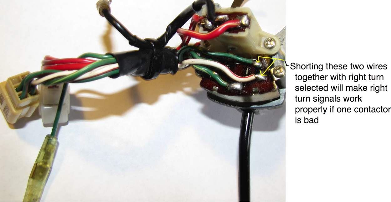

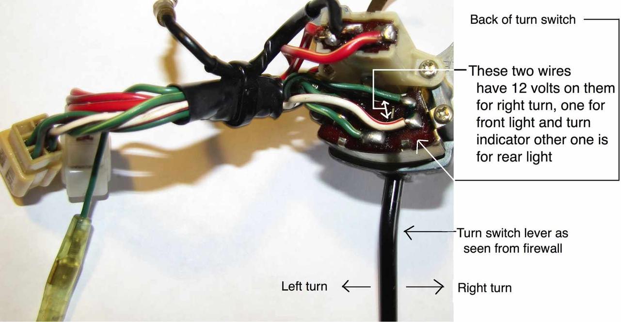

This may or may not help with checking the switch. The picture immediately below is the backside of a turn signal switch, probably from a 1/1970 car. The wire colors may vary. Click to make readable.
The picture below shows six contactors on the inside of the turn signal switch, three on the left and three on the right. The two contactors for right turn are the two lower right ones. One of the contactors feeds the front right light and the right turn indicator and the other contactor goes to the rear light. I don't know which ones does which.
Click for animation.

Mike shows exactly the problem I had with my Z. A quick way to isolate the switch is to turn on the 4 way hazard flasher. The hazard flasher does not use this particular set of contacts.
One point of caution, if it does prove to be the turn signal switch, the metal tabs that hold the switch together will work harden and break off if flexed too many times. Also, when putting the switch back together, keeping the little ball bearing in position can be problematic. I use a tiny dab of Vaseline to hold it in position.

What if the two wires on the turn switch for a right turn that go to the front light, the turn indicator and the rear light were temporarily shorted at the turn switch with a flat blade screwdriver with the ignition on and right turn selected while an assistant watched the front right light (and others) to see if all of the lights are now properly indicating a right turn. If all three of the right turn lights now work (including the indicator light) wouldn't it mean one of the contactors is bad on the switch. Is that Correct? Leaving the wires shorted would be bad as it would cause extra current to flow through the remaining good turn switch contactor.
