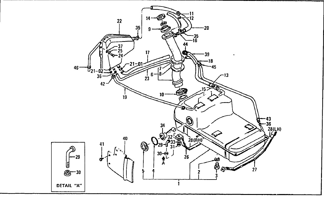

how hard is it to remove the gas tank?
Not terribly. Disconnect all the hoses without taking a gasoline shower, undo a bolt on each of the two straps, and out she comes.
Here's a picture of where all the vapor recovery lines go. The fuel filler neck can be accessed through a little panel that unscrews in the rear right fender (item 40 in the image), and some of the upper hoses can be more easily reached after undoing the straps and letting it drop a few inches. Try not to ruin your fuel filler neck, they're made of unobtanium the last time I checked; a little wd40 as a rubber conditioner goes a long way towards making old plasticized rubber flexible enough to handle.
There's a drain plug on the bottom if you can get it out.
Edit: Don't forget to unhook the wires from your fuel tank level sender! They have weird little slide on connectors.
