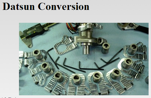

That mount or adapter is the piece that 123 USA (probably ED0 had designed and manufactured to make the 123 distributor a bolt-in piece. Prior to that, not too long ago, they suggested that people build their own.
Ed probably got a minus tolerance, or worn, shaft to use for his dimensioning and they made a bunch of minus tolerance pieces.

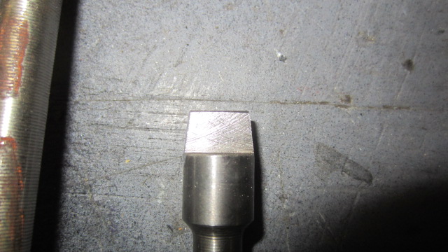

Here is the picture of what I had to do the tang. I'm pretty sure t'is more of a taper than I needed to create.

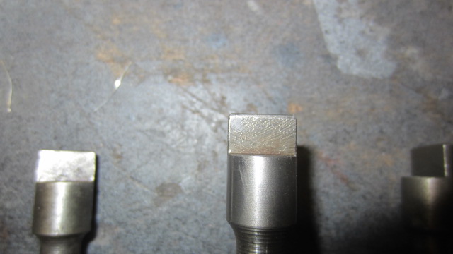

This is the best spindle I have for comparison (center). Note how straight the sides are.
The one on the left has a badly worn left side taper. I just about went all the way in with no pressure. The straight sided one would not engage the slot AT ALL.

It was almost imperceptible until I took the calipers to it. Jim nailed it. 0.018 difference from top to bottom. Easiest fix for now is slight taper of 0.010 per side. To put it in perspective that is about the thickness of a business card. Thanks Jim
