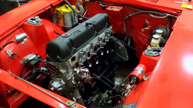

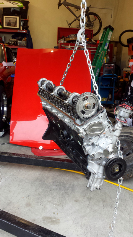

Picked up the engine from work yesterday afternoon and had a couple of hours to get it home and in the car. Will try to get the manifolds and carbs, belt driven equipment, rad, etc. back in tonight when I'm home from work.
Lots of silicone to scrape off the gasket surfaces and had to rob all the studs off my old engine. No idea why someone removed them from the Rebello engine. Flywheel fit well, but the dowels on the fidenza were kind of weird. I ground the bases down leaving a burr and tapped them in with some locktite... The crank still had a brass bushing in it so I just retained that and assembled the clutch. I hope the new parts work properly with the release bearing I have. Will do some trials on jack stands once the drive shaft is in and hopefully go for a stroll this evening before it dips to -20 C this week...
Noticed right away the head ports have been polished a bit, not sure if this was robbed from another car and its a free value-added bonus or if it was part of the actual build.

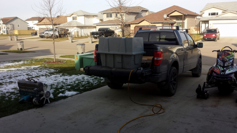

Nice, congrats.  By the way:  What is the that white stuff on the ground next to your truck in the driveway?
Thanks, but I don't really consider this any sort of accomplishment at this point. The white stuff is the reason I ordered this engine over 6 months ago, only, to avoid it, not drive in it. Thankfully that's all that's left of it right now, so I have a couple of days to try and get the tires turning before it's parked for another 8 months.
