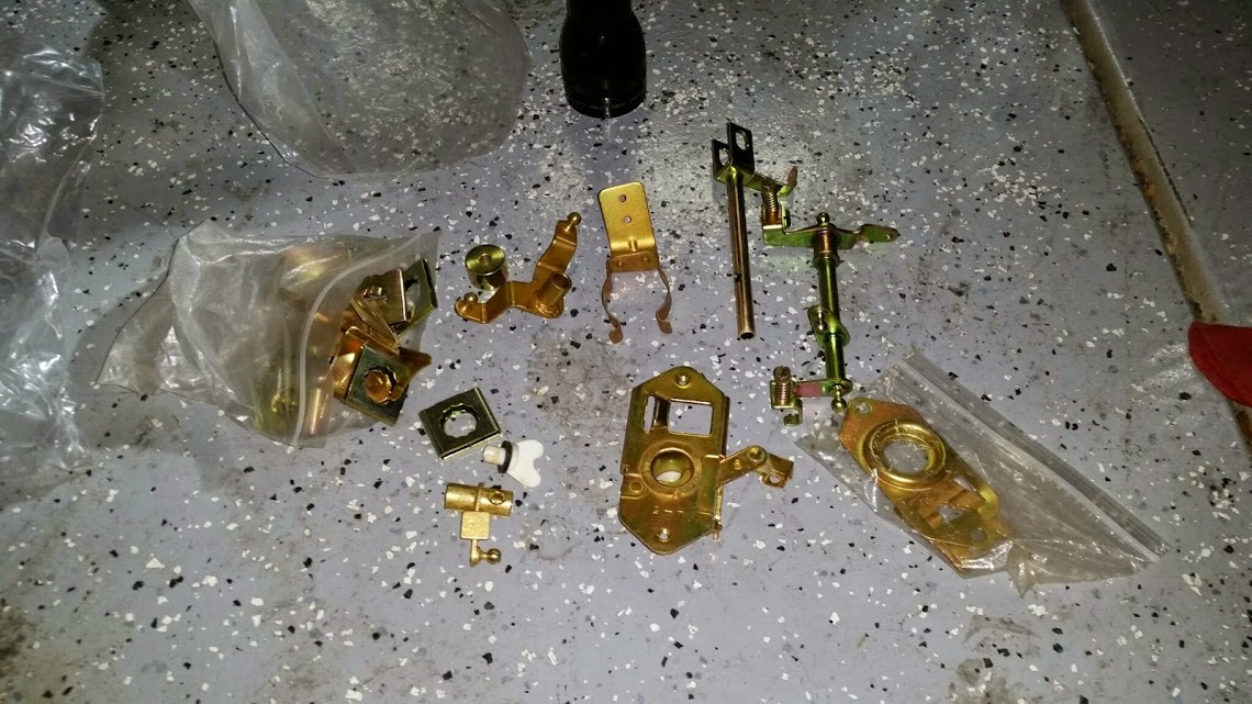

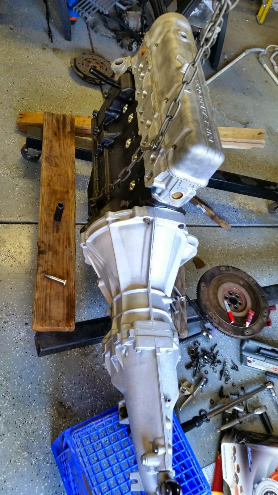

And here is a sample of some of the shiny bits getting installed with it.  I also cleaned and re-wrapped the entire wire harness in the engine bay and then replaced almost all of the fasteners with stainless (and Never-Seez)
