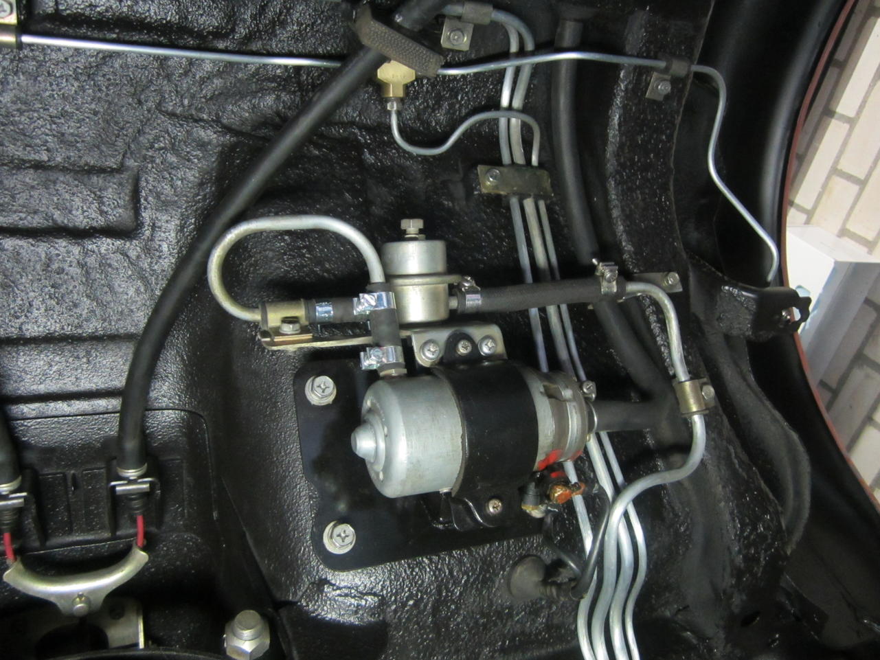

In fact, that one pic you just posted above with the fuel pump mounted in place under the car answered a few other questions for me... My previous owner replaced all the hardlines (brake, fuel) going from the front to back of the car. And I've had suspicion that not all of the routing of what he did was the same way it came originally.
Your photo confirmed that. He used some poetic liscence in the routing. I don't think it's a big enough deal for me to take them out and start over, but at least now I have a pic of how they're supposed to route. Thanks again!
