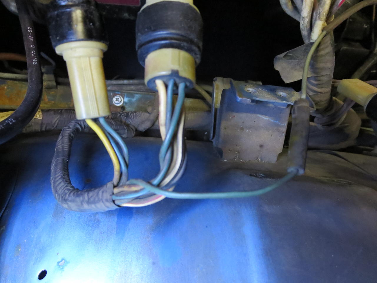

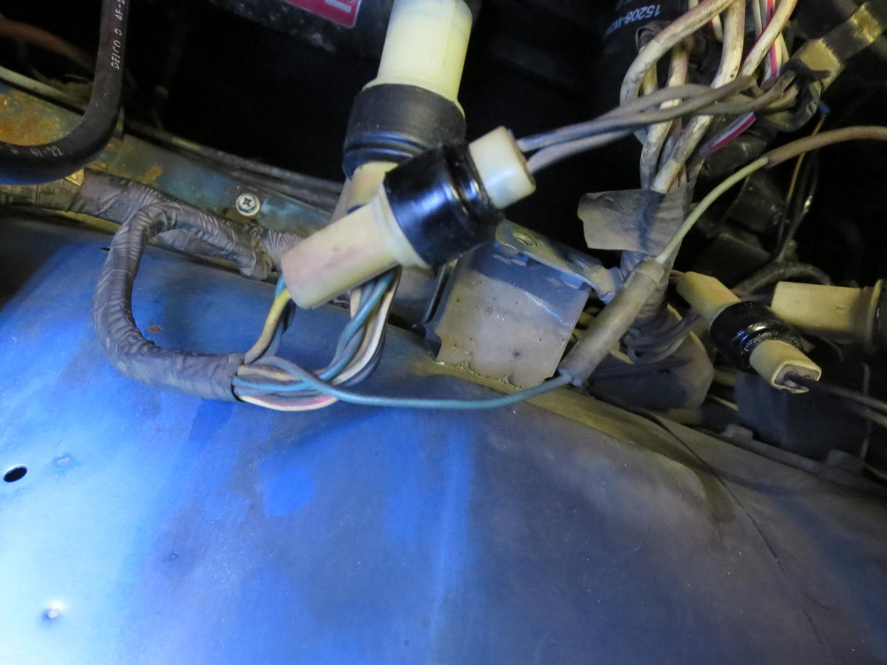

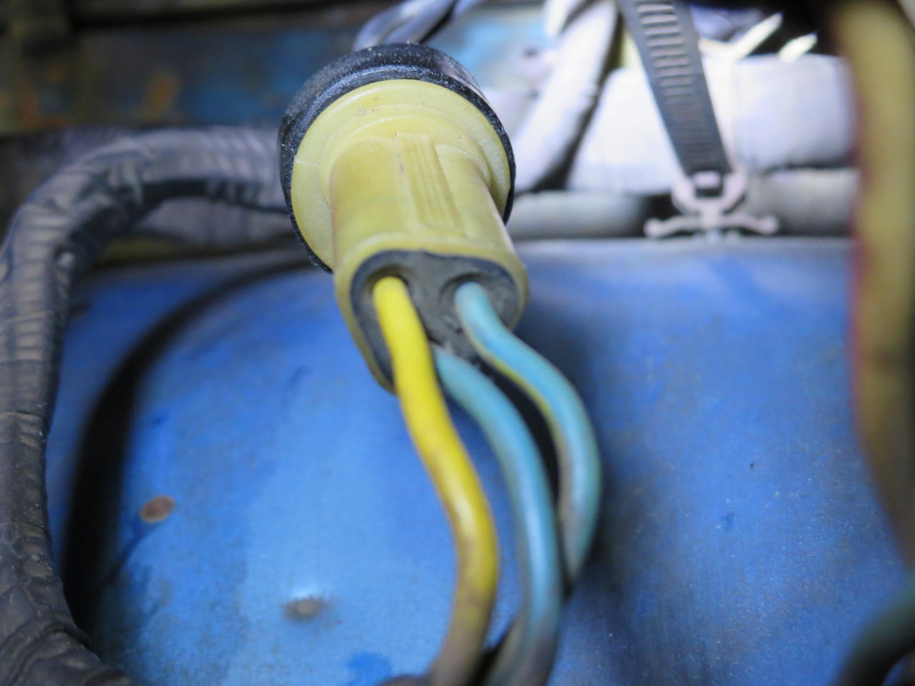

Maybe Im not looking at it right, but are you splicing wires with AC relay connector? Thats the small three wire connector with 1 blue, 1 Blue with white stripe and one yellow wire. Your AC relay has one wire going into it. Maybe just something with the models 75 versus 78.

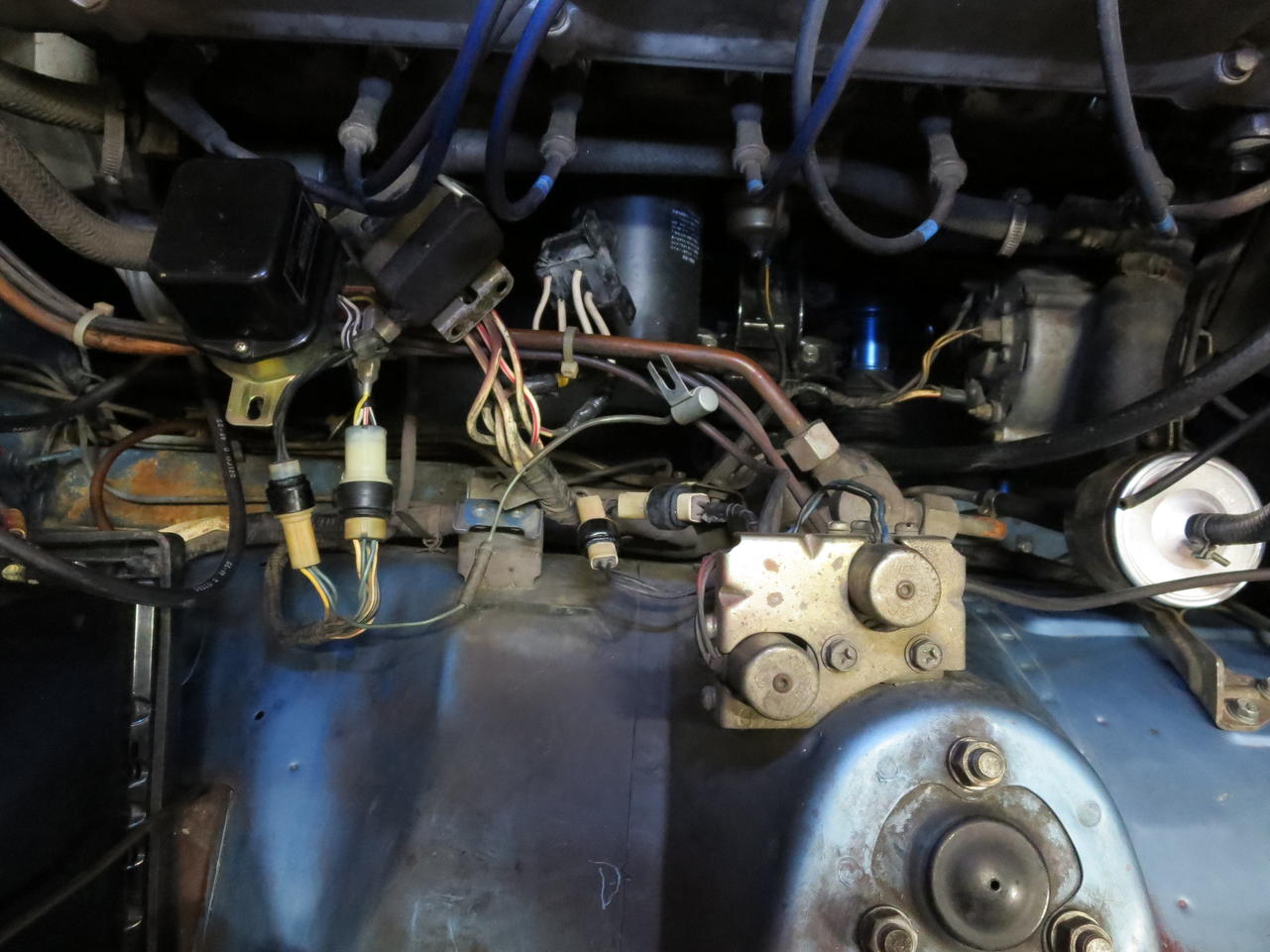

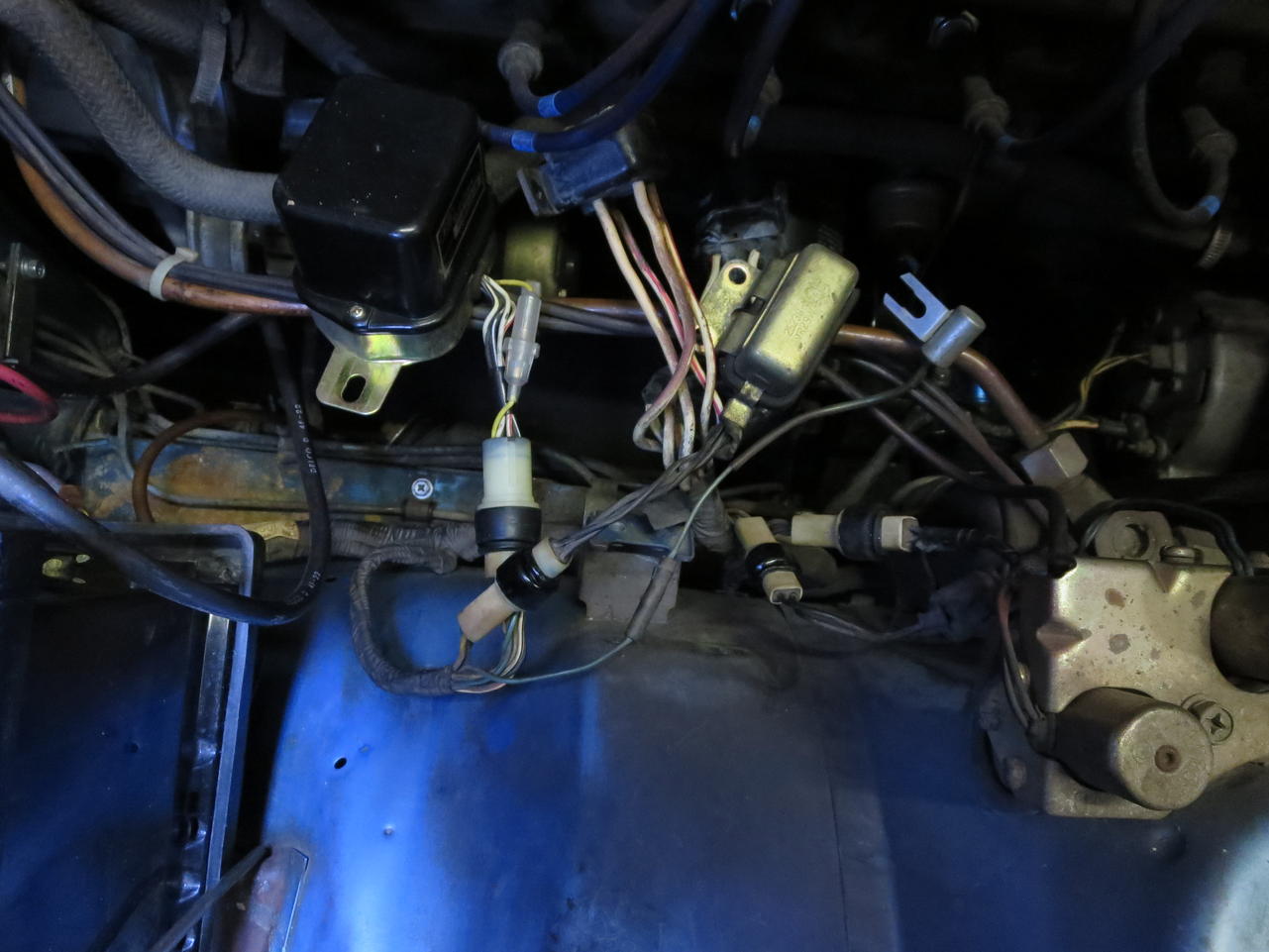

Im cleaning all my connectors in the engine bay at the moment, new self made rubber cups etc and now Im buzy with those exact parts. Here are some photo's of the system in my 280Z 77 model, all be it some what disnmantled atm.
The big black box (left in photo 1087) is the voltage regulator. The AC compressor relay is the yellow zinc coloured relay to the right.
Im probably not helping, but just interested in the differences between the two models.

You are correct, eurodat. I'm not splicing it, I just panicked when I couldn't find the green-red and I unplugged those to try it out and now I dont remember the order:disappoin:disappoin

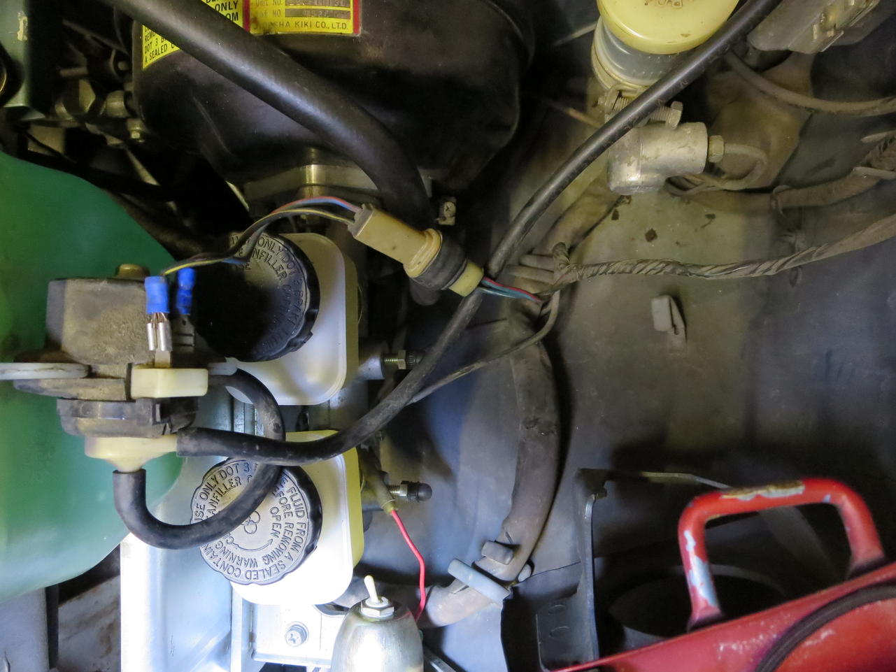

Tried this morning to look for more connectors. Only found 1 4pin that was going to the fuel fume thing(last photo). Hopefully help you guys see what I'm seeing.

Driver's side wires. Hanging green wire
[ATTACH=CONFIG]70169[/ATTACH]
Driver's side connector that isn't plugging into anything. Black/white and green/red (could this be it?!?! why is it hanging over here...)
The connector on the drivers side is for the washer bottle pump. I also took a photo of the back side of the AC relay connector. The blue/white strip is next to the yellow and blue in underneath. Might help you with locating the wires and refitting them.
Unfortunatly our models are a couple of years apart and they differ too much for me to help. Im afraid you will have to study the wiring diagragm and trace it step by step.
