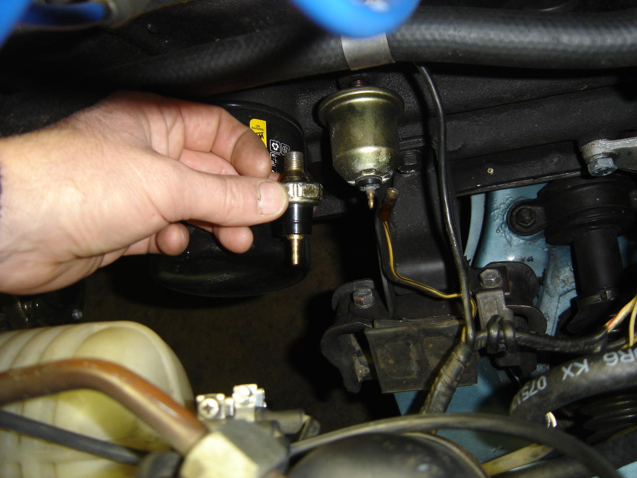

Does your '75 have the smaller one or the bigger one that looks like a fuel filter? My late '77 has the bigger one and it reads strong pressure even at idle although it gets lower when the oil is hot at idle. But at 3k RPM it reads 3/4's of the gauge.
1977 NISSAN 280Z Oil Pressure Sender / Switch
https://www.classiczcars.com/topic/48745-oil-pressure/#findComment-443226
Site, its the smaller one with a single electrical connection.
