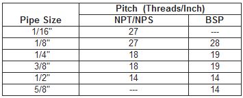

Every pipe fitting on an early Z is British thread.
The reason for confusion is that at and above 1/2" they have the same thread pitch, just slightly different profile threads, so they'll screw together and even seal (I wouldn't trust high pressure systems, but nothing in our cooling and oiling systems can really be considered "high pressure" in industrial terms).
HOWEVER: below 1/2" the thread pitches do not match up, trying to put a 18 tpi fitting into a 19 tpi hole is a recipe for a bad day.
