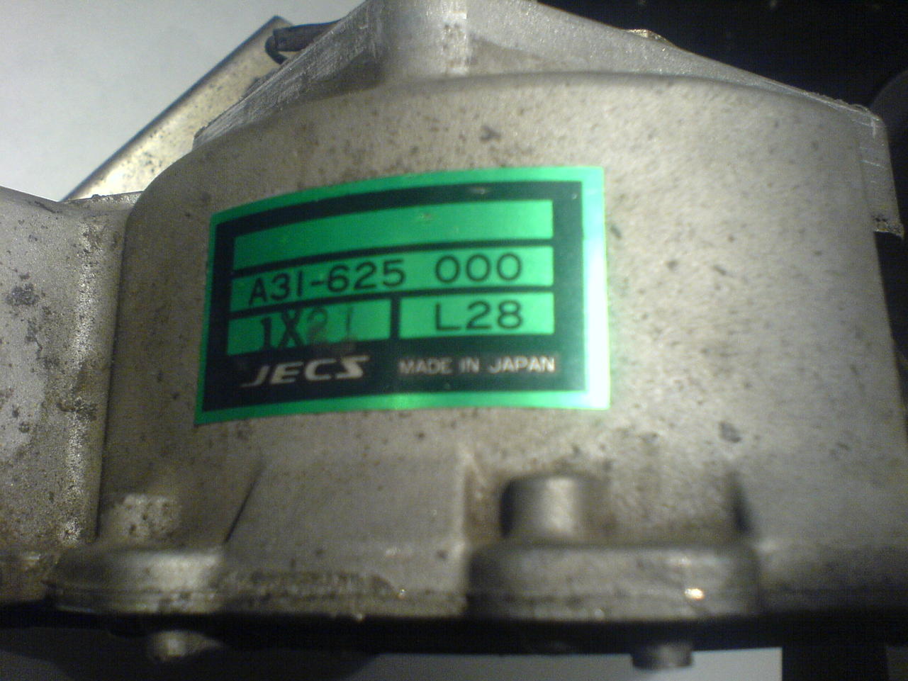

Here are some picture I have taken. I decided to bypass the turbo and run it as if it was a NA. It will rev above 3k but when the car is pulling itself down the road and you actually put the engine under torque it kills itself off at about 2500-3000 rpm. I'm wondering if my fuel pump is not sufficient enough for the injectors above that.
I'm going to try to attach those pictures:
That's a turbo AFM. Here's a link showing the part number - Motorsport! Air Flow Meter, 81-83 280ZX Turbo - The Z Store! Nissan-Datsun 240Z-260Z-280Z-280ZX-300ZX(Z31/Z32)-350Z-370Z Parts
I don't know that it will work right with the NA ECU. Nissan changed the way the AFM's are wired with the ZX's. Look in the Engine Fuel chapters of a 280Z FSM vs. a 280ZX FSM and you'll see (1976 versus 1982 for example). The NA AFM uses 4 wires for the potentiometer, the ZX only has 3. But the 4th wire might just be the altitude switch circuit in the NA system (discussed in other threads). Anyway, it's unclear that the turbo AFM will work right for you. You might want to get an NA AFM.
Those injectors look like aftermarket. They have numbers on them that will tell you what they are. Probably NA since I don't think the turbo injectors are available aftermarket.
IMHO Since your setup is a mixed up combination of turbo and non turbo equipment, I would go back to NA. Its the most logical IMO.

So now I am trying to find the correct AFM for my ECU and I think its the A31-060 001 that goes with my ECU which is A11-600 000. Am I correct to believe this? and where would be a good place to come across a re-manufactured one without sending in the core because obviously I don't have one.
Thanks guys you've been alot of help
That AFM and ECU is a matched set, they're designed to work together.

Im using a A31-626-000 on a NA unit. The AFM you have should work alright.
