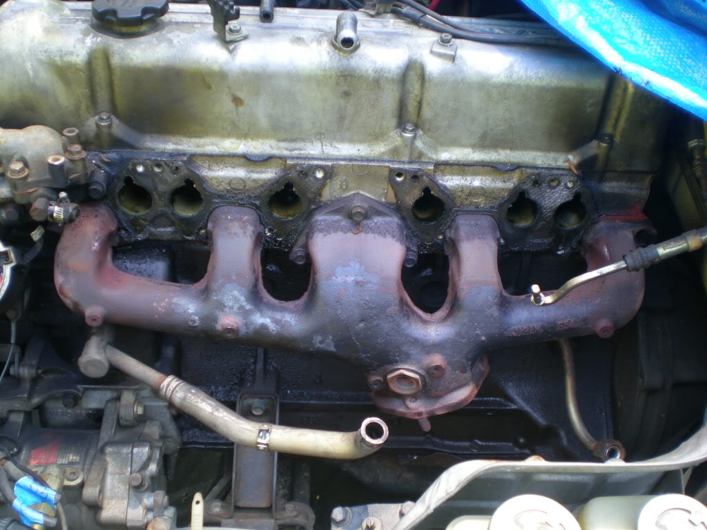

the 280z exhaust manifold looks quite a bit more meaty than the zx manifold.
perhaps a zx manifold would help the heat soak problem. does anyone in a 280z run
a zx exhaust manifold?

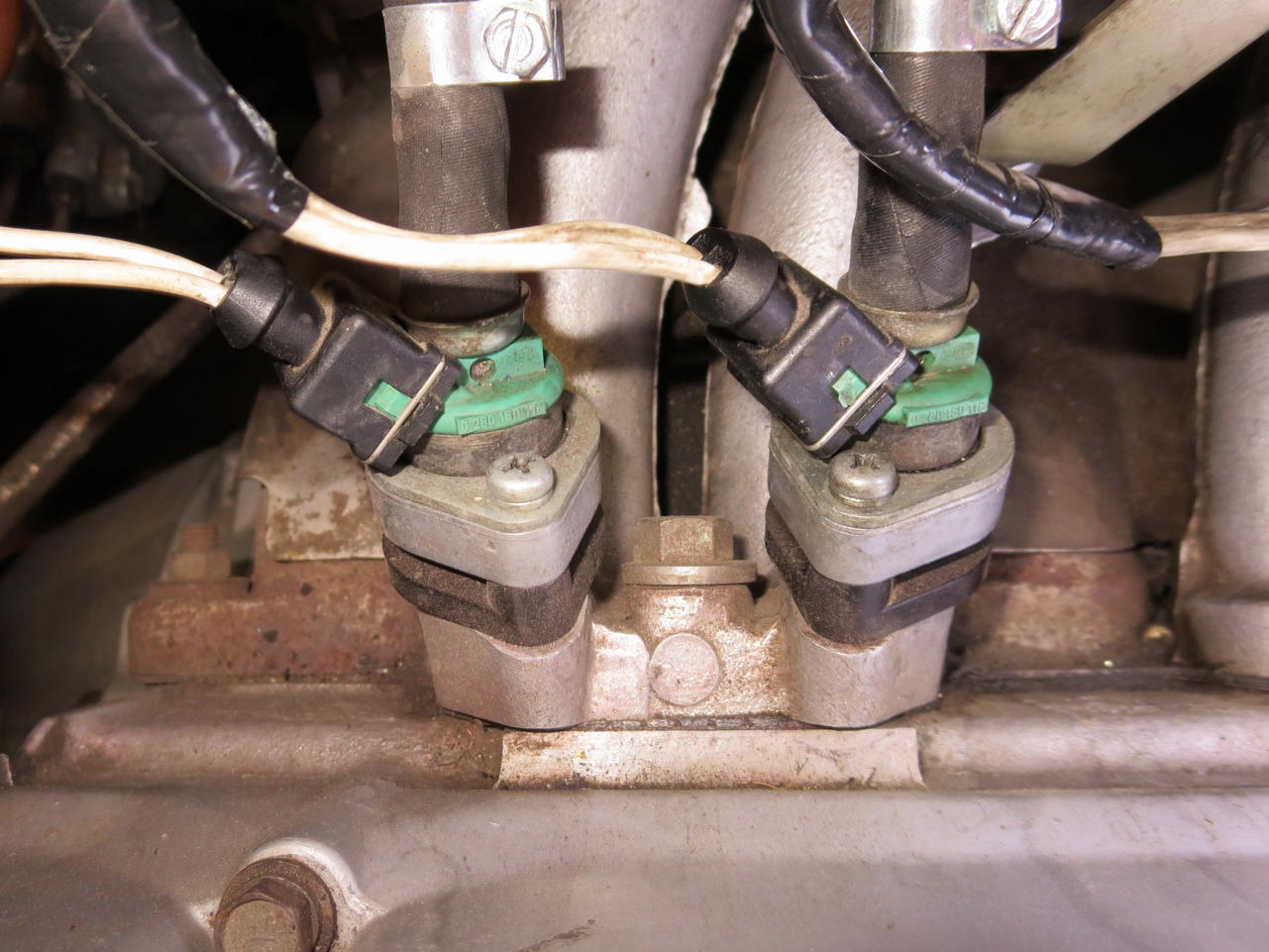

i've included some pics of the engine bay and one of the injectors - maybe you all can tell if they are original and if they are the "plastic insulator" kind (looks plastic to me)post-30163-14150828191448_thumb.jpg

The injectors don't look like OEM to me. OEM were green (JECS) and white (DKC).
Chas
If you blow up the injector picture you'll see the typical A46(I think) - 00000 number of the stock Nippon Denso or Denso injectors. They look like they were probably green when new. Pretty dirty now.
Those are the older style two part insulators, with the aluminum upper half. Hard to tell if they are better or worse for heat absorption. There's an air gap in the middle which might let them transfer heat faster, but the metal piece might hold more heat. Nissan might have changed just because it's cheaper to make a one piece plastic insulator than a two-piece.

To hr369 - I picked up a ZX manifold, more just to have a complete ZX engine package than for the heat-soak problem, but have realized that you need a longer head pipe to fit the shorter manifold. You'd have to do some exhaust work, it won't swap straight in.

i've included some pics of the engine bay and one of the injectors - maybe you all can tell if they are original and if they are the "plastic insulator" kind (looks plastic to me)[ATTACH=CONFIG]70739[/ATTACH]
Hello, It looks like the injectors in your pic are the OEM. The aluminum ring is actually clamps the injector into the manifold. BUT the aluminum transfers the heat more effectively to the metal injector body. Sarah(Fastwoman) had pointed this out earlier in the thread. Since I had to replace a dead injector anyway, I bought new Injector o-ring seals AND the plastic Fuel Injector mounts from Advanced Auto Parts. Below are the part numbers/prices...

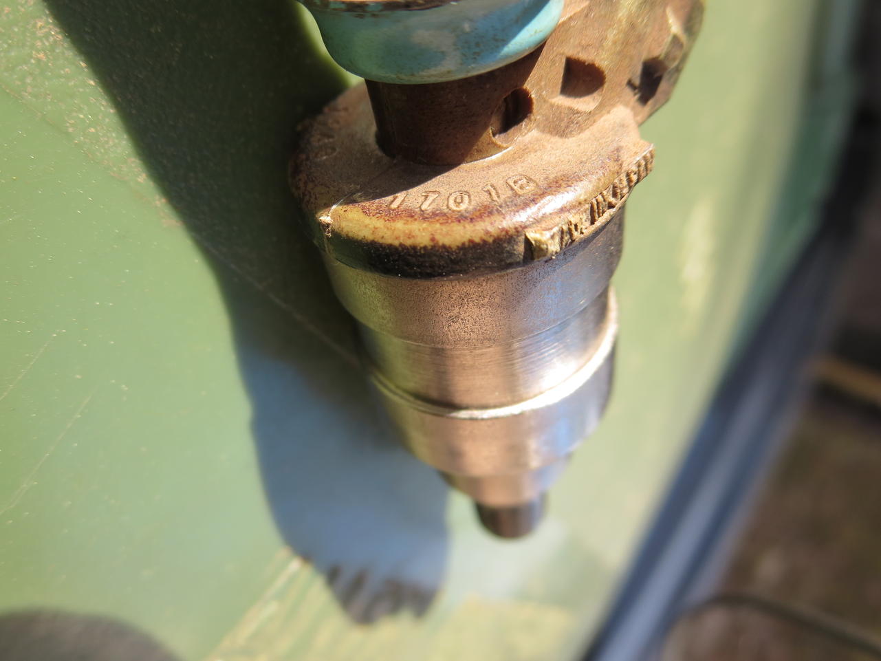

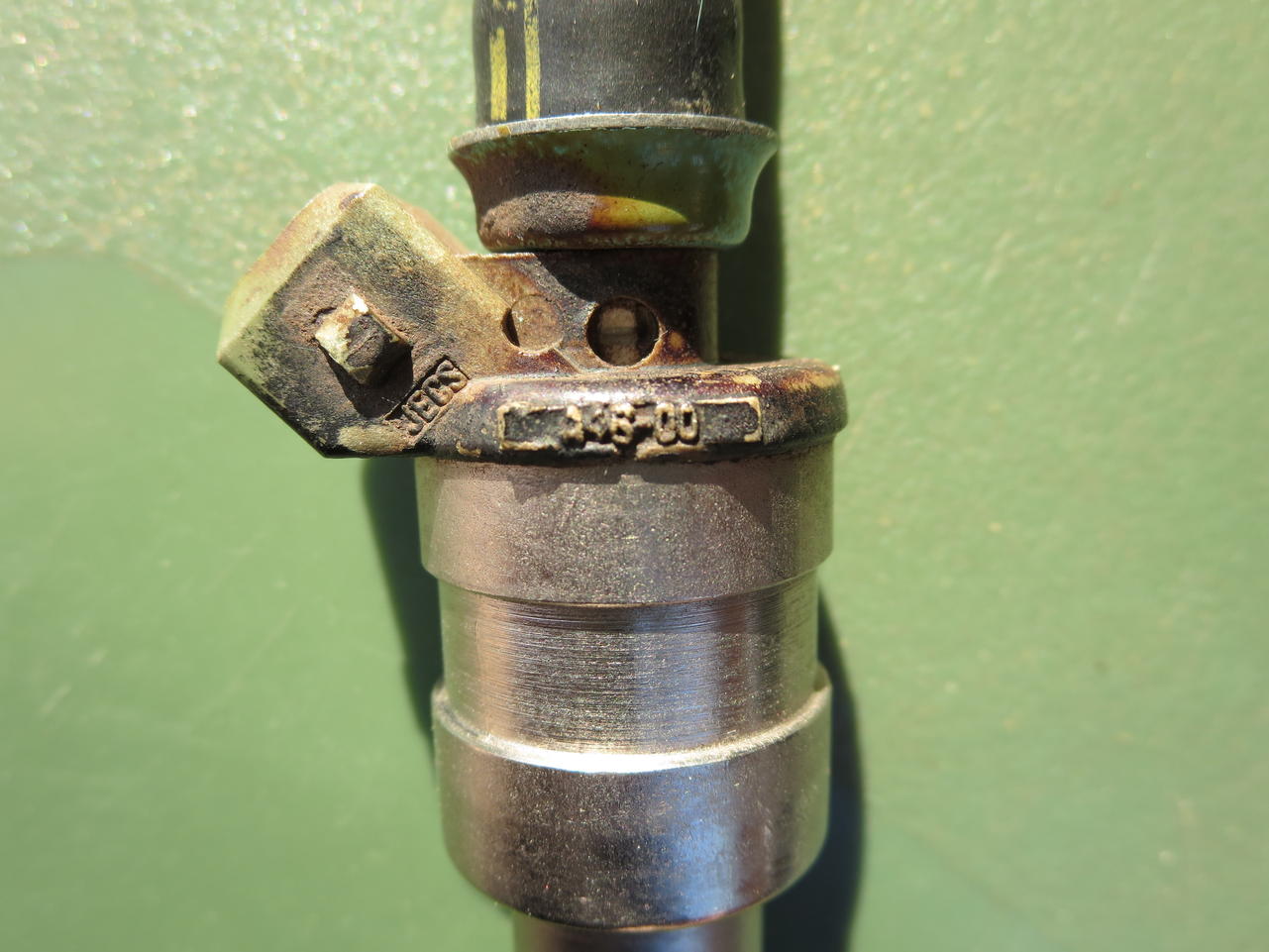

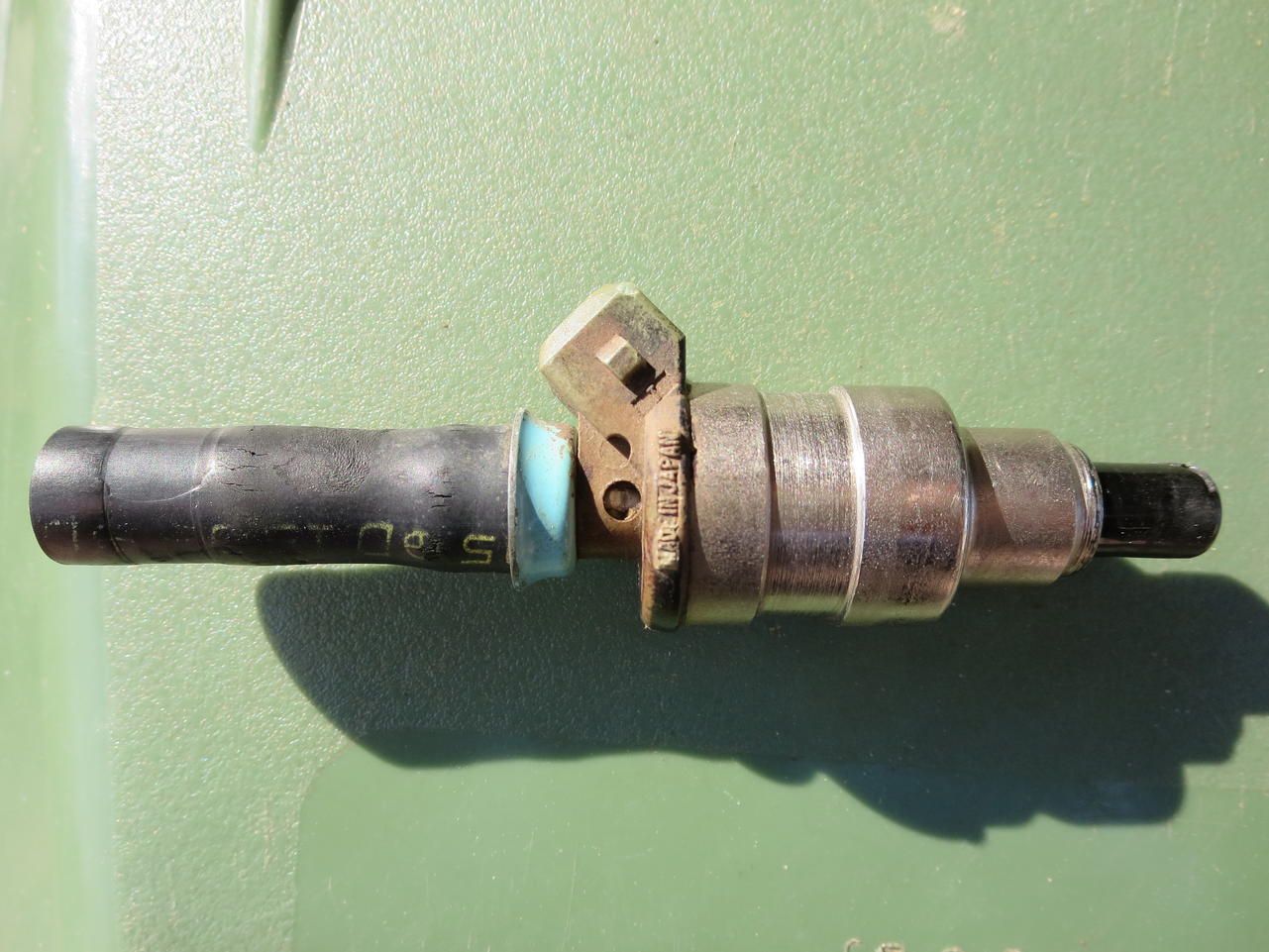

Here are some photo's of my injectors in the car and an old set on the bench. The ones in the car now are remanufactured and could be from a ZX.
The originals were JECS Made in japan. The text on the back "1148" and "1701B". Its not on the set in the car. The set in the car have "086" and "0 280 150 116".
I think they might be production numbers.
Chas
