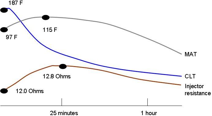

megasquirt owners also deal with heat soak. someone suggested that the heat affects the copper windings inside the injector and reduces its pulse.
for megasquirt owners there are no options? they do have MAT air density correction but it doesn't seem to help the
problem much. would increasing pulse width during hot startups help solve the problem?
will len's hellfire be able to compensate using software?
M54 Megasquirt 3: Fuel Injector Heat soak

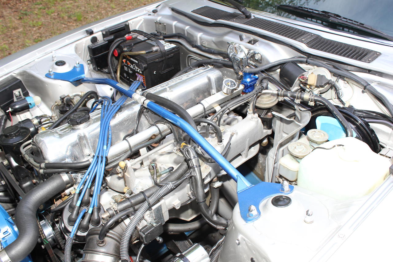

I've owned ZX's since 1979. I've never experienced the problem described. I live in Georgia where 100+ days are common.
Mine: 1979 280ZX 2+2 bone stock
1979 280ZXR with mega-squirt, header, cold air intake, 60mm TB, JSK fuel rail, electric fans

These last few posts are interesting (although painful to read in rossiz's case). ZXR616 has a header, as does siteunseen, the only two cases of "no problem" so far. ZXR616's case is a little bit confounded by the fans, but they probably don't run when the car is parked (do they?).
