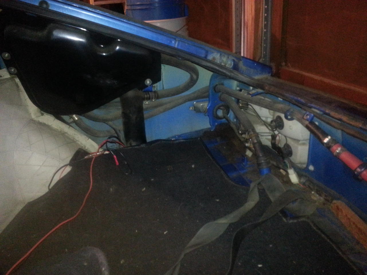

I was disassembling my tail lights in order to re-finish the trims and exterior finisher panels when I saw 2 hoses near the passenger side tail-light, inside the car.
One hose was crudely cut and a piece inserted to patch it back together. This patch came apart and I'm now realizing that this may have been a contributor to the raw fuel smell inside the cabin. The hose definitely smells of fuel and was basically wide open.

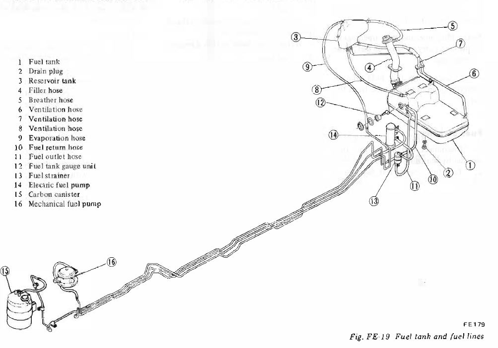

I looked all through the manual but didn't find reference to it. This is a 1974 260Z. Can someone post a photo or maybe link to a diagram of how these hoses should look, and what function they serve?
Thanks a bunch
And a valuable lesson is learned: make sure your manual is physically complete before cursing at it for missing key information.
Thanks!! Looks like hoses 6 and 7 simply pass through the passenger compartment... I thought maybe they connected to something inside the car, because my hose has several inches missing and a poor connector was made to replace the section. Perhaps buying some new hose and re-routing via the exterior is an option. Will look into it further.

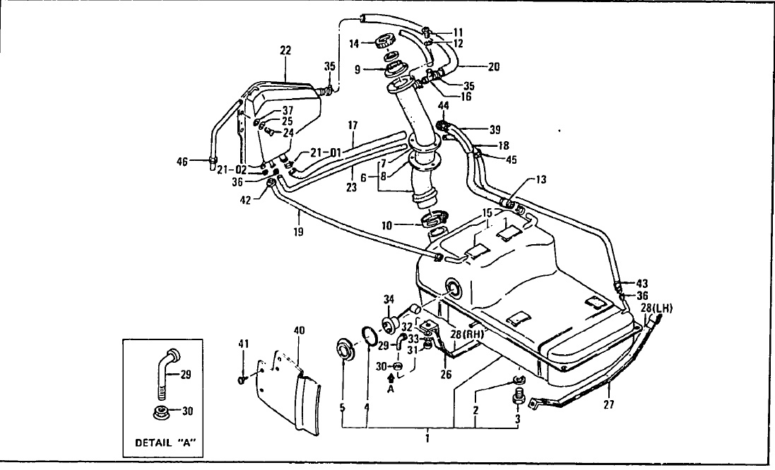

They do connect to something inside the car!
There is a vapor recovery tank up inside the passenger side sail panel above the gas filler cap (item 3), and a bunch of hoses all run to it.

Awesome! That looks a bit different than mine but it's probably close judging by diagrams.
Both my hoses are very close to eachother, roughly in the position of your blue hose. I don't have one that runs so far towards the drivers side.
Now that I see the vapor tank, I think I have to tear apart the interior and get a good look at it. I figured it was accessed from the wheel well or something, not from inside the car. There's no doubt my raw fuel smells are coming from that area, perhaps for more reasons than just the torn hose.
