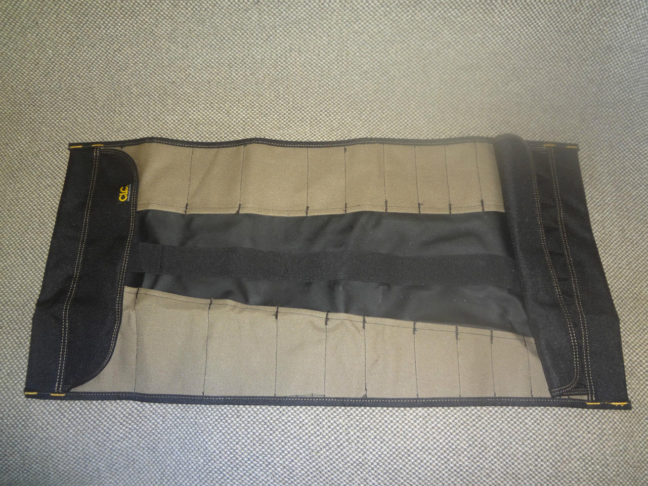

What about a deluxe tool roll? If you could fit the jack tools inside plus some spanners and tools, would that be even better?
Here is an example of a tool roll that may meet the needs.

The Datsun tool roll I referred to has narrow pockets down the sides for tools, and small pouches with Velcro flaps on the ends (for bulbs, sockets, nuts, and loose stuff.) I think it would make a great design for our cars, maybe with just one modification- one wide pocket for the jack crank handle.
The Datsun tool roll is neat and spiffy. It even has straps with squeeze buckles and a carry-handle. But at over $50, I don't think I will get one for a while.
We ought to work out our own design. If only we could only get somebody to make up one or two for "testing?" ;)

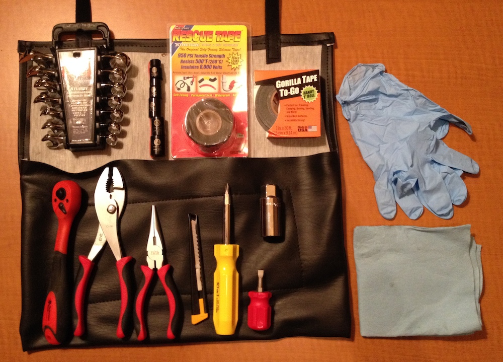

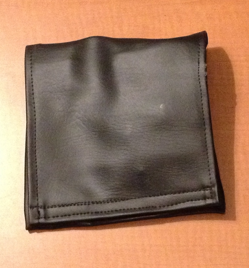

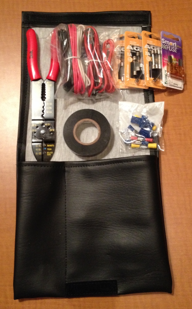

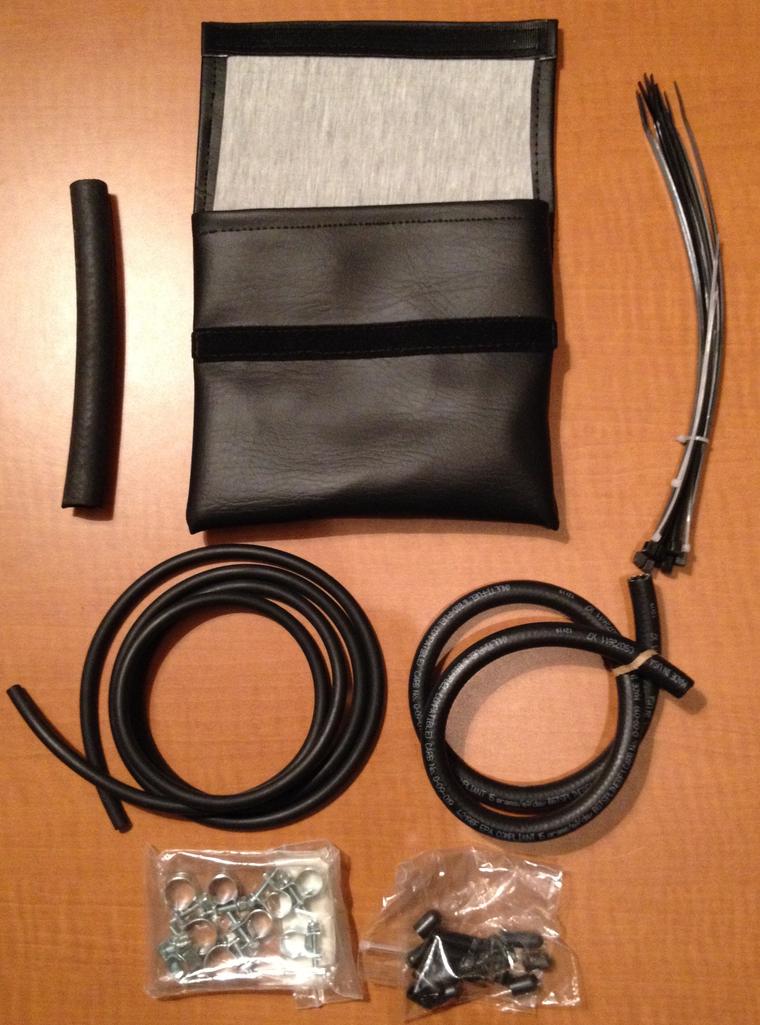

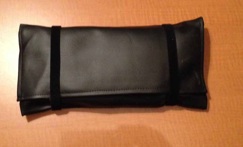

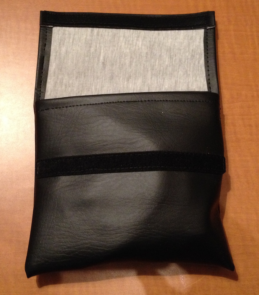

here are a few pics of the tool kits i put together to keep my z running. looking at it doesn't exactly give a feeling of confidence in the car... but i can't afford to be left stranded as this is my dd. i was looking for a decent tool pouch and couldn't find one that i liked, so i just sewed these up out of leftover vinyl with velcro closures - nothing special, but does the job. the tools are also not exactly "shop grade", as i don't plan to need to use them all that often (hopefully NEVER!).
as for the jack and tire tools, i keep the stock pouch in the spare tire recess. wrapping the jack in a towel, lie it on it's side and crank it open until it presses against the spare tire attachment post in the center - keeps it from rattling around back there.
list of components is as follows:
Electrical
    Multi-tool
    Various gauges of wire
    Crimp terminations & connectors
    Fuses
    Electrical tape
Fuel
    Fuel hose
    Vacuum hose (large & small)
    Vacuum plugs
    Clamps
    Zip ties
Mechanical
    Spanner set
    Ratchet & common sizes + plug socket
    Standard & needle nose pliers
    Razor knife
    Multi-head drivers (standard + stubby)
    Gorilla tape (must have)
    Silicone wrap (will fix a hose in a pinch)
    Gloves & paper towel

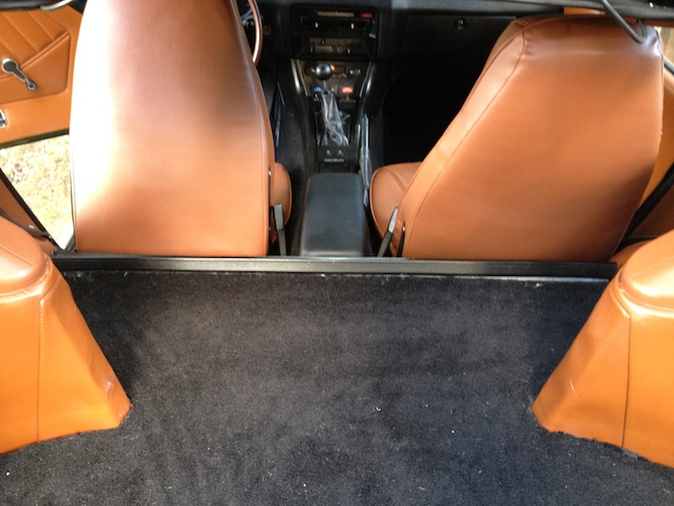

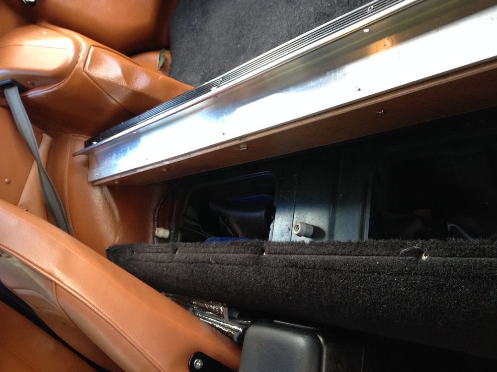

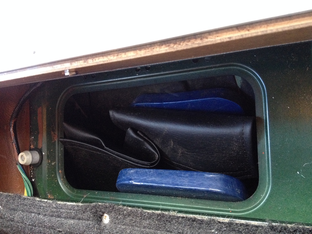

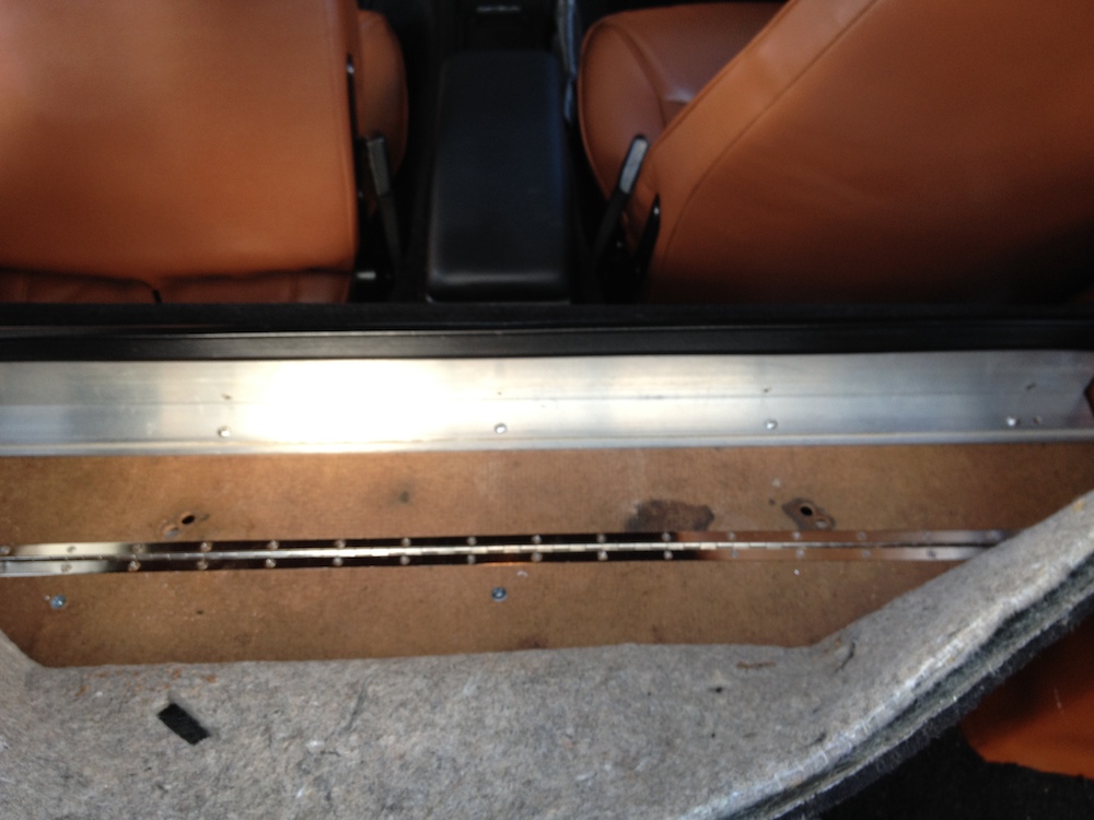

i ditched the spare and lowered the false floor a few inches to pick up some more cargo space - actually makes quite a difference, especially towards the rear where the stock space sort of zeros out in height. i pulled out all the spacer brackets and replaced them with pieces of 1" diameter pvc pipe cut to the new length spacer (around an inch or so, depending on the location). then i made a bumper out of a bolt & lock nut in the spare tire holder and capped it with a vinyl cap so the wood deck had a soft spot to land. the wood deck needed trimming as the shock towers get larger at the bottom and i made the two side pieces (either side of the lift-up panel) a bit larger - cut 'em from 1/4" masonite.
then i cut the forward end about 8" back and put in a piano hinge. this lets the front lift up, exposing the holes for tool bins on the 240 which the 280 back abandoned. i put together a pair of aluminum angle extrusions to get the front lip up to the top of the carpet behind the seats and mounted the stock luggage stop. when it's closed you can't tell it's even there, but it lifts right up for all my tools & goodies.
