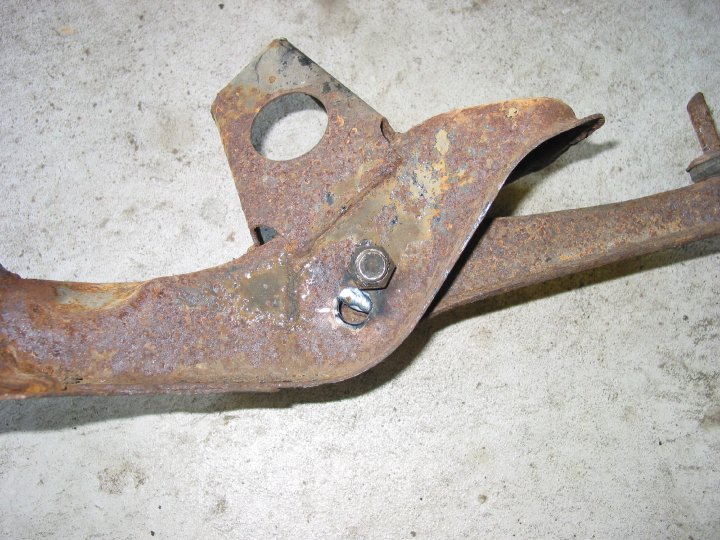

I dropped my '78 exactly 1" and the bump steer is pretty bad. When I built my '74 race car, I lowered it a bit over 1" and I moved the inner pivots on the crossmember to correct the bumpsteer. The '74 is great, while the '78 street car sucks. I plan to do the crossmember mod to my '78 as well. I haven't used the spacers.
It should be pretty easy to find through a search. The mod involves moving the front lower control arm pivot points up and sometimes out. Up will help the geometry for bump steer and out will add some camber. Most people move up 3/4". I also moved mine out 1/4" which is about the limit due to tie rod thread engagement. You will also need to grind the corner off the LCA's so they don't catch the crossmember after they are raised. Once you have the crossmember out, the mods take about an hour with the right tools. You have to knock the doubler washers off and then reattach them after you drill the new holes. I used an air chisel to remove the washers and the three spot welds popped right off. Once the new holes are drilled, the washers need to be tack welded back on. Otherwise, it just requires some measuring and a drill. I didn't have a welder at the time, so I took it to a coworker with a welder to have the washers tacked on.
Here is a pic of my mods. This is the only one I could find quickly, but at least it gives you an idea of the new hole location.
