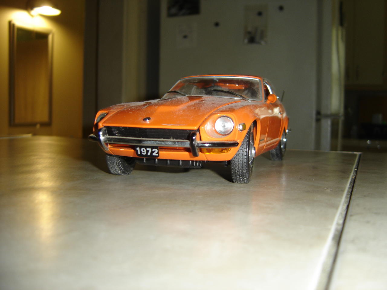

First i'll start out with it's story. It is a 1971 240z Automatic in Orange (918?). It is basically a one owner vehicle. Originally a California car, the original owner passed away, and it went over to his son in Seattle (about 1999) who stored it for many years. He then sold it to a family friend who also stored it for 6 (Never registered). It was driven a couple times a year in that period of time. First I was thrown off by the fact that it was an automatic, but I decided to check it out anyhow. I am amazed that everything is there from the original manual signed by the dealer, down to the spare tire with all hardware.
Obviously it's been sitting for many years, it's going to need some love before I can get it to pass a safety here in Canada, but as far as I can see the body is extremely clean. Rubber bit's aside, I think it's a great car. I'm not very educated on these vehicles yet, but I hope I found a good one. I'll post some pictures the previous owner sent me, as I will have to take my own once the vehicle is in my possession tomorrow. Maybe you guys can point me in the right direction as to what is stock, and what has been modified.
-It has been repainted. I read somewhere that the body on the old Datsun's were metallic, but the doors jams and engine bay were not. Now the body is a slightly different colour then the engine bay, I'm going to assume it's not the stock colour, but is close enough for me. I still question why the door jams were painted black though.
-The interior was restored at some point, and either recovered, or different seats used. Any ideas?
-Slot Mag wheels
-Aftermarket Tape player
I'm really undecided on what I want to do to this vehicle. A lot of purist's will say keep it stock, but with the aftermarket paint and interior I feel I can get a little more free on what I can do. I'd love to get a 5 speed in there one day, as I did my first auto x recently and had a blast. A few track days would be great too.
Anyhow, enjoy the pictures!

That's a great looking car, you're going to have some real fun with it. The paint code decal is still in place on the radiator bulkhead and the exterior looks like the engine bay, altho a lot more fresh on the outside. There are several threads here to bring a stored car back to life, I'm sure someone else will probably have the links at hand. Be patient and enjoy your new find. We'll be looking for your progress updates.

Welcome! Nice looking '71. Always good to see another '71 Z going back on the road. Looks like the painter took a few liberties with the paint scheme and door jambs. The panel around the tail lights should be grey (see other topics for Duplicolor match). The underside of the hood should be the same color as the rest of the car. Door jambs should be body color. Not sure what you mean by "the body on the old Datsun's were metallic, but the doors jams and engine bay were not.". If you're referring to the paint, no metallic paint on a '71 Z anywhere. If you mean the structure, everything on the body shell is metal.
Also, the upholstered door panels are not stock. Nice, but not stock. The transmission tunnel was originally vinyl covered, not carpeted. However, the car will be a ton of fun. Enjoy it and keep us posted on what you do with it.

Welcome & WOW! That's a great looking Z. IMO, If you're going to keep it, Make the swap & save everything that's removed. I don't think that an auto tranny is going to serve you very well on the track. Pull the auto while it's still in good shape & save it. I love the color of your Z. I don't remember any bright orange ones around Portland in the early seventies, That one is an eye catcher. Great find.
