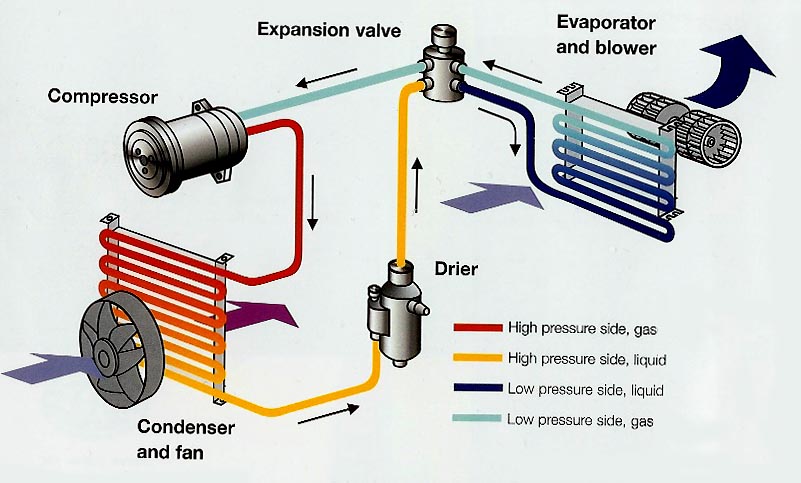

A typical AC conversion on any car involves a different radiator, fan shroud and sometimes a different fan. I have an early 260z which I believe has the same size radiator as your car and started moving a factory AC system over from a 280z. I didnt want to store the AC condensor and risk damage so i mounted it on the front of the car in the factory location. Even without the condenser being active and creating heat it was enough to cause overheating, so I can pretty much guarantee your car will overheat if you dont pay attention to the cooling system. I plan on using a larger high quality radiator and possibly switch out to electric fans, which I anticipate will require an alternator upgrade. Your parts list doesn't include a condenser which is absolutely required.
This is a pretty good overview on how AC works:
HowStuffWorks "How Automotive Air Conditioning Works"
and heres a nice graphic that also details where these parts go on the car:
