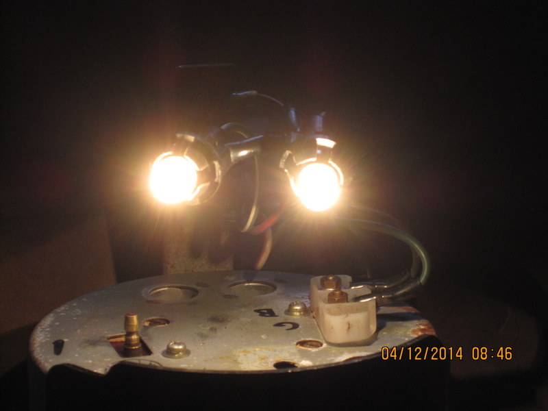

I went out and compared Eiko to MSA and took the attached picture. Maybe you didn't get a good ground when you re-installed the gauges. Do those bulbs ground through the sides or do they have a dedicated wire? (I'll probably check myself right after I post this).
They have their own wire. Weird that you get lower illumination. Maybe they popped out of their locations when you reinstalled the gauges. It's happened to me. Good luck.
Eiko A72 on the right, MSA on the left.
Edited by Zed Head
Zed Head, first thing I checked was to be sure the sockets were still in place and they are. Hmmm, maybe its my eyes but the bulb on the left (MSA) looks to be brighter in your pic.
Im also thinking that maybe its due to the height difference. The MSA bulbs protrude further into the gauge than the Eiko's because they are longer, if that makes any sense.
Could be height on the two combined gauges - fuel/volt meter and oil/temperature. I noticed that the slot for the light to escape is tiny at the base of the tube the bulb sits in. The light path on the speedo and tach is different. It would be where the filament sits I would guess, and the MSA's sits higher. Still seems odd that you would get a big difference.
In person, both of the lights looked the same. Bummer. Good luck.
