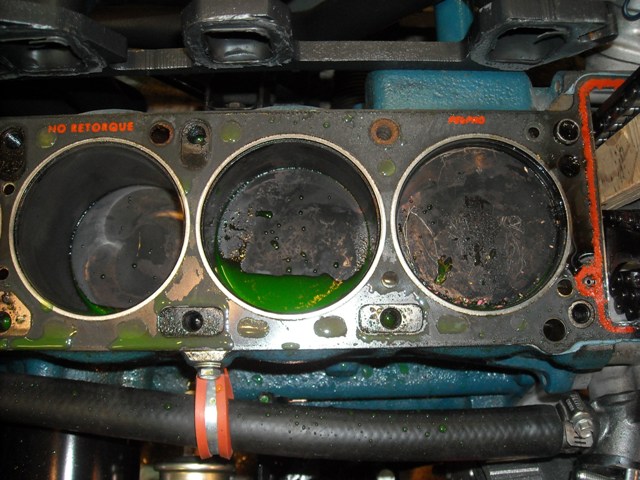

No problem, I inserted my swivel magnetic probe into the hole and started sweeping for the tip, that's when the magnet on the end came off the probe and stuck to the wall of the cylinder, lovely.

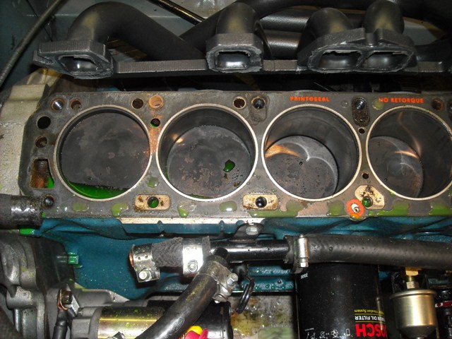

So now I'm pull the head off to retreave the dental pic tip and the magnet but I still can't bring the piston up to TDC because the magent is stopping the piston.

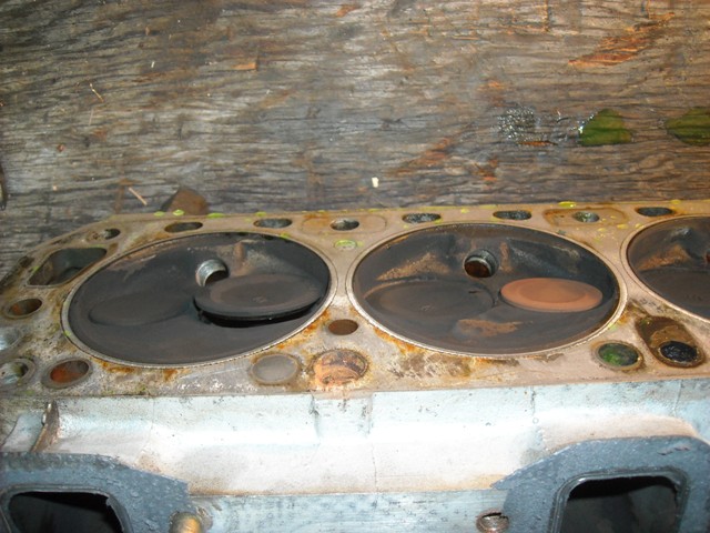

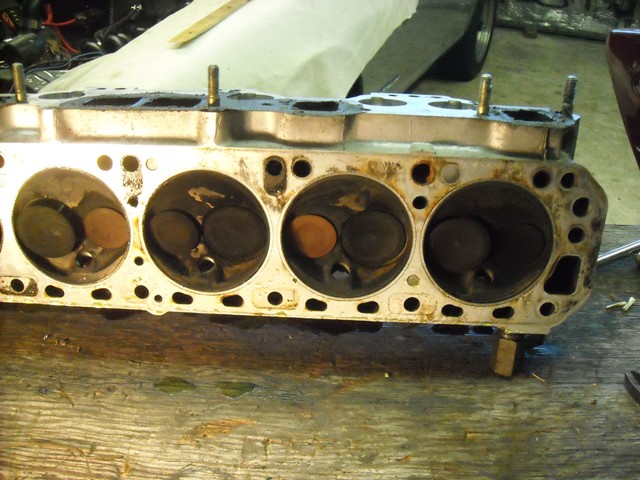

I mark the timing chain and cam sprocket so I can get them back together again and not screw up the timing. I installed the wooden wedge to hold the timing chain and pulled the head off, it doesn't look too bad for 15,000 miles,
But while the head was off I started thinking about the engine knock or ping that I have been chasing for the past 2 years. I've done the colder plugs, 94 octane gas, richer mixture but it is still there.

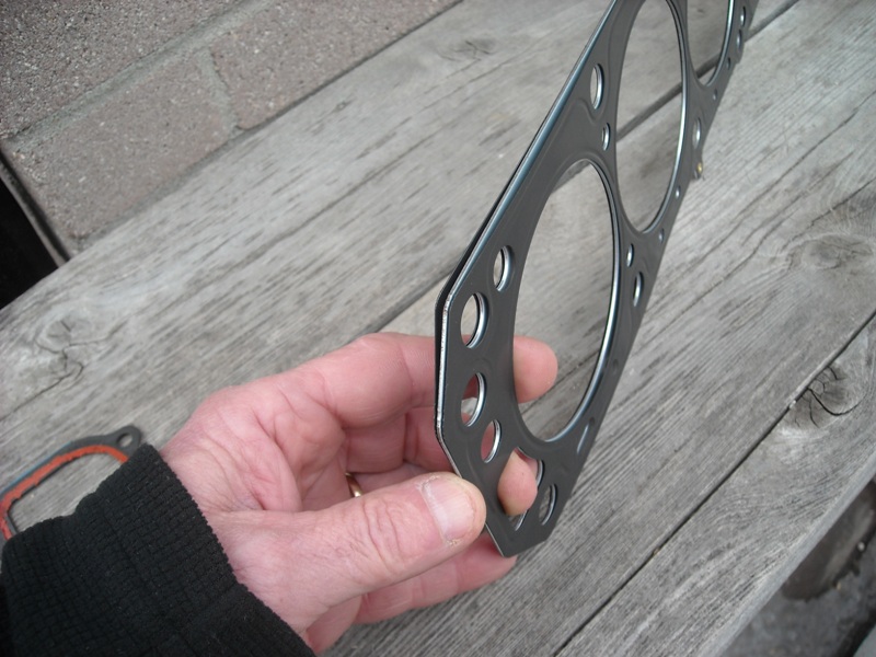

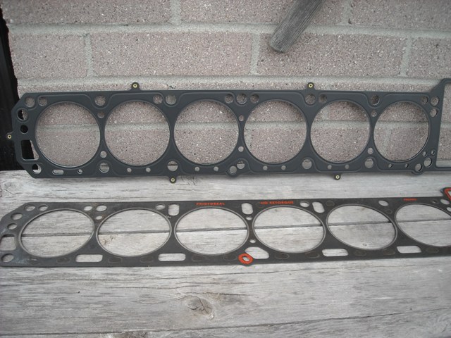

So I picked up a Kamarie 1.5mm solid head gasket to bring down the compression to 9.5:1,
At $400 I sure hope it is re-useable.

It was either the thicker head gasket or a longer duration cam and since I already had the head off it was a pretty easy to choose. At least now I'll be able use full mechanical advance 35-37* before it would start pinging at 28*
