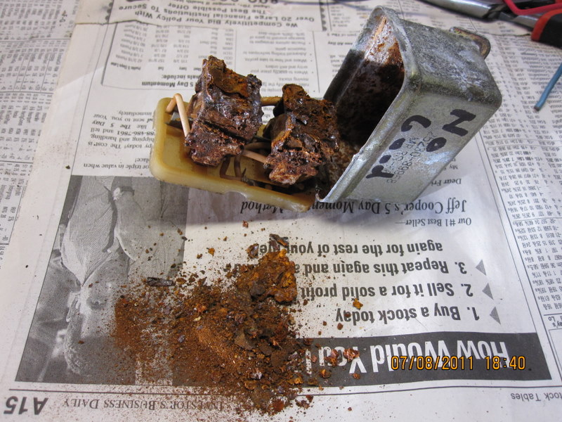

Wow, that's a NASTY carcass of a relay, Zed!
Rossiz, I'm glad you located the offending relay/connector. As far as crimping goes... well... I really, really hate crimped connections, especially in marine applications (we have boats on salt water). What I do is to crimp first and then sweeten the crimp with solder. You have to use the solder sparingly!
And yes, just a little wiggle or movement can indeed kill the engine if you've got bad connections. In the future, the best thing you can do when you have an intermittent problem is to go through your wiring, wiggling connections, BEFORE you do anything else. The reason is that you might make the problem go away when you wrestle with a part or connector here or there, and you might attribute the "fix" falsely to the part you replaced, when the real culprit is a bad connection waiting to strand you on the side of the freeway a couple of weeks later. As a rule of thumb, whenever I'm working on an electrical issue, I never replace parts in any area I haven't wiggled first.
Anyway, good job! :) (Don't forget to do the Snoopy dance around your car for good karma.)
Beware that outside of the relay may not represent the condition of the inside.
I don't know Zed... I don't see any misrepresentation there. That relay clearly says "No Good" on the outside of it. Truth in advertising! LOL
PS - Holy crap!!

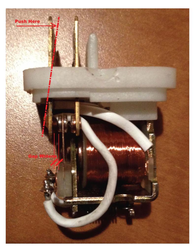

so what i discovered is a weakness in the relay design that actually can cause it to lose connection at the contacts if the spade is flexed at all. the spades are held in a plastic base, which is flexible. the other end of the spades (inside the box) are the stationary contacts - this is where the problem is.
the gap between the stationary contacts (spades) and the moving contacts (the ones pulled by the solenoid) is fairly precise, as the solenoid throw is quite short. if there is any sideways pressure on the spade, it pivots about the plastic base and the contact gap changes. with my relays, the moving contacts had such a close tolerance to the two static contacts that a fairly light push would open the gap enough to break the connection.
i figured this out by fiddling with the brand new relay with the cover off and the engine running - i was able to pinpoint the exact spade that flexed causing the engine to die.
since there are 6 fairly thick wires going to the plug, they are pretty stiff when bundled/taped together and if they aren't bent so the plug attaches to the relay straight on, there's some "spring back" to the wire bundle and in my case it was pulling just enough to cause the relay to be intermittent.
