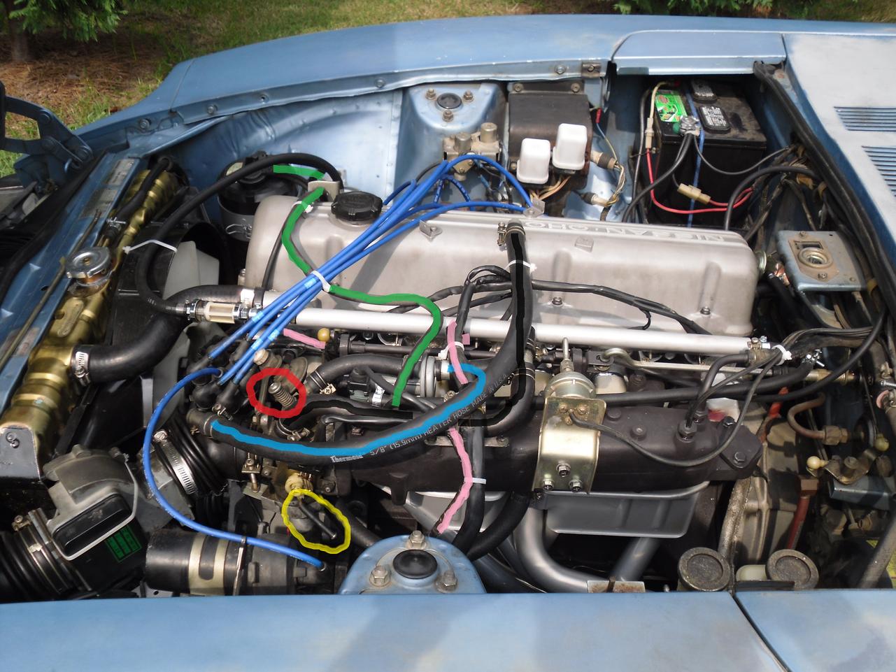

BCDD under the throttle body. Unplug and see if it quits. Small black wire off the BCDD butt connects into a small white wire going into the wiring harness.
B boost C controlled D deceleration D device
If you deleted the EGR and BPT there's a vacuum hose on the side of the BCDD that needs to be plugged with a small bolt, circled in yellow in the picture.

Do you have the round gold colored item above the red circle in siteunseen picture? If you do this could be your problem. It screws out and in to help the throttle return slower when shifting.
After I cleaned everything on the top of my engine, I had the same problem the rpm would not lower fast enough and that item was the problem, mine was too far down. I loosened the nut and screwed it out and that did the trick.

Glliw can you post a good picture of the top area of the engine?
I'll take one here in a bit.
It would help to tell us what car/engine/modifications you have. If you have a carb'd 260Z, there is a dash pot that prevents the throttle linkage from closing too quickly, say when blipping the throttle. If this is hanging up, it could cause your problem.
The car is in the first post. There isn't a mods list because there aren't any, except for the vaccum deletes whilst troubleshooting this unless you think the front air dam affected this. :)
