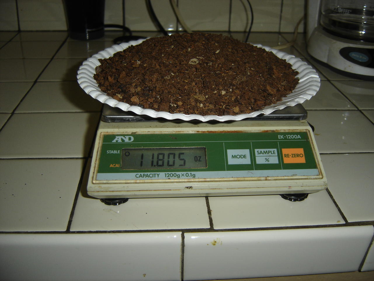

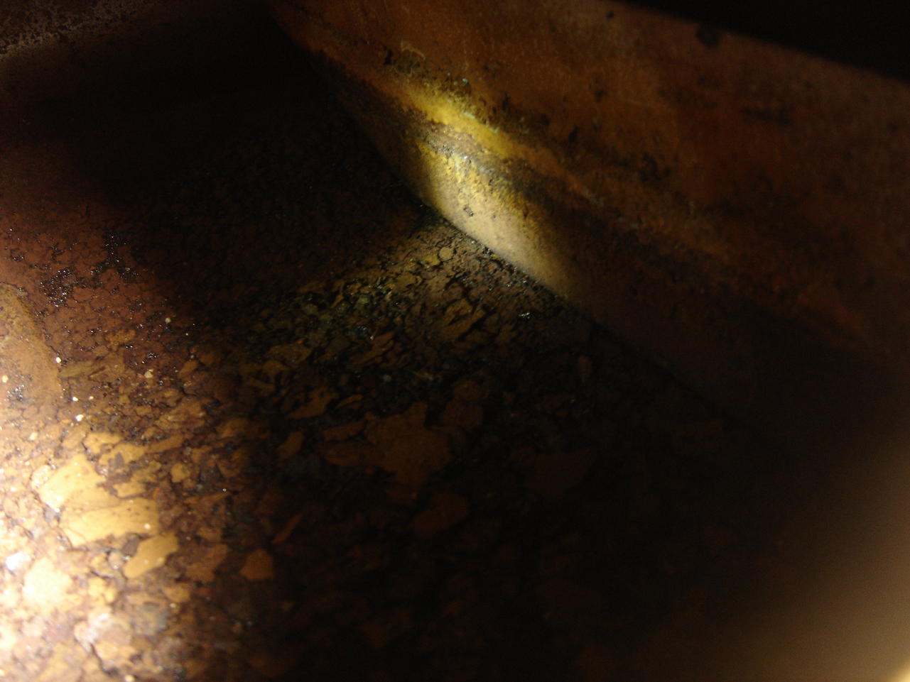

Mine ideled great in the garage but when I got away from home, too close to call a wrecker, It would quit. I could change out the filter up front and blow back through the supply line and it would get me home. It is a '72 tank that was crusted with crap. I took the sending unit out 1st, get your tank below half full, and it was rusted pretty bad. So I put a camera in the hole and barely could see rust in the picture. Dropped the tank and couldn't beleive what was there. You could stick a magnetic parts picker upper in there and probably get some thing but most of the 12 ounces in mine wouldn't stick to the magnet, CRUD.

Wow, that's nuts. I just got a usb boreoscope so i'll be having some fun with that. i'm about to drain the tank and go from there but i think it's still almost full so we'll see. Probably wont complete it today.
