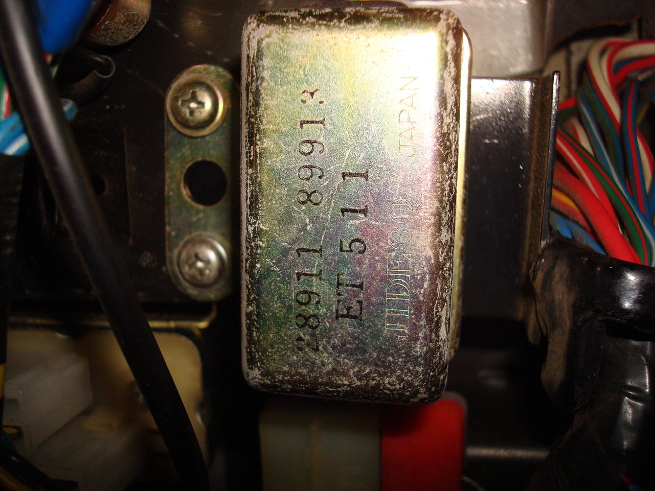

I wonder if the wires on the accessory relay could be switched around so the normally open connection is now the normally closed? Also does the radio do the same thing, play when engine is off and not play when it is running since it is supposed to be on the accessory circuit?
https://www.classiczcars.com/topic/49079-wipers-wont-work/#findComment-446313
Hmmm I just realized I am in over my head here as the accessory relay only has a normally open contact the normally closed contact would not be used.
Now I wonder if the ACC circuit is wired to the wrong wire on the ignition switch?
Hope this helps, I am outta ideas.

Thanks Mike you have been a great help. I do not drive the car much so the battery goes dead when i start the car and let it run for a while so i could not check if the radio does the same thing. I know over the last year i have been having some weird electrical problems. The radio, wipers and fan blower motor would not work then a few days later start working. I do remember when the car is running and i turn the wipers on you can here a clicking coming from where you said the relay could be. I will get a new battery and follow your instructions, and get the old girl on the road again :)
https://www.classiczcars.com/topic/49079-wipers-wont-work/#findComment-446345
Ok this looks like the culprit, turn the key to acc and it clicks. Started the car and the radio and wipers did not work , gave this a little tap and everything started working. Turned the car off and they quit working again another tap and all working. I will do some hunting and find a replacement.
