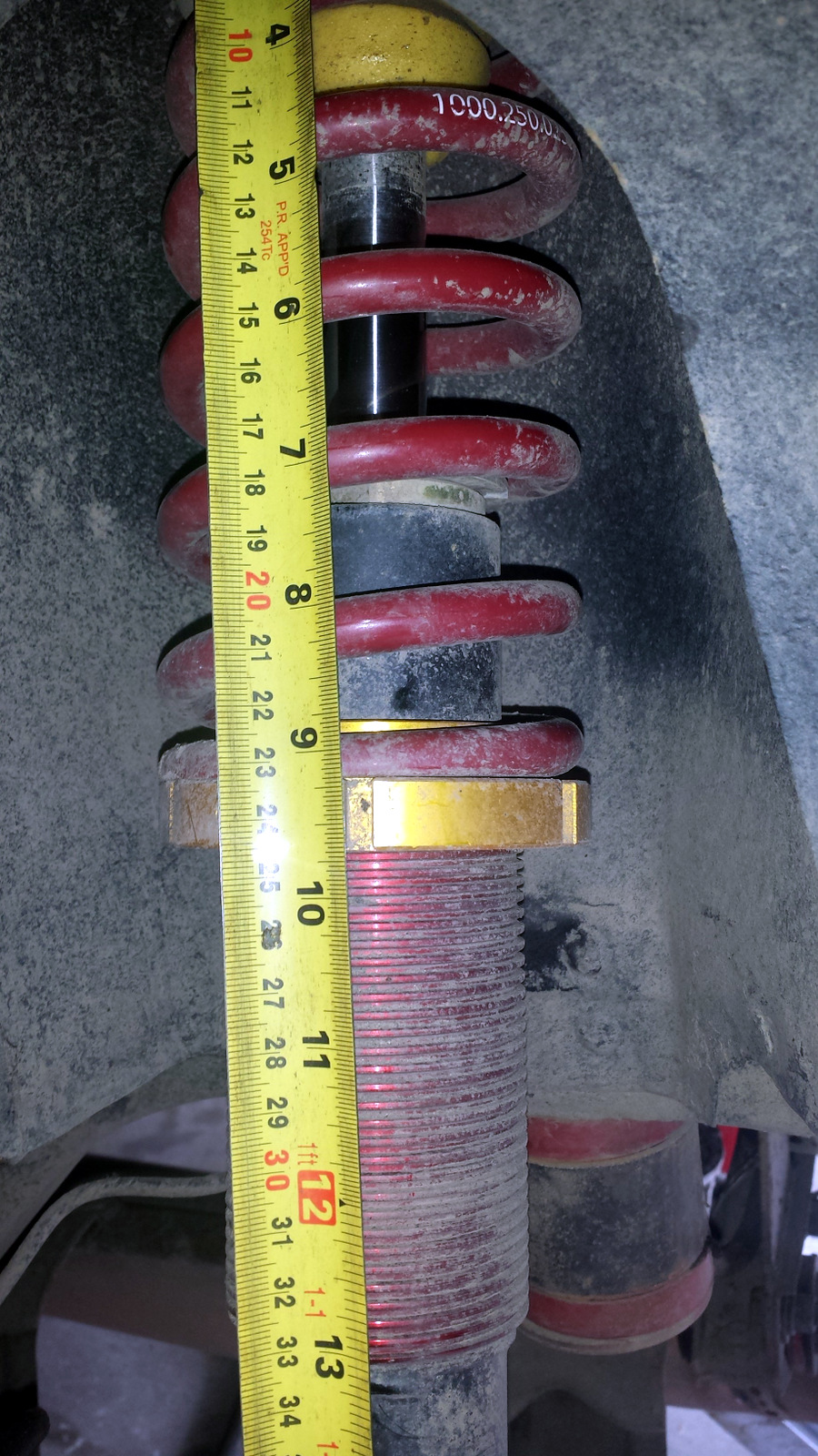

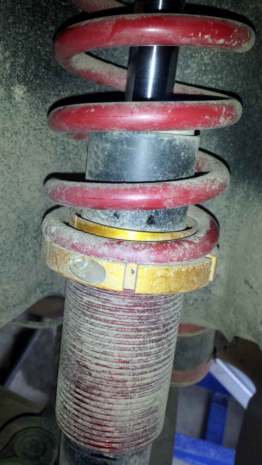

Just to lay it out in black and white, this is where the rear perch ring is currently positioned. It's above the top thread or two, which is above where it should be.
post-23609-0-59519700-1433975912_thumb.j

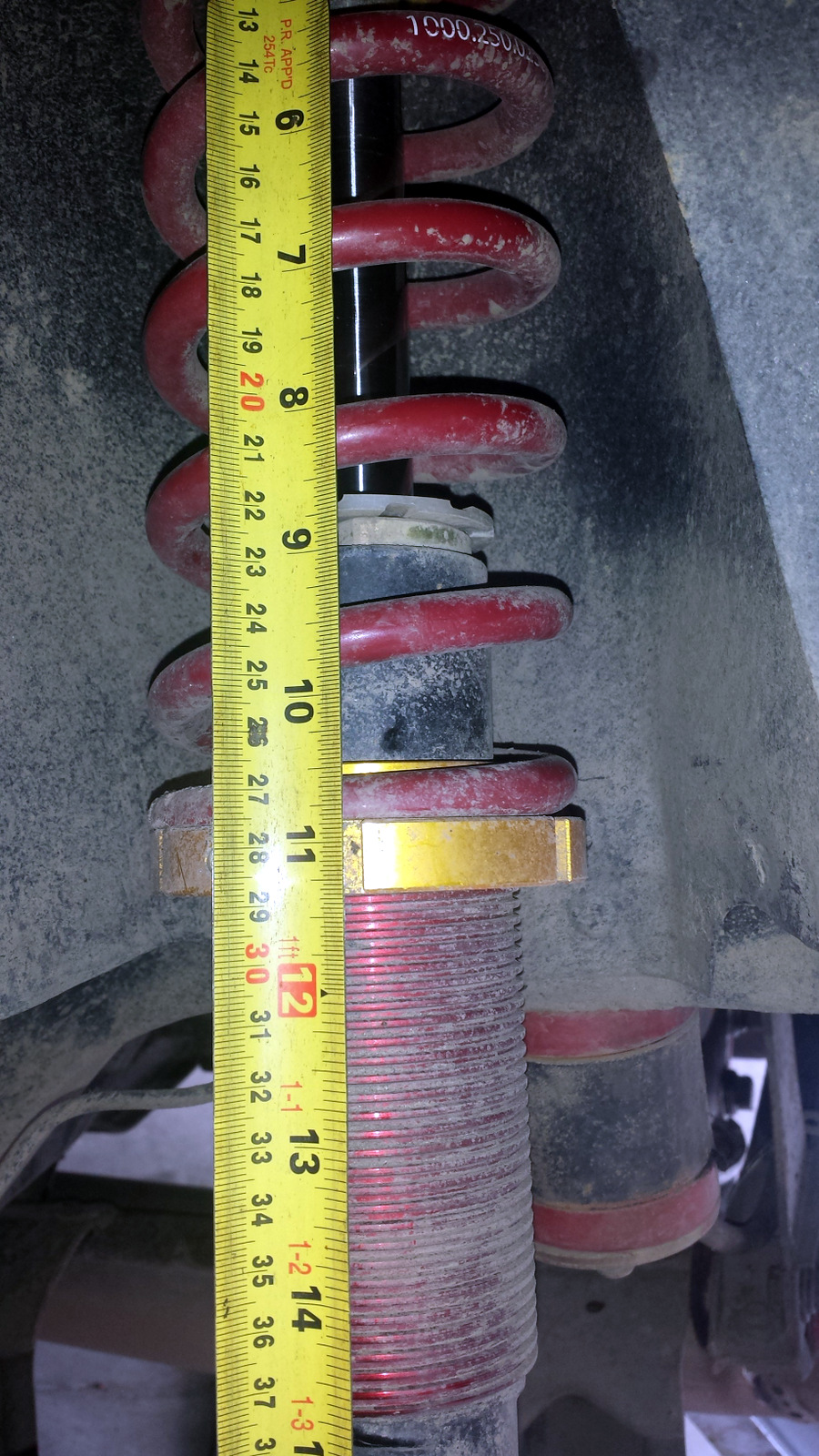

This is full static load, without a driver or fuel. A difference of about 1 11/16".
post-23609-0-08253300-1433975971_thumb.j
I can only think of two feasible options.
1. Use a taller spring. GC offers two spring lengths, 8" and 10". I have a 10" spring, front and rear. I could buy a 12" spring, but as is, I'm only getting 1 11/16" inches of extension out of this suspension as is. How much is necessary to maintain? Raising the car by using a longer spring will also lower the amount of extension by the same amount.
2. Use a strut spacer. I can have a local steel shop laser cut up to a 1" steel plate, which I could shape the same as the camber plates and place under the strut towers to move the suspension downward.
GC hasn't said more than there is an easy fix, but hasn't disclosed it. This response came months after they suggested I move the camber plates below the strut towers and use their strut-brace as an alternative to a 'finisher' for engine bay aesthetics. I've been told on several occasions since last Autumn that the strut braces are in production, yet I've also been told that they're not for sale. I was kind of expecting a free set to be honest. Even then, I think I'd need to have some thicker plates machined to gain some height.
I'm 9 or 10 months into this email string between them and I and feel no closer to any sort of resolution. I'm hoping they pull through with some strut braces and I can take care of some thicker support spacers. Afterall, it was THEIR suggestion.
Any thoughts? Specifically how much strut extension should be maintained? OR, can you think of any possible situation where you would purposely put the threaded collar so low on the strut, and offer an 8" spring to boot? By measurement you could sit the car on the frame rails if you cared to. I feel it's been cut too low, they say it's what I ordered.

Ideally, your struts have been cut to give the desired ratio of compression travel, to extension travel.  That's the main goal of the strut sectioning.  John Coffey posted some numbers a little while ago, somewhere.  Can't remember it but I'd guess it's like a 2:1 ratio.  So if you have 6" total, you'd look for 4" compression, 2" extension.
On the springs, I've looked at spring extenders myself.  They're basically spring perch elevators.  Molded plastic pieces designed to fit the spring shape and sit in the perch to lift the spring.  I found some but they were more than I wanted to spend.  I'll probably fabricate some, eventually, just to get another 1/2 inch.  They are out there though.
Excellent info. So for a fairly stiff 250 lb spring, likely that extension number would drop well below 2". Perhaps a spring extension would work then. That said, would there be any advantage/disadvantage of running those instead of a 12" spring with the perch threaded 1.5" down?
