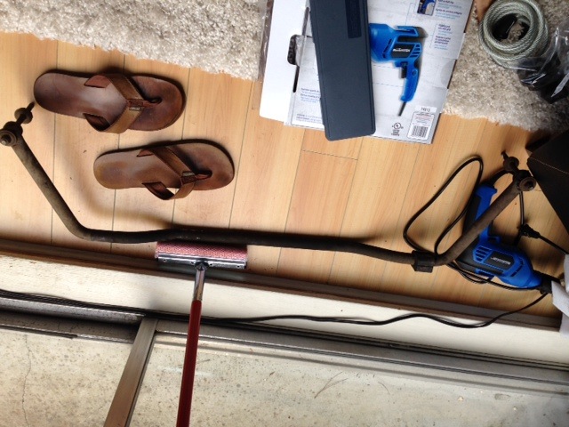

My Front sway bar end links and bushings arrived, and I thought I might as well try and sand the bar down (I don't have access to a sand blaster) and give it a quick shot of paint.
Any suggestions for paint? How much does a sway bar flex, will I need a special flexible paint?

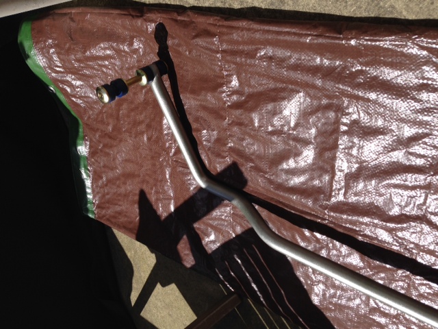

^ Thanks for the suggestion. I didn't end up getting paint or POR as I was unsure of a primer. So this info is greatly appreciated. Wire brush is cleaning it up nicely. Although after picking up some callipers today, I realized the thing is 1"!! I think i'll need different bushings too. But where does one get aftermarket bushings for an unknown bar?

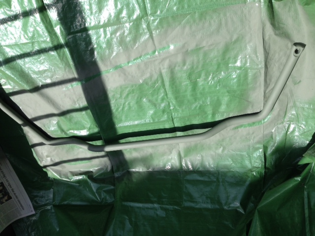

Well, I think i'm going to go with MOOG universal 1" sway bar mounts. I stripped, etched/primed and painted the bar today. I then test fitted the sway bar end links I had purchased for a 240z replacement part. The bolts themselves are the same length as what was on there, but the bushings are quite a bit thicker and I don't have enough thread to get the nuts on. Anyone see any harm in cutting the middle spacer (Between the bushing caps) and 1/4-1/2 Inch to get a few threads showing?
