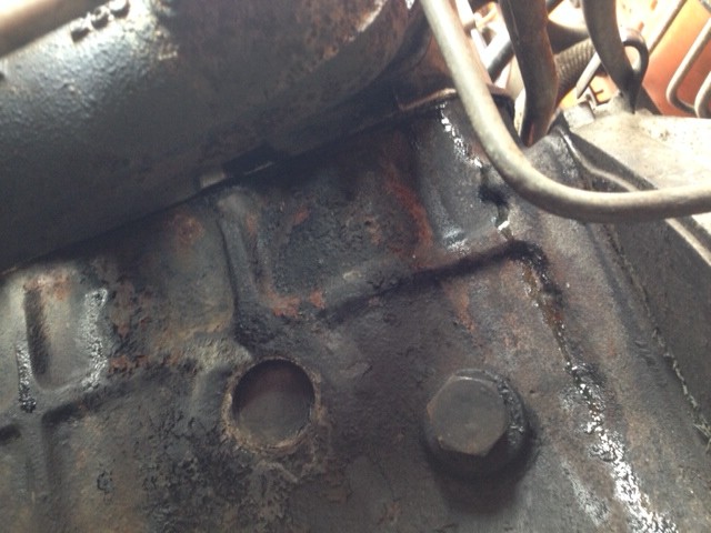

Looks like I have a coolant leak between the head and the block, right near the back of the engine, close to the transmission.
I'm assuming this is clearly a head gasket? Not having much luck with this car so far. The oil is still clear (Not milky).
Edit: Sorry. the photo is upside down, I can't figure out why. It's upright on my computer.

Thanks for the picture rotation!
Good to know it's possible it could only be a coolant leak. I guess the only real way to check is to do a compression test?
