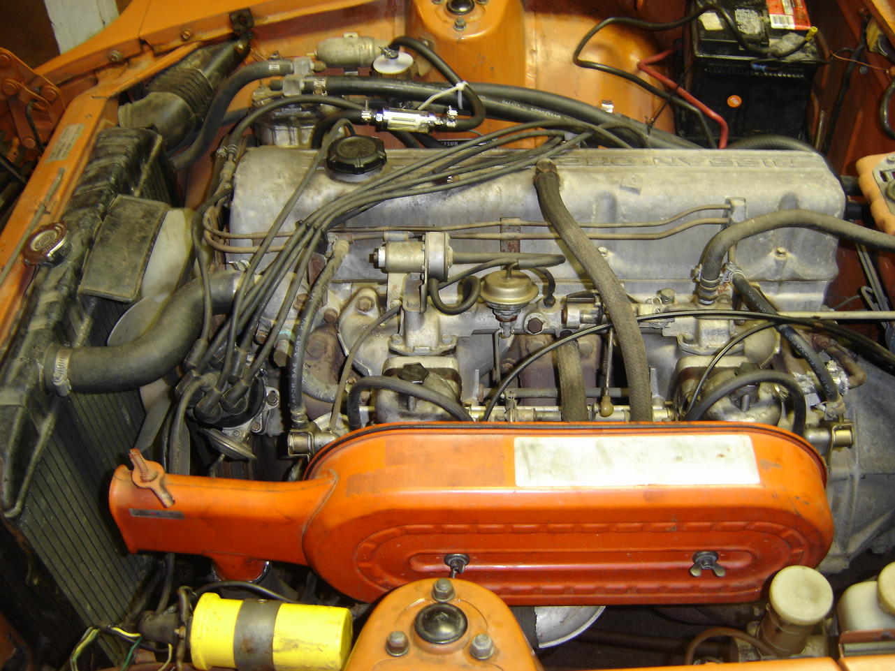

The original throttle linkage had a dash pot that limited how fast the throttle would close. The control valve for the dash pot is located on the balance tube above the forward carburetor. Your pictures show the control valve with tubing connecting the inlet to the outlet.
Perhaps some of the more experienced users here can do a better job of describing how and when it originally worked. It is not uncommon for the dash pots to be MIA.
I think LeonV hit the nail head. https://www.google.com/webhp?sourceid=chrome-instant&rlz=1C1BOFA_enUS494US494&ion=1&espv=2&ie=UTF-8#q=testing%20a%20brake%20booster
But Mr Warner makes a good catch also, inlet and outlet hoses reversed.
Here's a picture of mine for reference.
