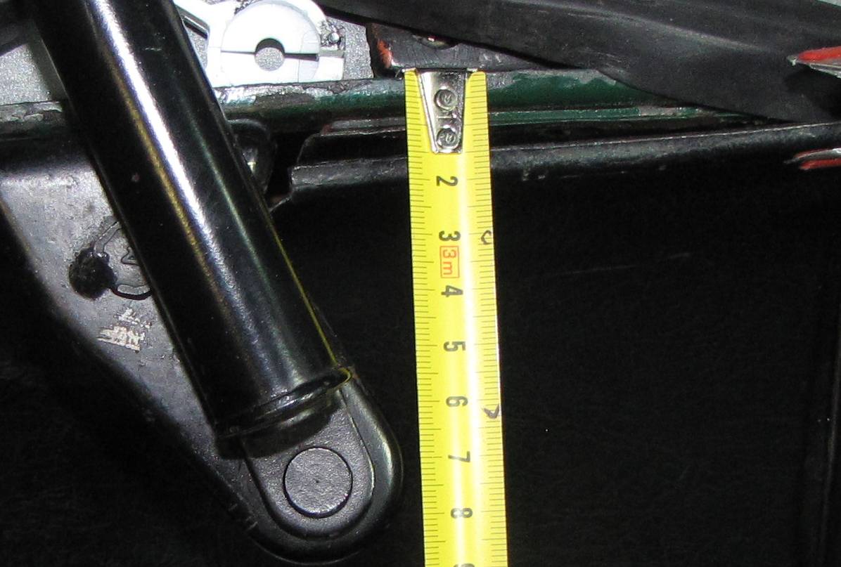

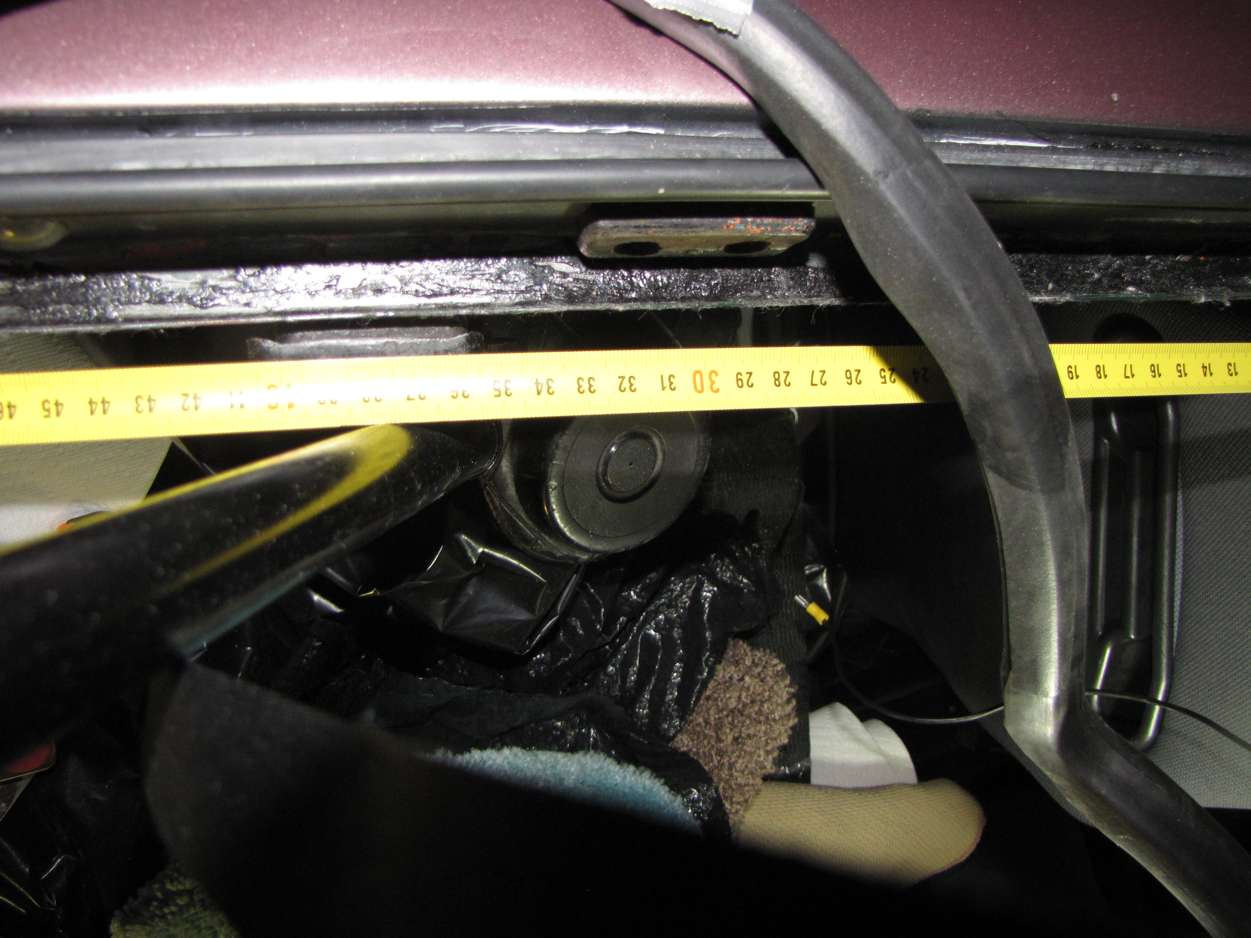

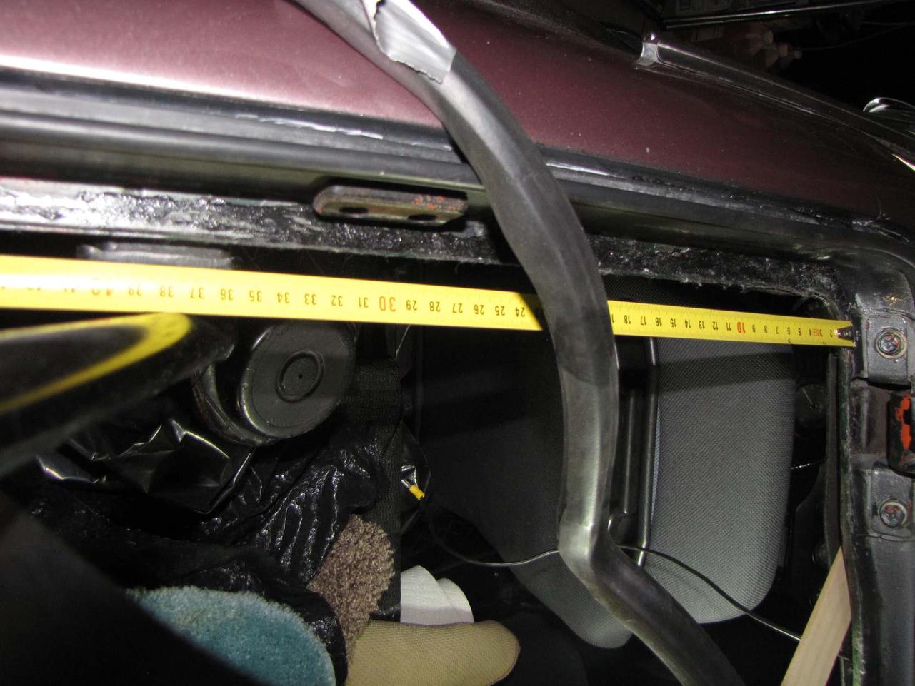

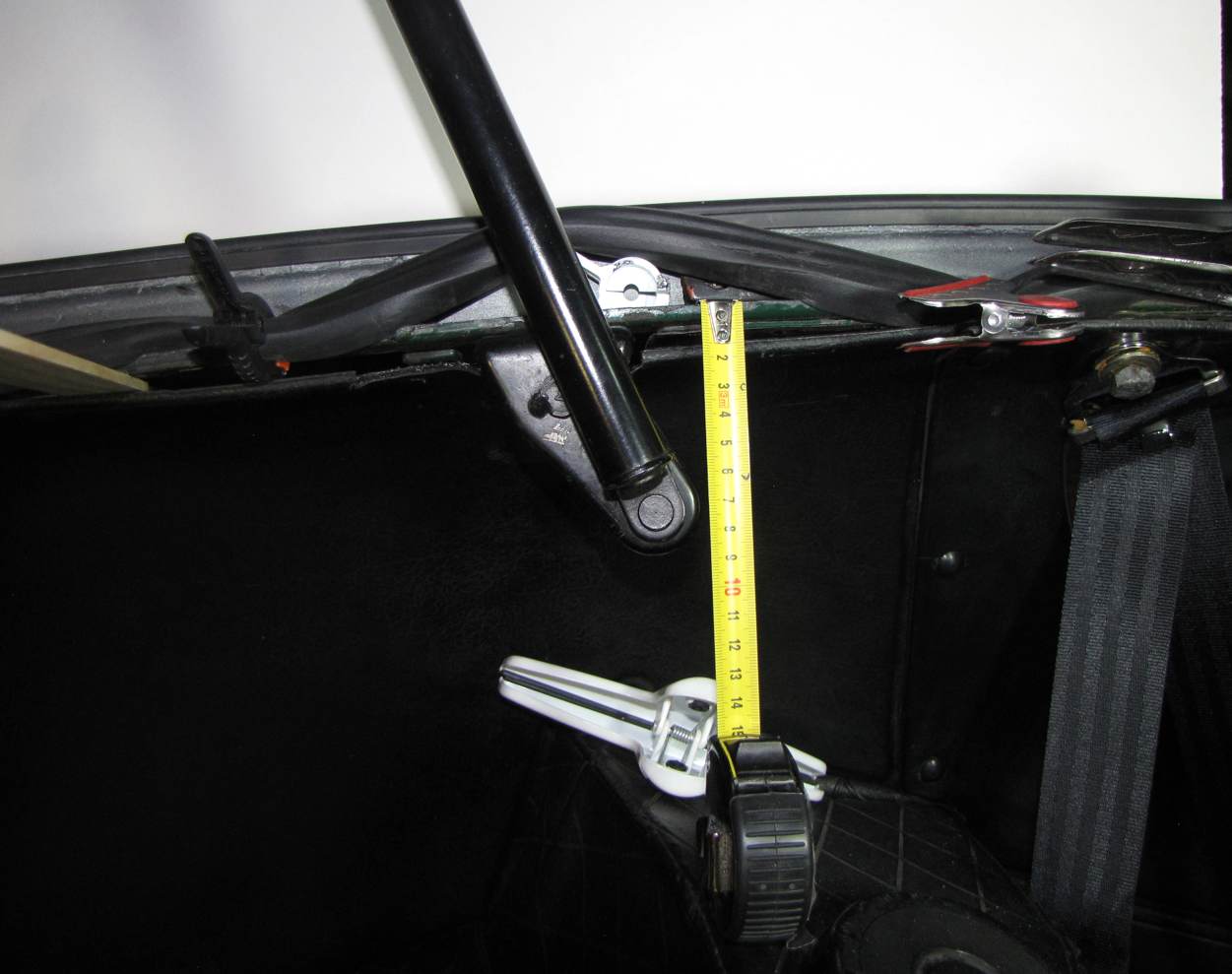

I am in the process of restoring a 280z but the hatch support hinges rusted off. I will be welding in new hinges and I was wondering if someone could give me the dimensions of where the hinge is located on each side. Approximately how many inches from the bottom and the top of the rear hatch area.
https://www.classiczcars.com/topic/49124-help-280z-hatch-support-hinges/
Here are pictures from a 240Z, don't know if holds true for 260 or 280Z.
Distance from metal lip down (weather strip not installed yet):
Close up of down measurement:
354 MM from metal hatch lip to front of rod mount (no weatherstrip there yet either):
Measured from metal lip not weatherstrip at far right of picture:
