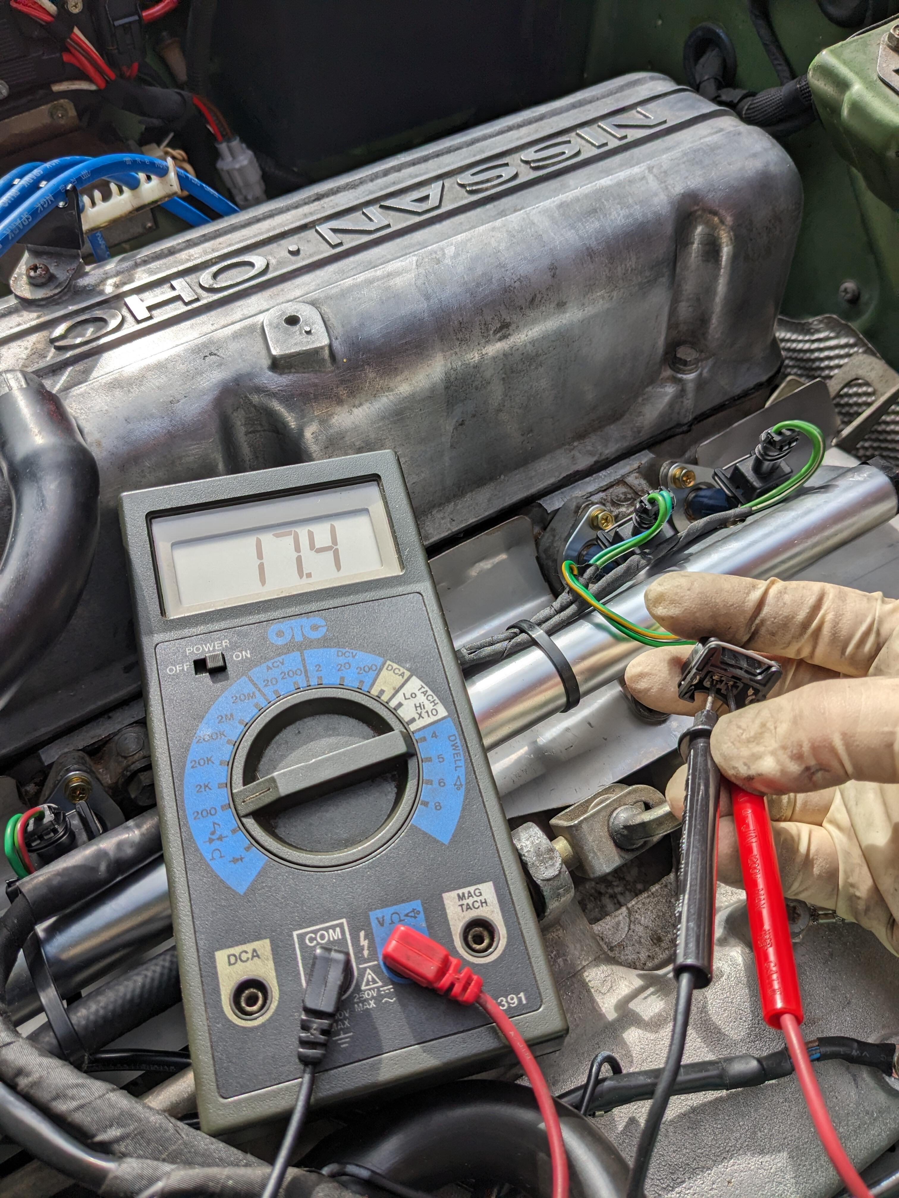

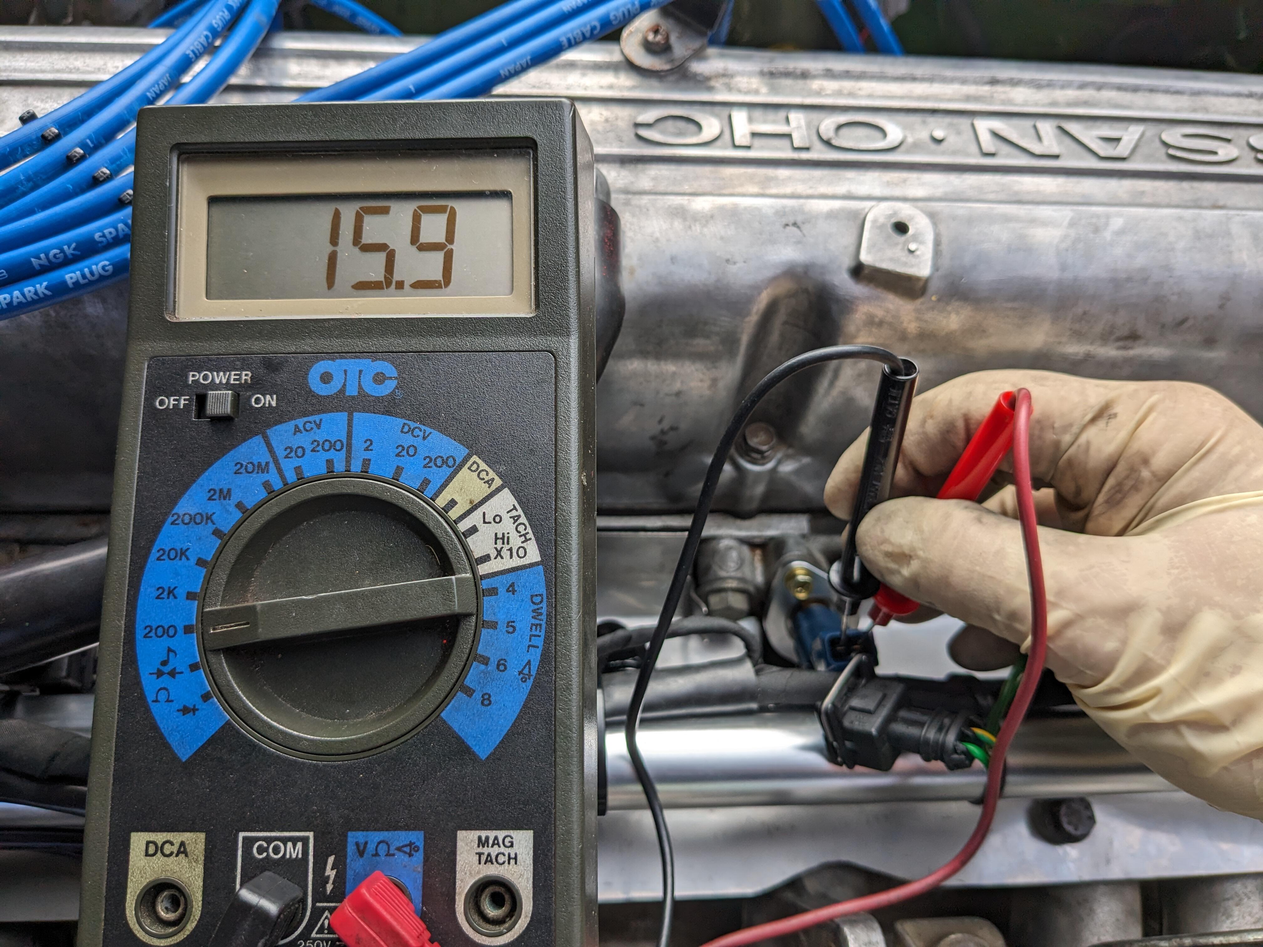

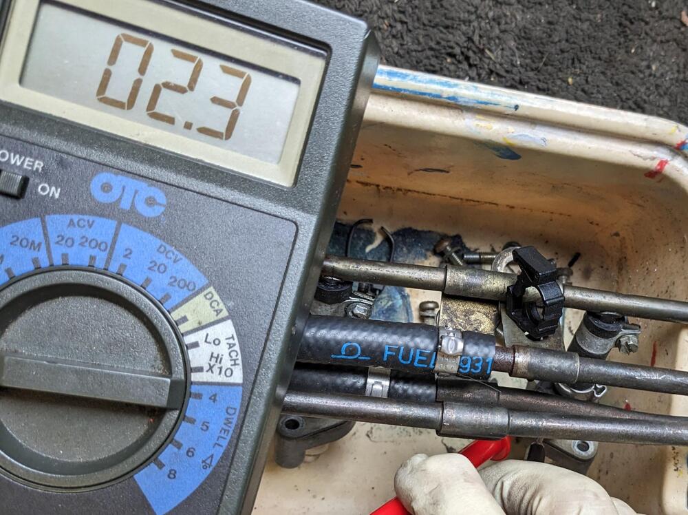

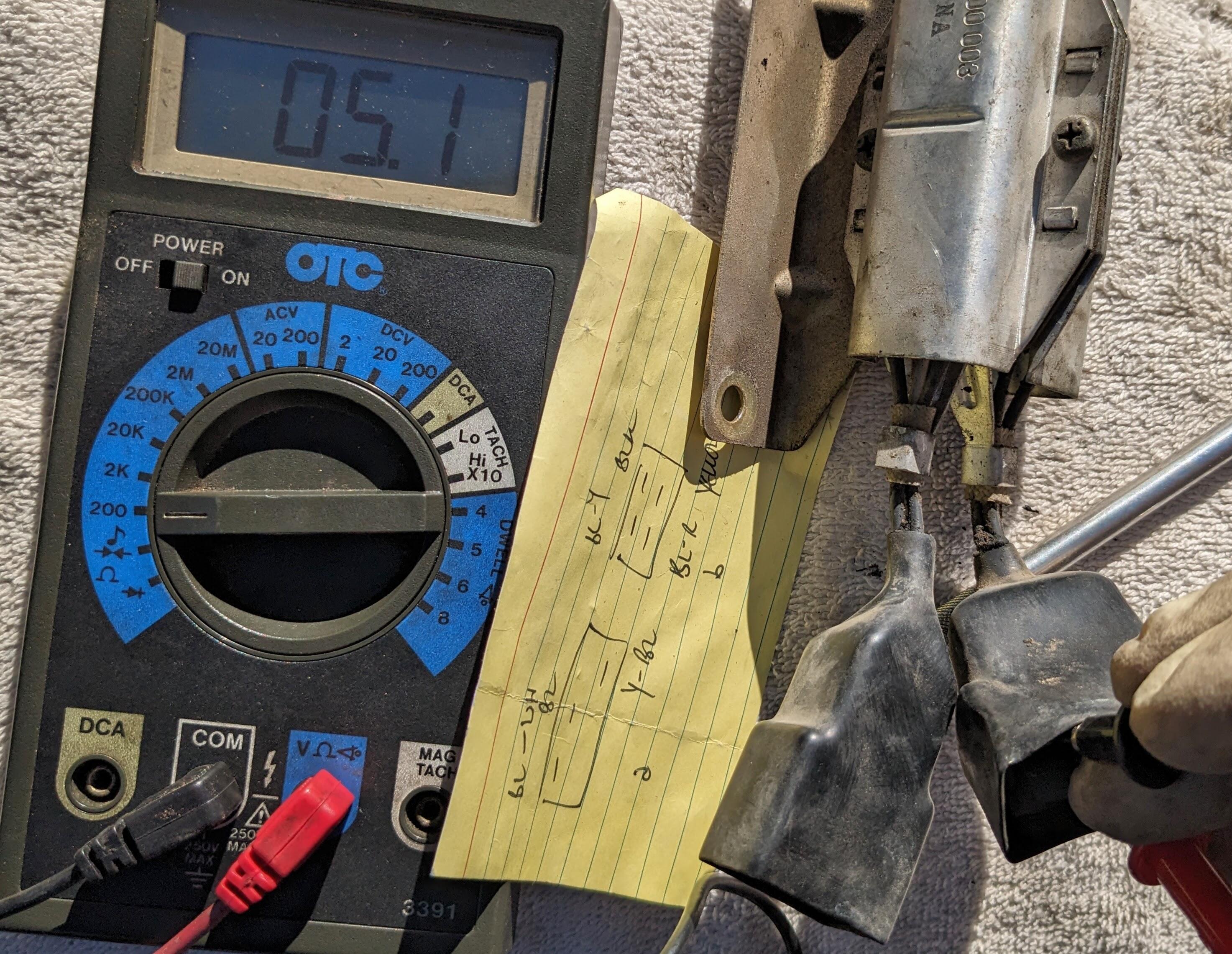

Took a number of resistance measurements today
lead resistance .3ohm
harness resistance, with ballast 17.1ohm (all the same)
Injector resistance - All 15.6ohm
stock injectors 1.9-2.0ohm

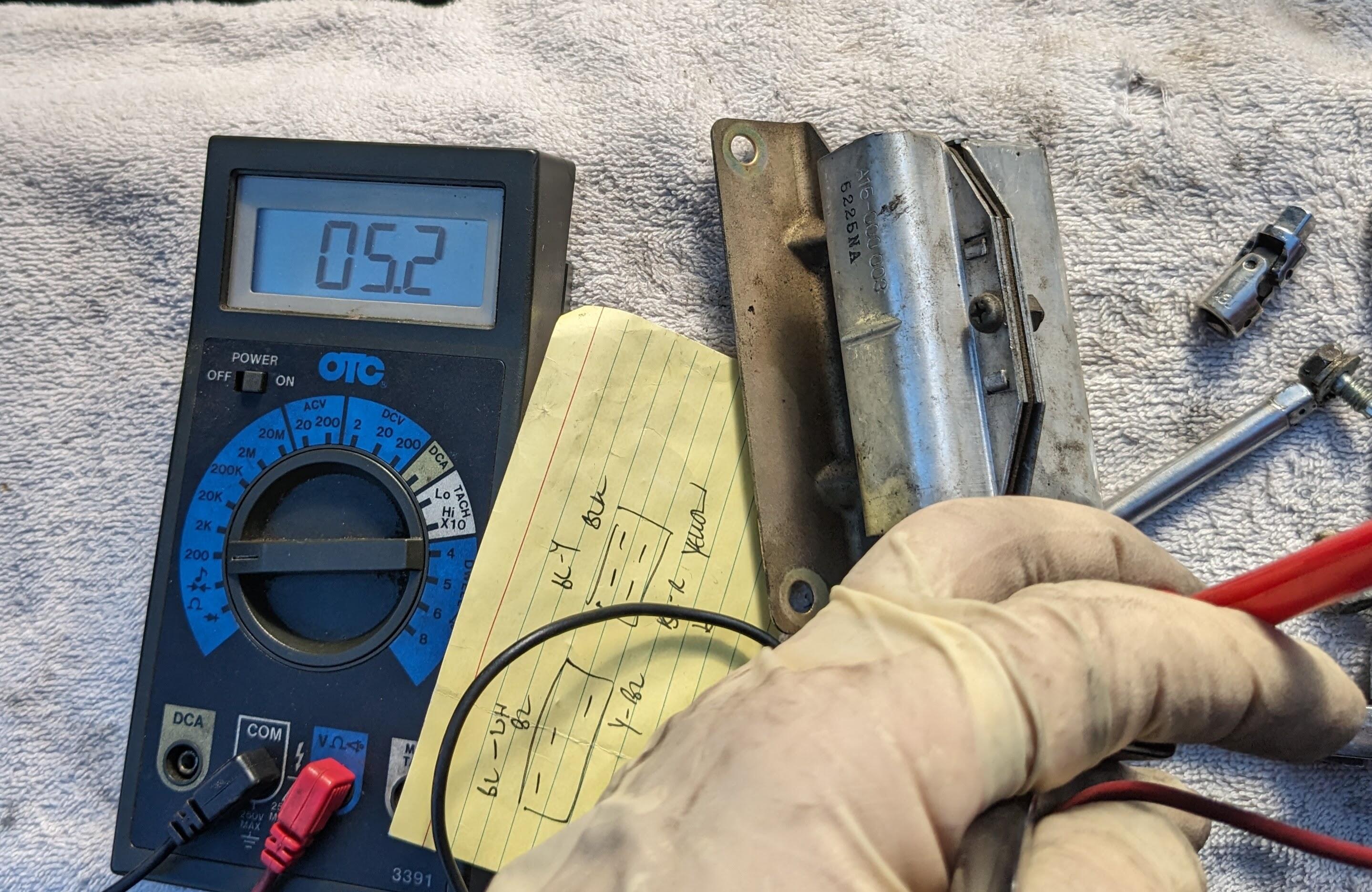

Ballast pack - very clean terminals
4.8-4.9ohm

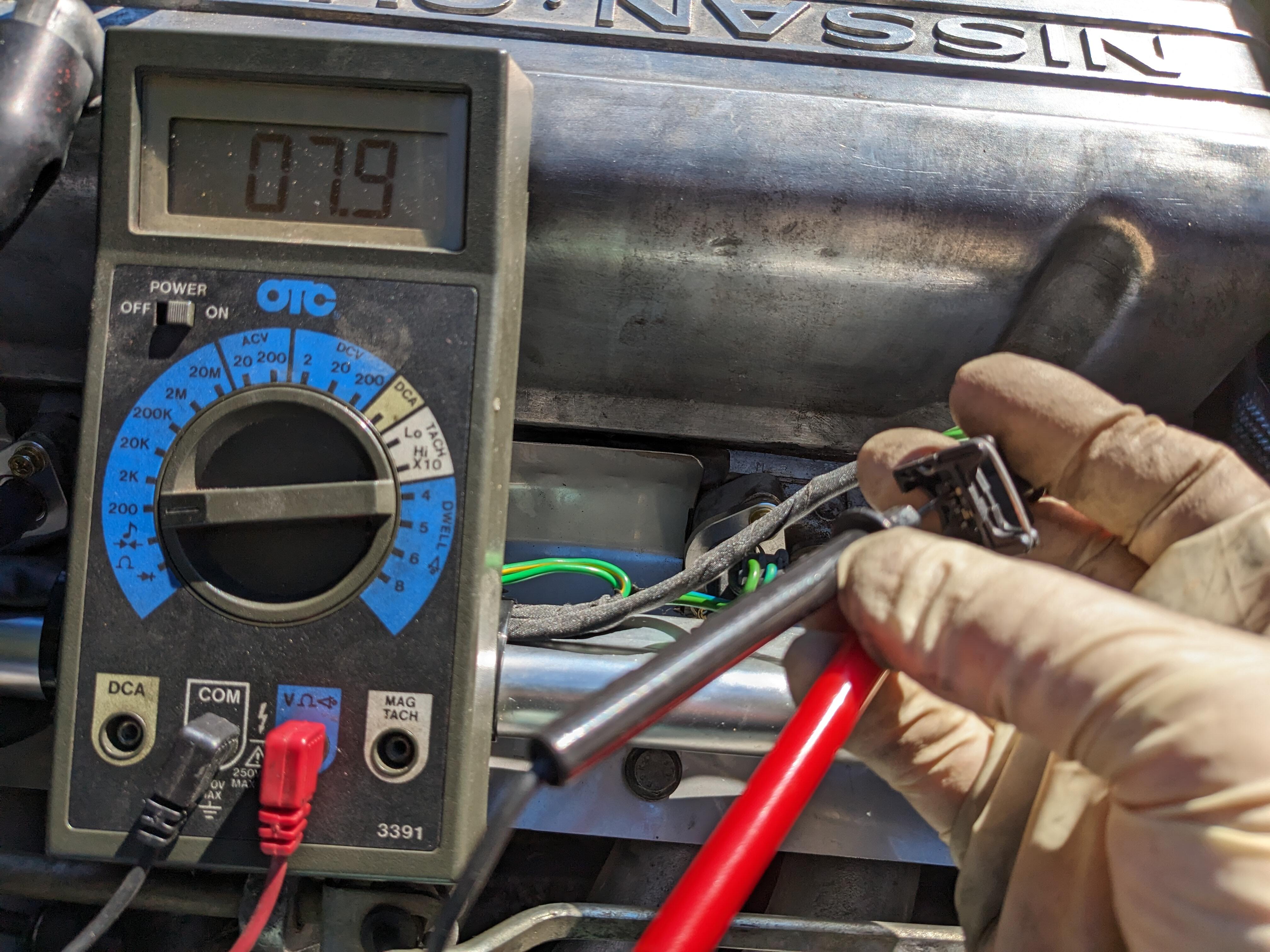

Harness resistance with Ballast pack bypassed 7.6ohm

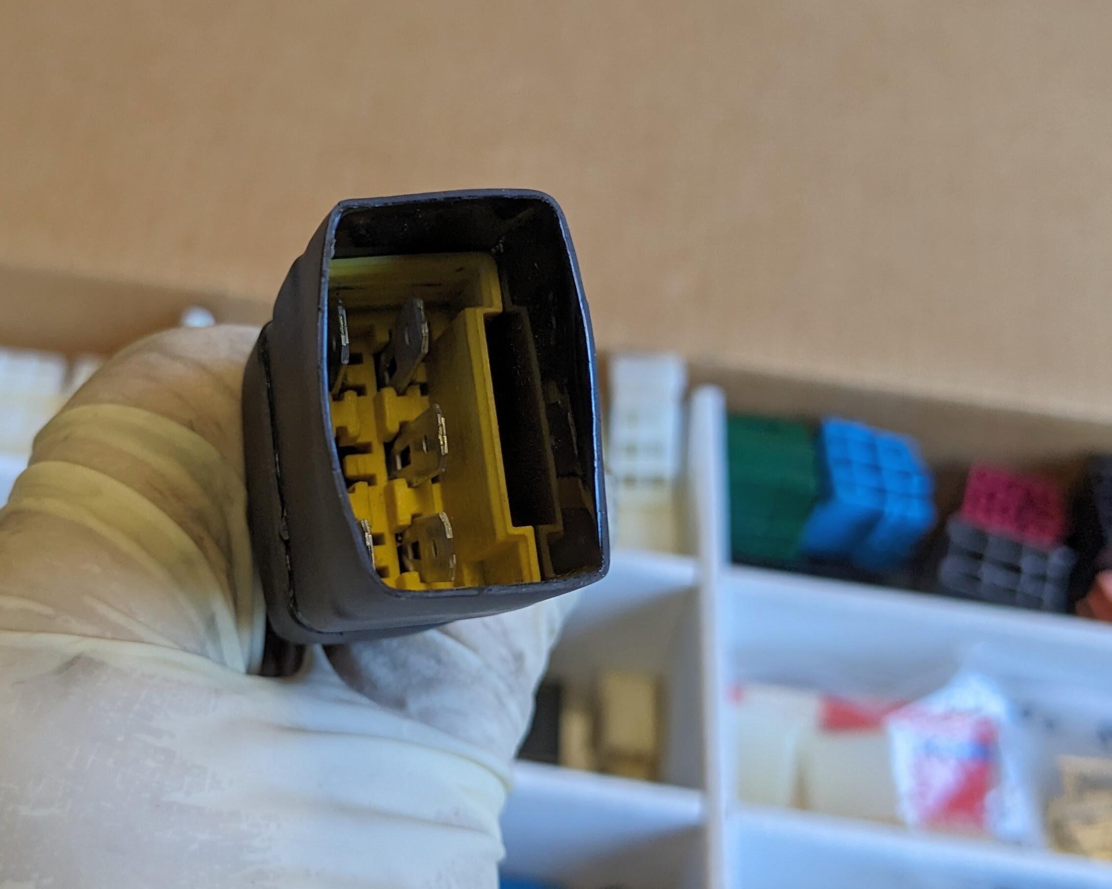

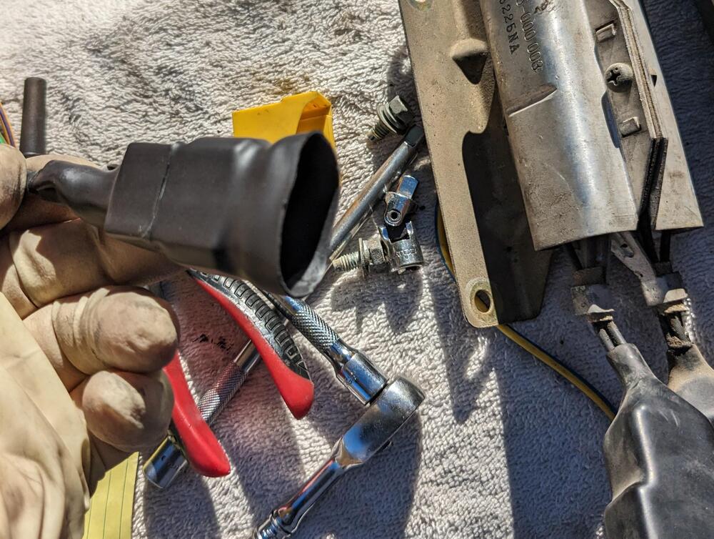

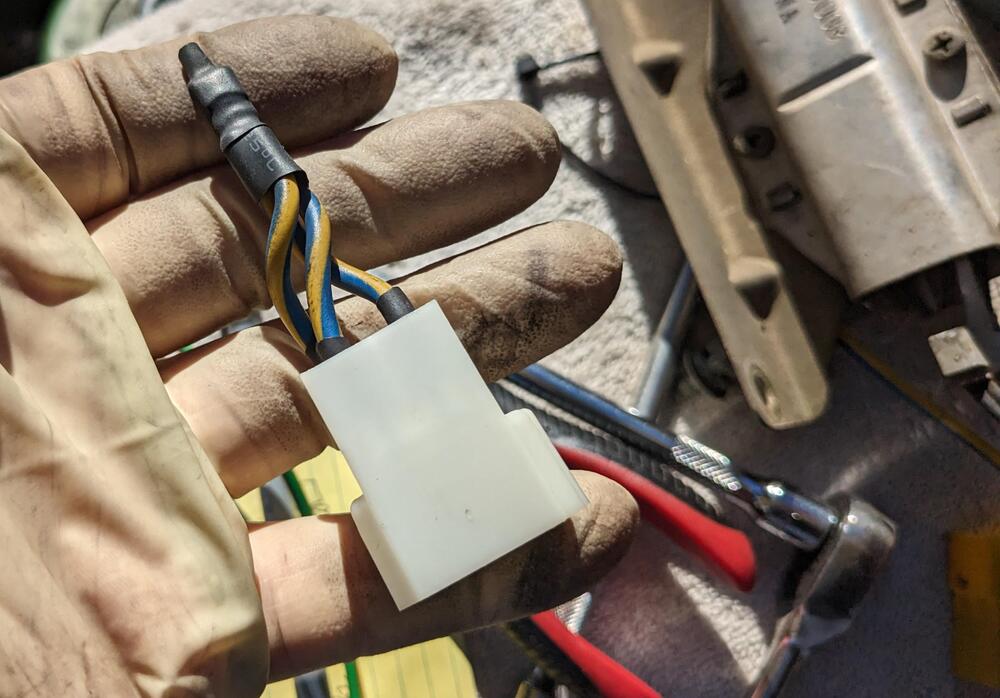

2 bypass plugs to maintain the integrity of the original harness.
4pole (3 wire)
sleeved with heat shrink to approximate stock boot
6pole (5 wire)

As for the resistance measurements, most of them look good. The two where you are sticking the probes into an empty injector socket (to measure back into the harness) really don't tell you much though. You're just reading a combination of ballast resistors and injector resistances in series parallel combination. Didn't hurt anything, but really no good data to be gleaned from that.

I was mainly checking that I had uniform values at all the injector sockets, since they all originate from those 2 wires that feed the ballast.
