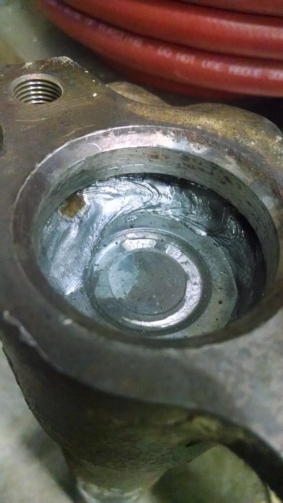

Posted May 1, 201411 yr comment_446972 So I was ready to section my strut housings until I put my one of my front KYB struts into a front housing and found the strut already seems too long for the housing - can't screw in the cap - about 2 inches off. Do I have the wrong shocks (link below)? The bottom of the housing (tube) looks like it might have been modified (picture attached). Does that look factory or is there a chance they've been modified? I appreciate your help. Thanks, John KYB 4 Shocks Datsun Nissan 280z 75 to 78 260z 74 75 Late Check Vin No | eBay Edited May 1, 201411 yr by 78-280 Link to comment https://www.classiczcars.com/forums/topic/49153-help-please-ground-control-install-strut-inserts-too-long/ Share on other sites More sharing options...
May 1, 201411 yr comment_446977 Isn't that the other side of the strut mount, where the ball joint bolts on? Looks normal, I believe. It's the inside of the tube that matters. You might have four rear shocks. The fronts are shorter, by about 3 1/8", for a 280Z. If my measurements on some Tokicos are correct. ~18" for the rears, and 14 7/8" for the fronts. Link to comment https://www.classiczcars.com/forums/topic/49153-help-please-ground-control-install-strut-inserts-too-long/#findComment-446977 Share on other sites More sharing options...
May 1, 201411 yr Author comment_446981 Yes, that's the bottom of the tube where the ball joint mounts. I took a pic of it because I thought it looks like it could have been modified. But the more I think about it that seems unlikely. Everything in the suspension was old and stock looking. I am trying to install the front (361002) struts. The rears (361003) are significantly longer. There is a little dish shaped piece on the bottom of the strut. It's almost seems like I could cut those pieces off and they would fit in the tube. Actually it seems like that would reduce the length of the strut insert body by about 1 inch and I need the body to be almost 2 inches shorter.I was going to section the housing, but I guess that only applies if you're using a non-stock, shorter strut?Thanks,John Link to comment https://www.classiczcars.com/forums/topic/49153-help-please-ground-control-install-strut-inserts-too-long/#findComment-446981 Share on other sites More sharing options...

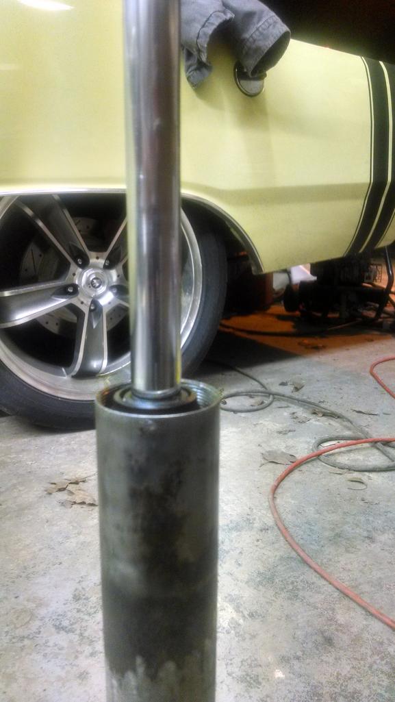

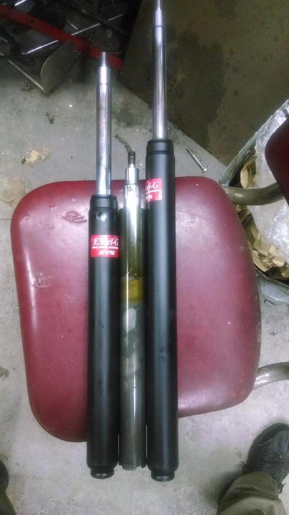

May 1, 201411 yr Author comment_446989 So I went back to the garage and checked the inserts I took out and they are shorter. The pictures shows the new fronts, the old fronts, and the new rears. The new fronts have a significantly longer body that the old front strut inserts. The other pic is what it looks like when I put the new struts in the housing. The caps can't even catch the first thread. Do you think the housing must have been sectioned a long time ago? Everything seemed old and stock, rusty, worn, doesn't really make sense... Thanks Link to comment https://www.classiczcars.com/forums/topic/49153-help-please-ground-control-install-strut-inserts-too-long/#findComment-446989 Share on other sites More sharing options...
May 1, 201411 yr Author comment_446990 I just realized I may be missing a cap on the old insert that makes us for at least some of the difference in the body length... I guess I'll look at it all a lot closer tomorrow. Link to comment https://www.classiczcars.com/forums/topic/49153-help-please-ground-control-install-strut-inserts-too-long/#findComment-446990 Share on other sites More sharing options...
May 1, 201411 yr comment_446994 I think that what you took out are the original damper assemblies. They are essentially the internals of a shock absorber and the strut housing is the outer tube of the shock. I did the same on my 76. The KYB's should have come with their own nut, it's called a gland nut and it's designed to fit the top of the shock. It's also possible that there is some crud down in the bottom of the tube. I think I may also have read about the occasional weld bump down there also, that needs to be dealt with. The KYB's with the KYB gland nuts should work. You don't want to use the old gland nuts with the new KYB's. But with the KYB's you'll be at the same ride height, plus a little extra from the gas charge.Find the KYB gland nuts and try again. That's all there is, the gland nut, the insert, and the strut tube. Link to comment https://www.classiczcars.com/forums/topic/49153-help-please-ground-control-install-strut-inserts-too-long/#findComment-446994 Share on other sites More sharing options...
