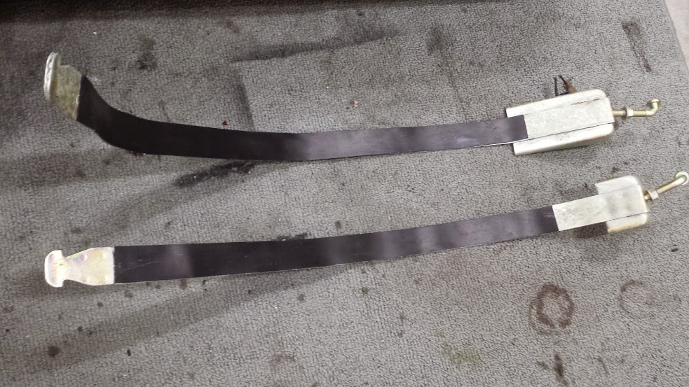

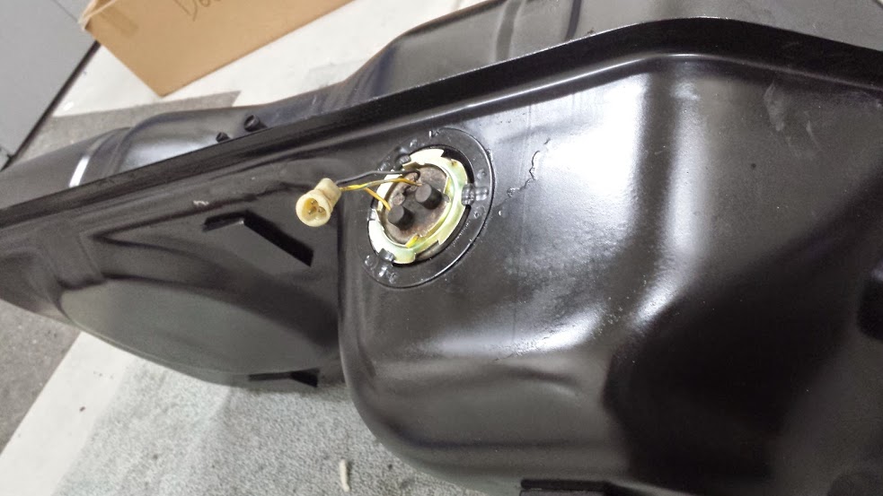

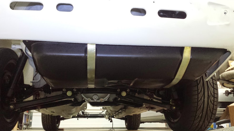

I took my gas tank to a local radiator shop and had them hot tank and seal it. They also painted it black for me.

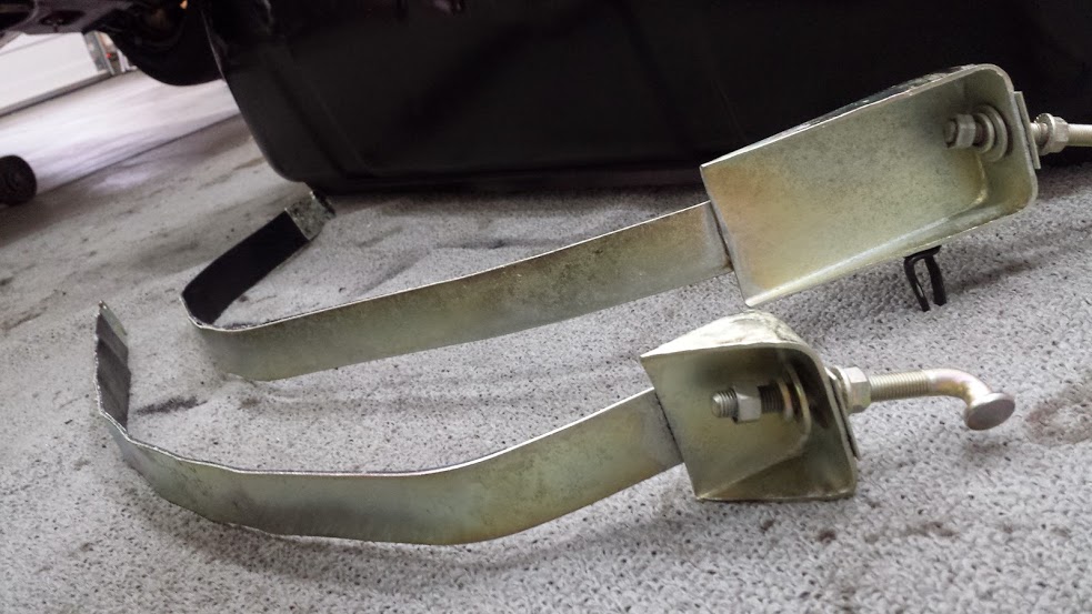

Installed new rubber insulators on the straps

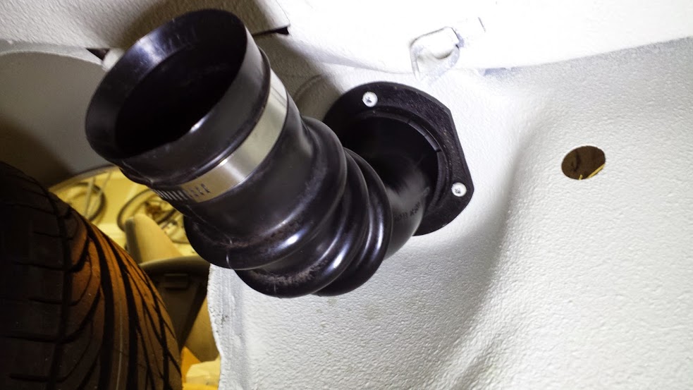

Cleaned up the filler hose and installed it.
And finally got my tank in.

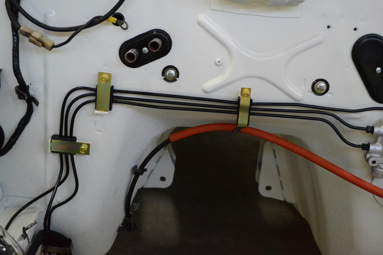

Now I just need to figure out where all of these fuel lines go :ermm:

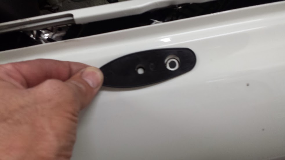

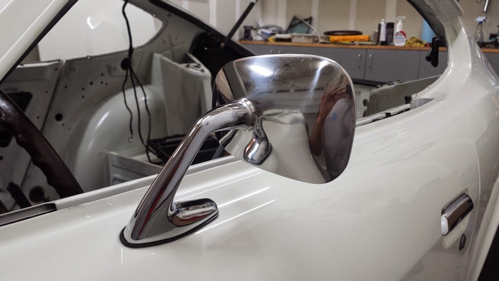

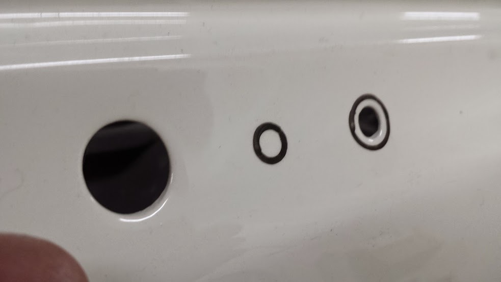

Also bought a new side mirror from a 240Z
Holes dont line up so I had to drill a new hole and make the other one larger
And installed pic
Much better than the plastic 280Z mirrors I think.

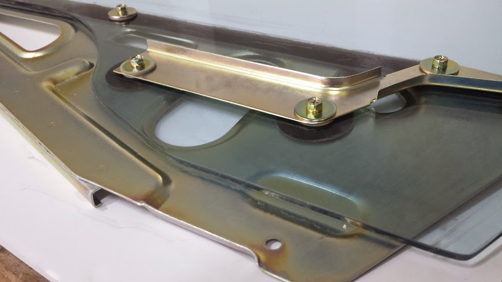

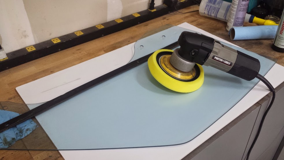

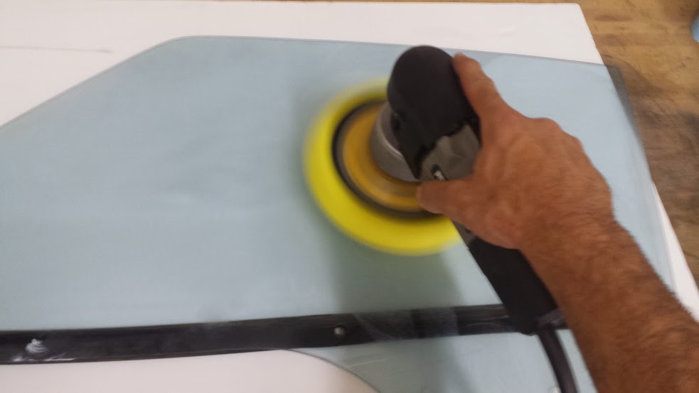

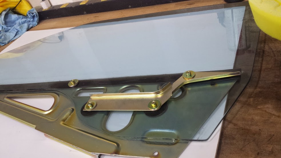

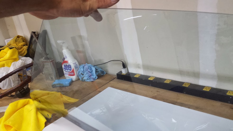

Started assembling my door glass. Polished them up a little to take some of the fine scratches out.
Smooth as.... well, glass.

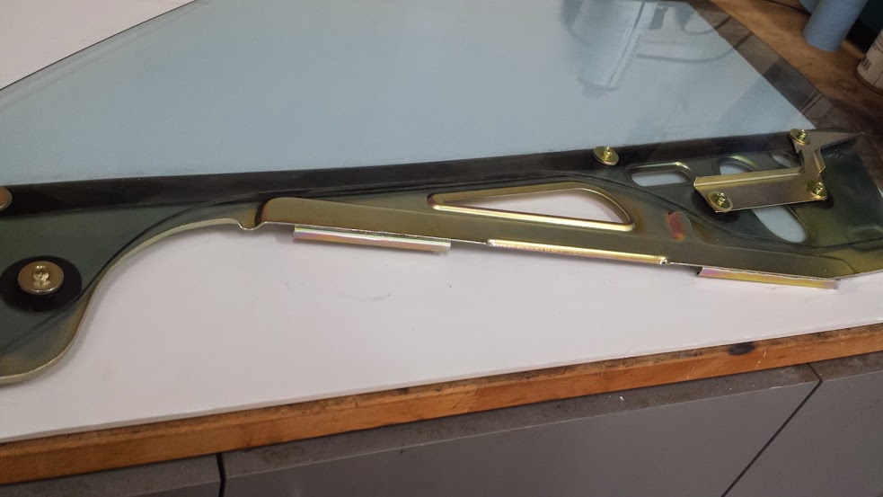

Freshly plated hardware
Now I need to source some new window regulators because I had mine plated and it destroyed the plastic rollers and the crank mechanism in the process :disappoin

What did you use to polish the glass? My windshield has minor surface things I'd like to polish off.
John
I just used a buffing compound with an aggressive pad. It took out most of the fine scratches and haziness. There are some deeper ones that I may try to get out with a glass polish kit.
