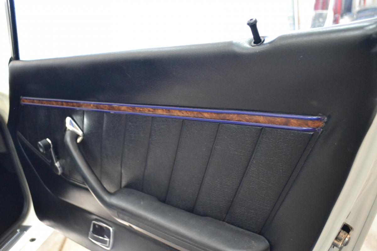

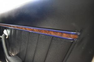

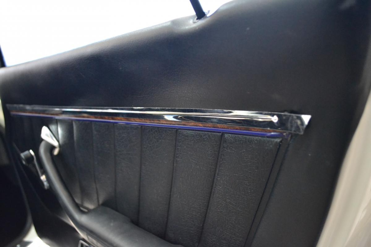

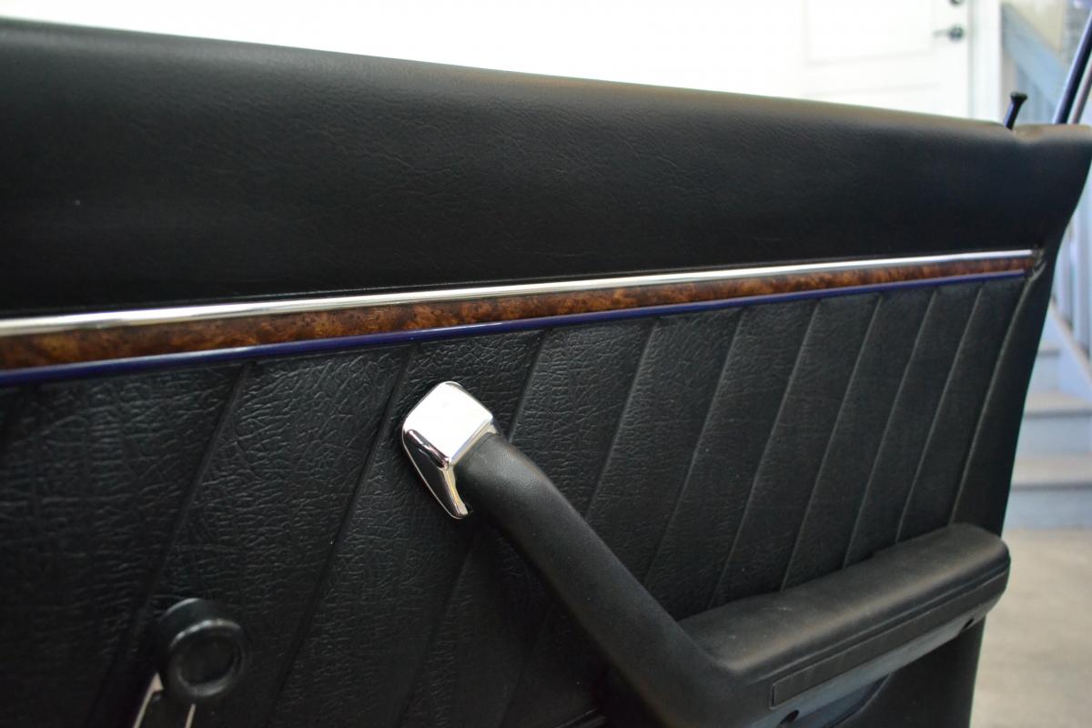

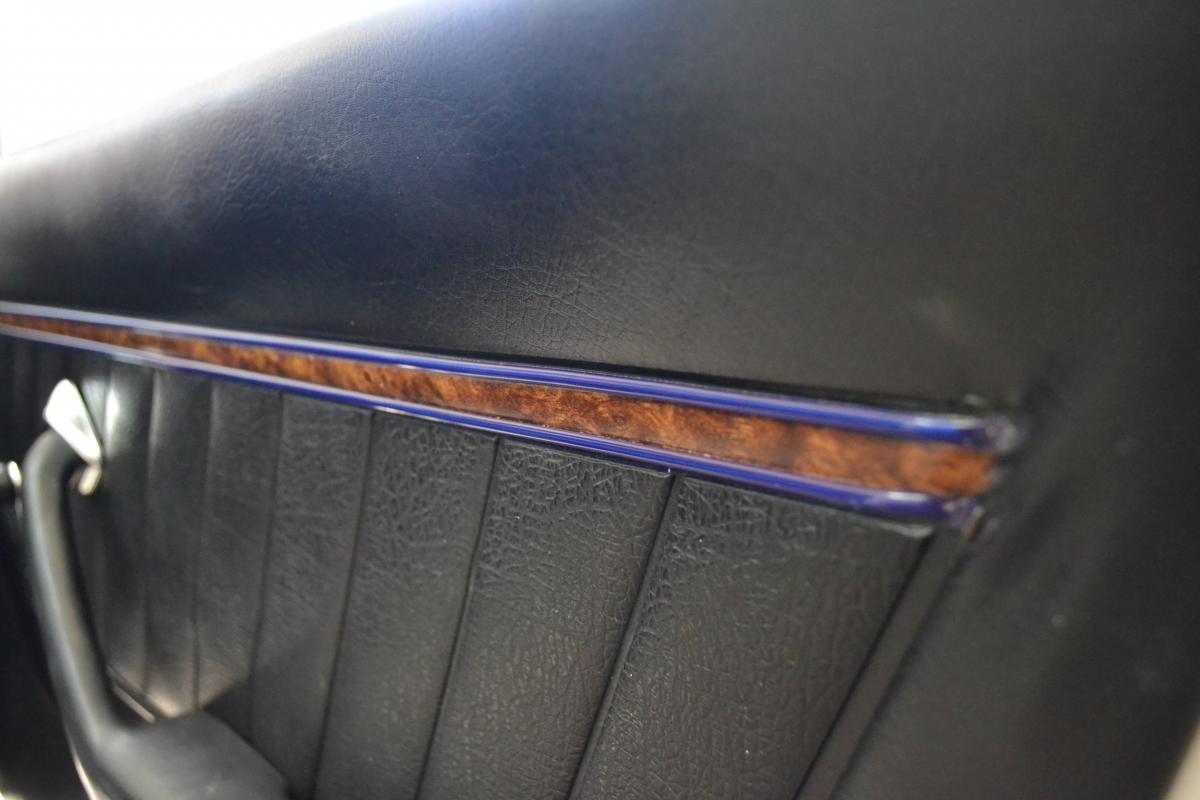

I "re-chromed" my door panel strips today. I bought some chrome vinyl wrap off Ebay and cut some strips and applied it with a heat gun. It turned out really nice.
Heres what they looked like before, typical chrome peeled off exposing blue plastic.

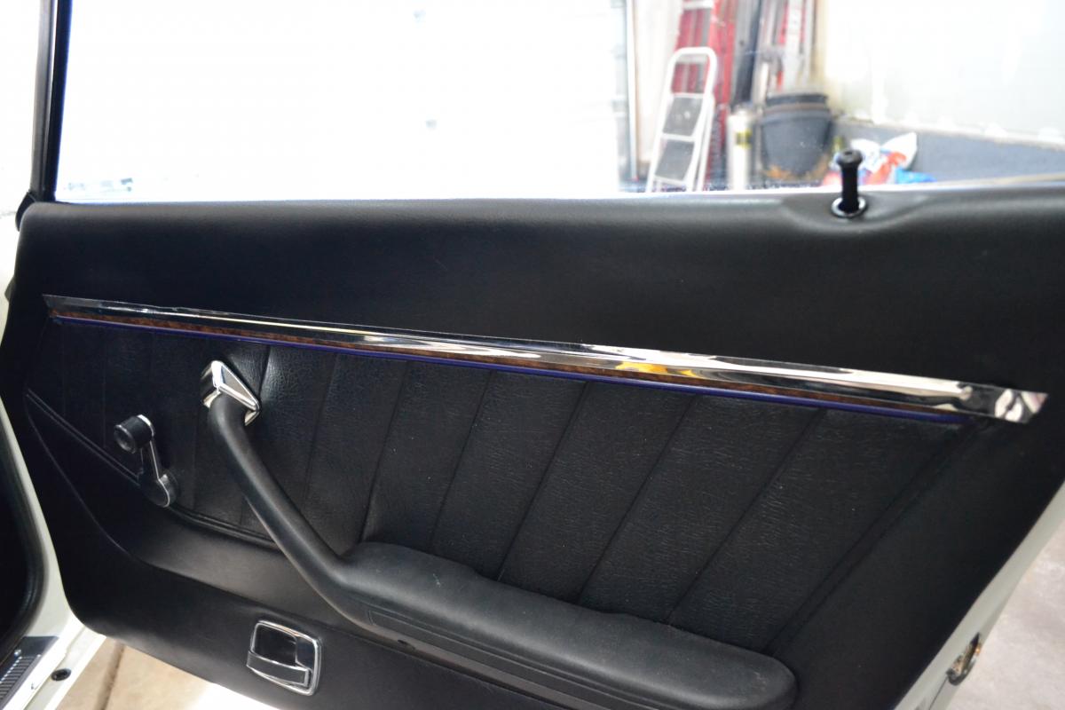

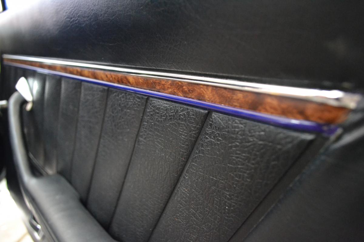

Applying the chrome vinyl. Heated it up with a heat gun, tucked the edges with a bondo squeegee, then trimmed off the excess.

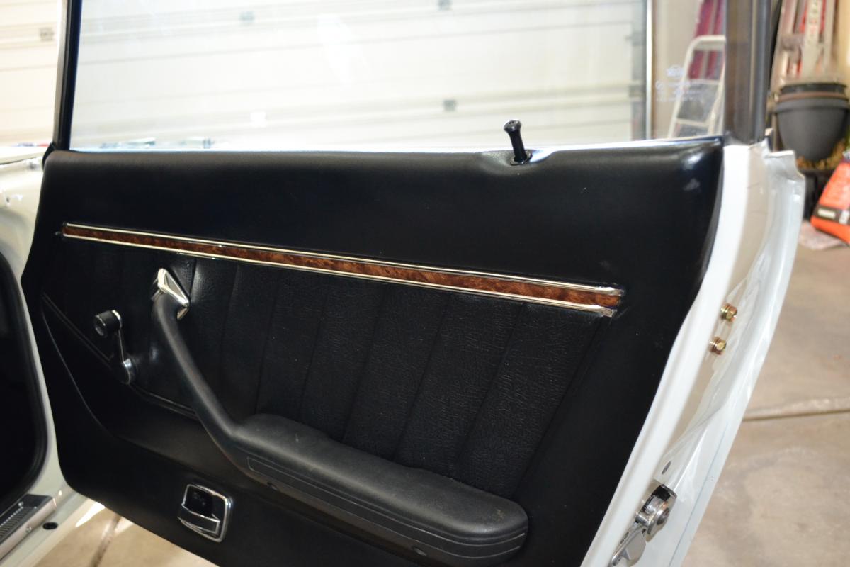

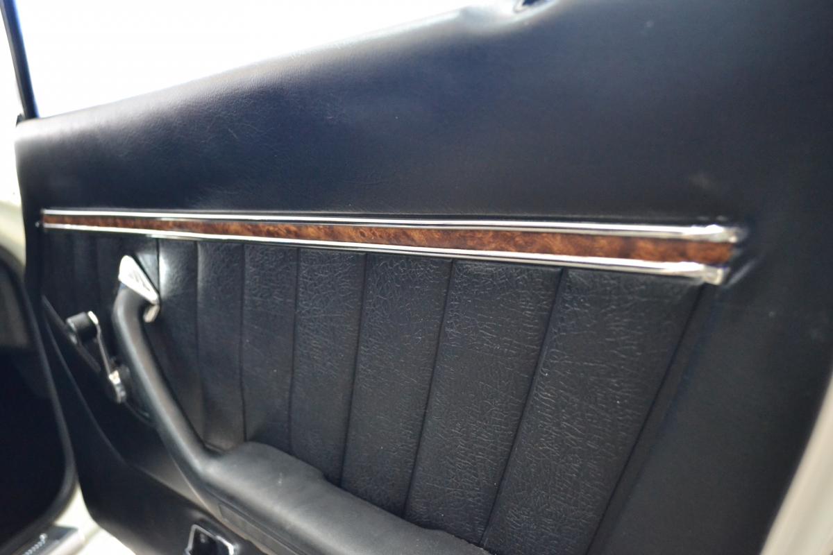

Much better.

That looks awesome! Good steady hand too. Did you use an exacto-knife? Going to have to look at the dog legs on my 77....don't recall there being a strip on mine, hmm...
Never mind on the knife, I see it now. Had to look at it again, nice!
How did you get your door panels to look so good. They look brand new, are they?
