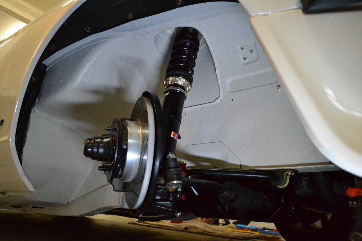

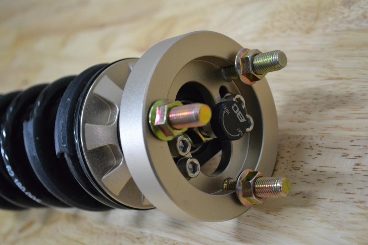

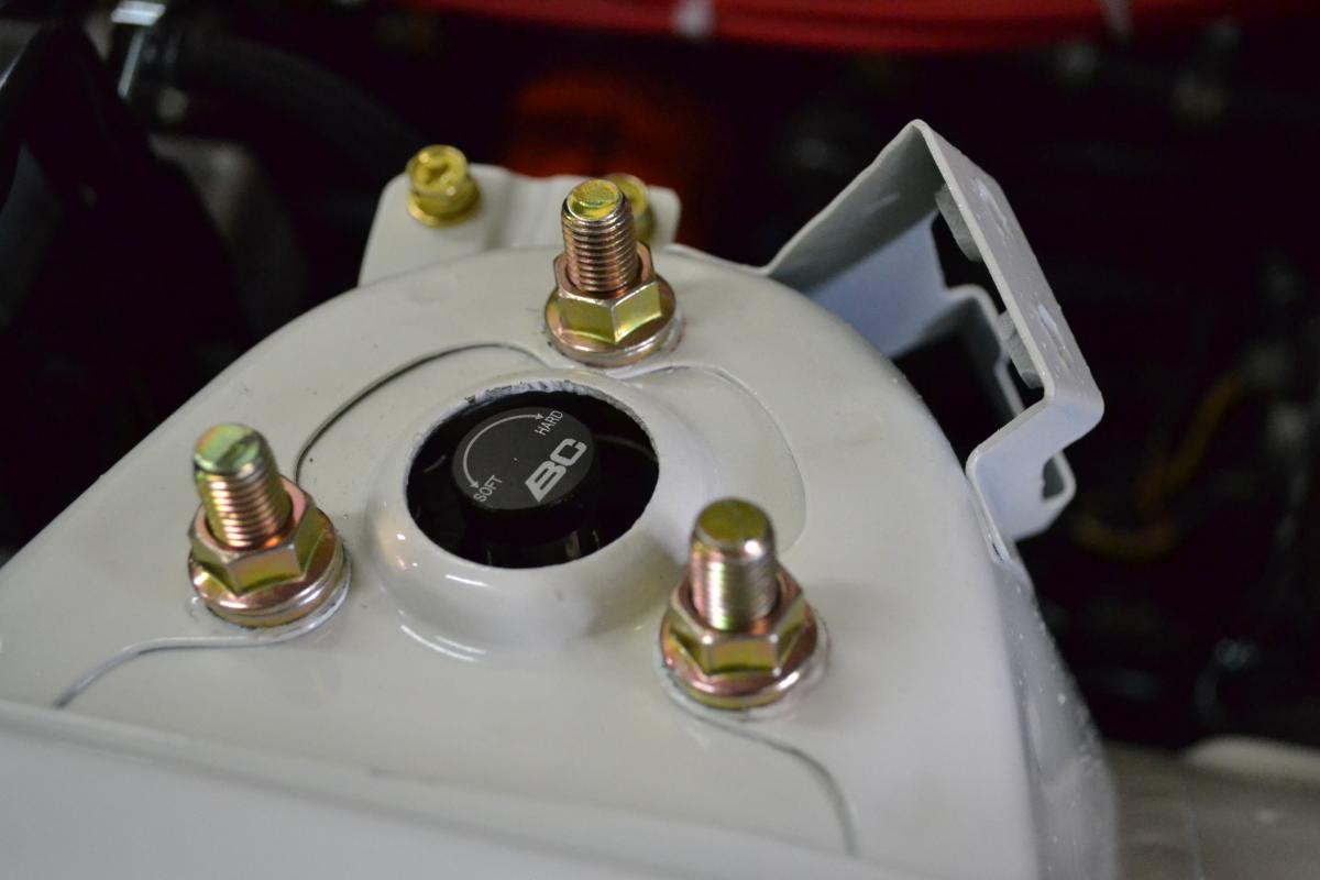

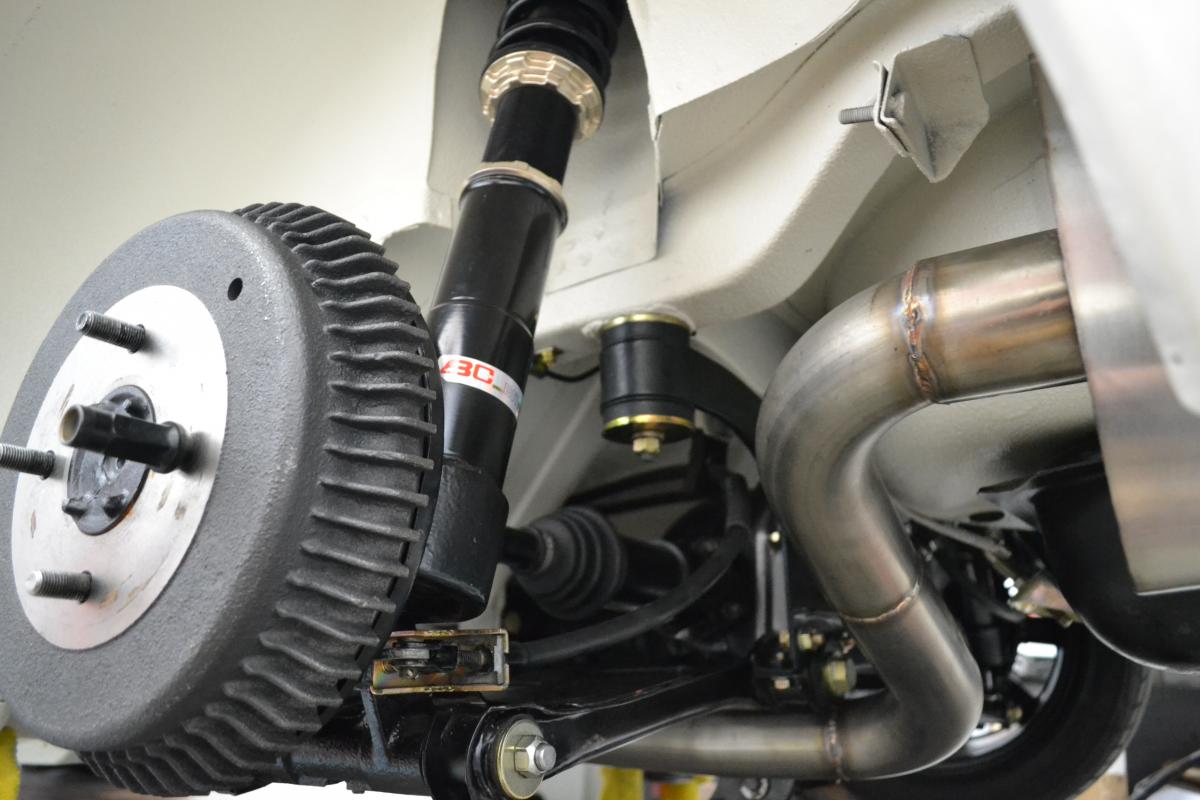

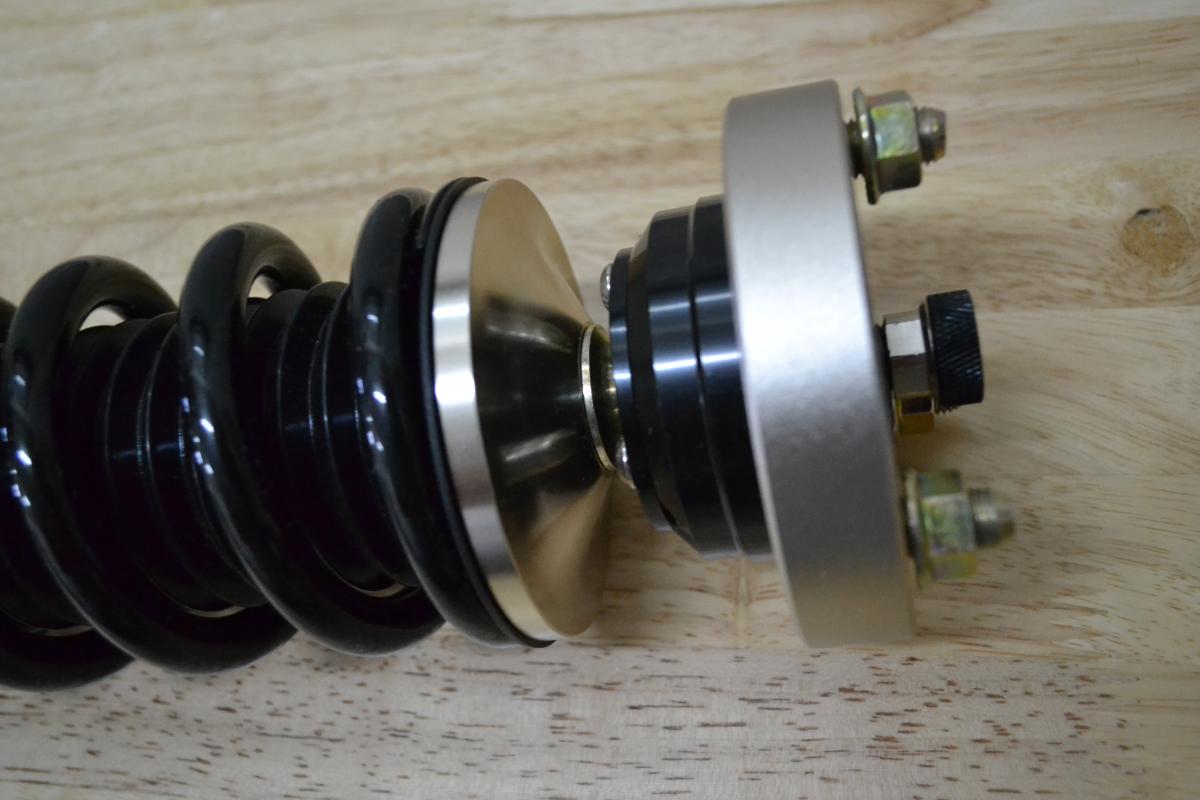

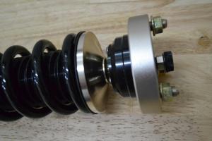

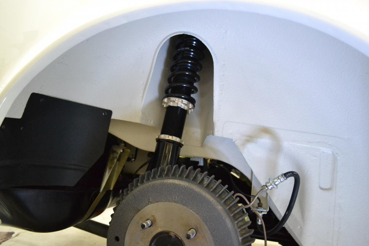

I finished installing my BC coilovers today. It took 3 days approx 16 hours to complete. I am super happy with the way the car sits now, plus I have a lot of adjustability in ride height, dampening, and camber. I took it out for a test drive and they ride pretty nice. A little more harsh than the Eibach springs but definitely more sporty. I feel like with the Eibachs it felt like it swayed a lot more, but these are firm. Even with the dampening set on 5 out of 20. I might turn the dampening all the way down and see if that helps. But overall I am extremely happy.
post-28616-0-78940700-1431830251_thumb.j
post-28616-0-63805900-1431830256_thumb.j
post-28616-0-86220600-1431830264_thumb.j

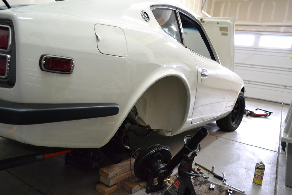

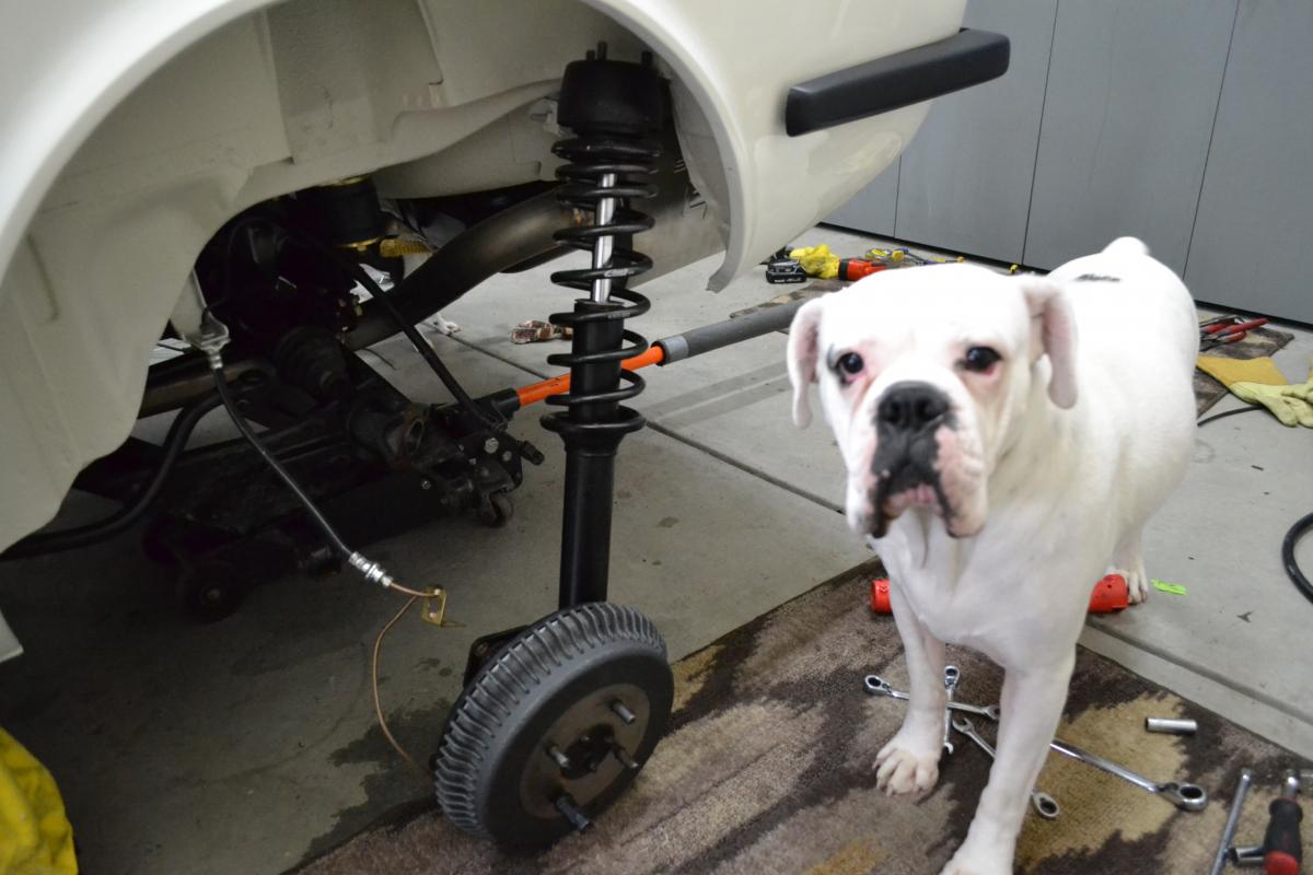

Dis assembly

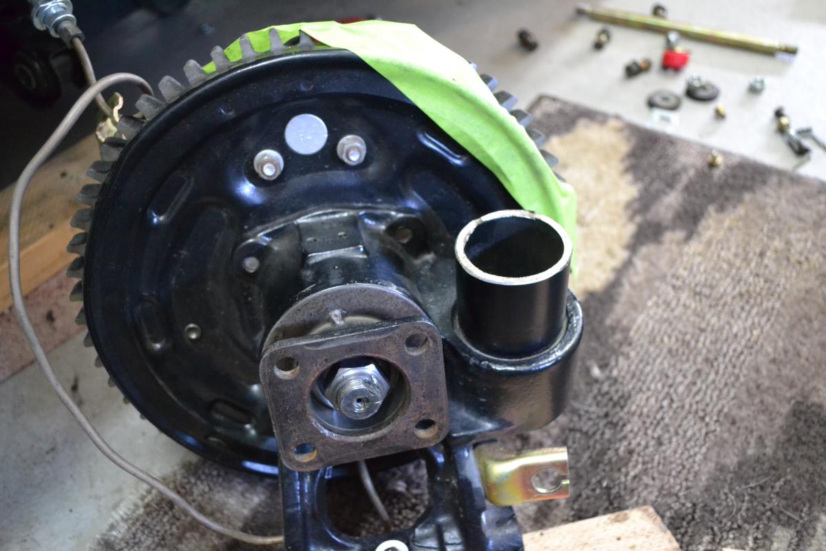

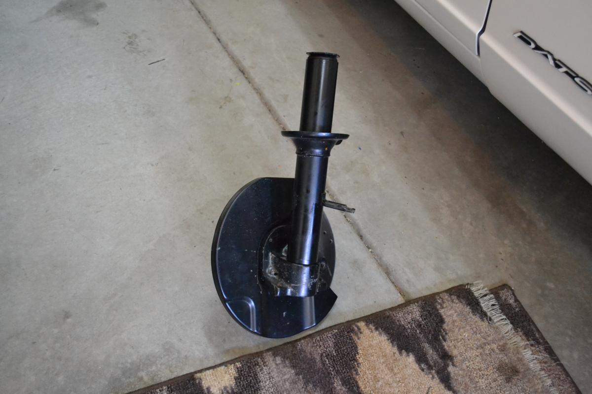

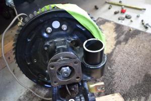

Factory strut housing cut. No turning back now
post-28616-0-27215200-1431830276_thumb.j

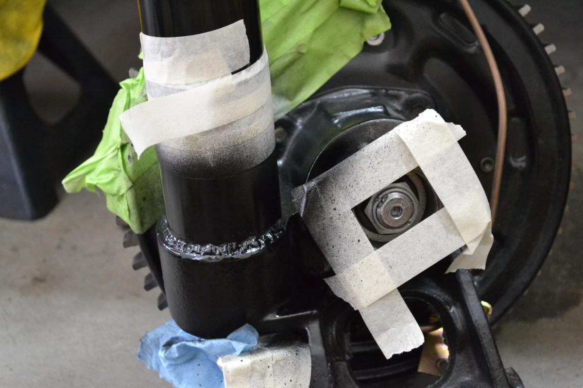

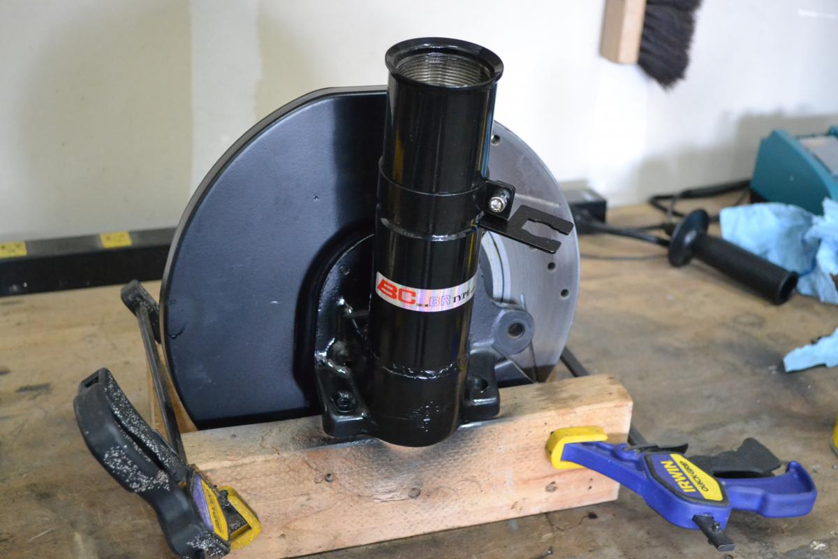

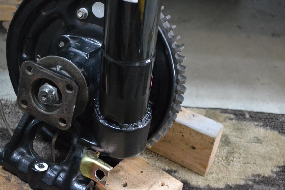

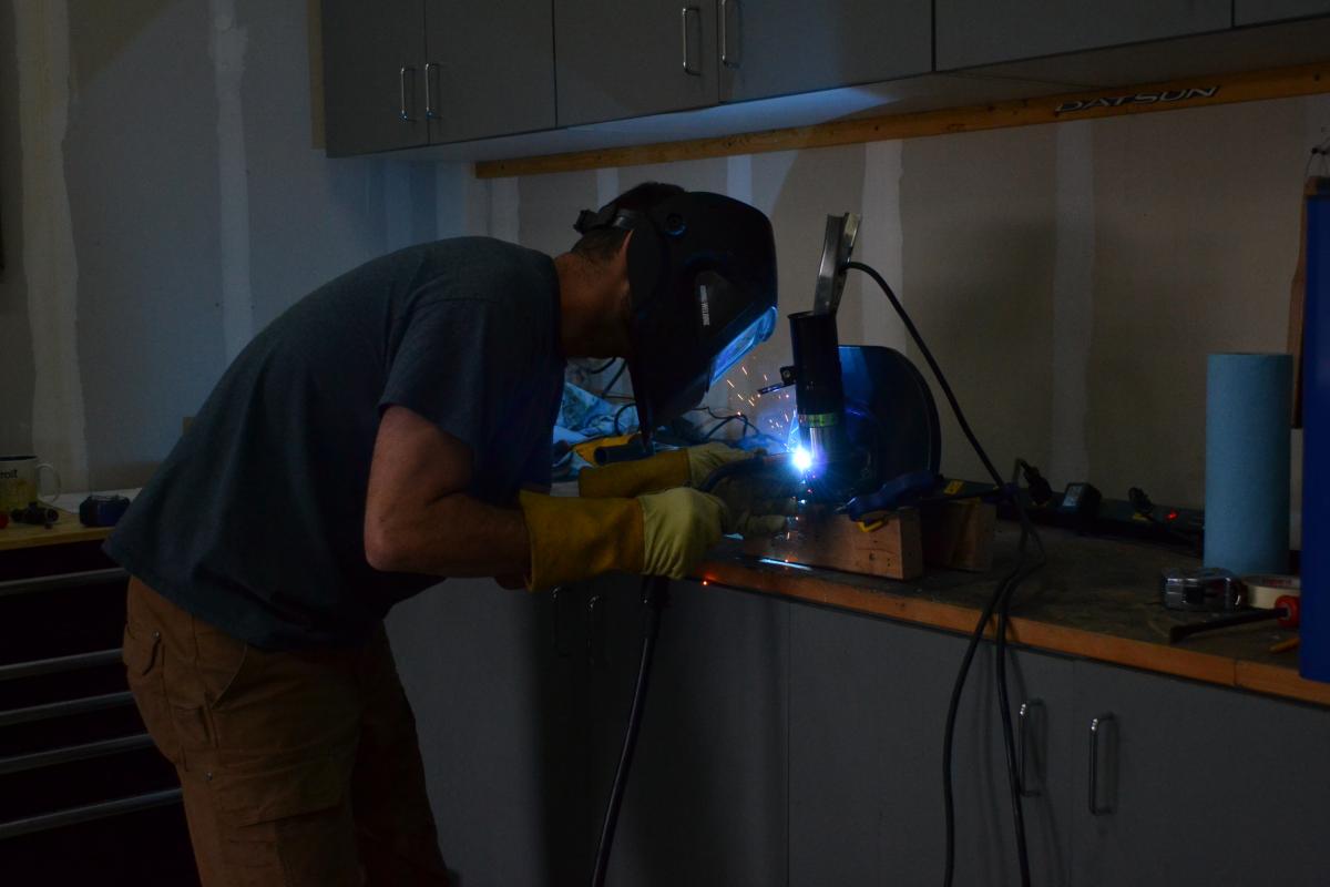

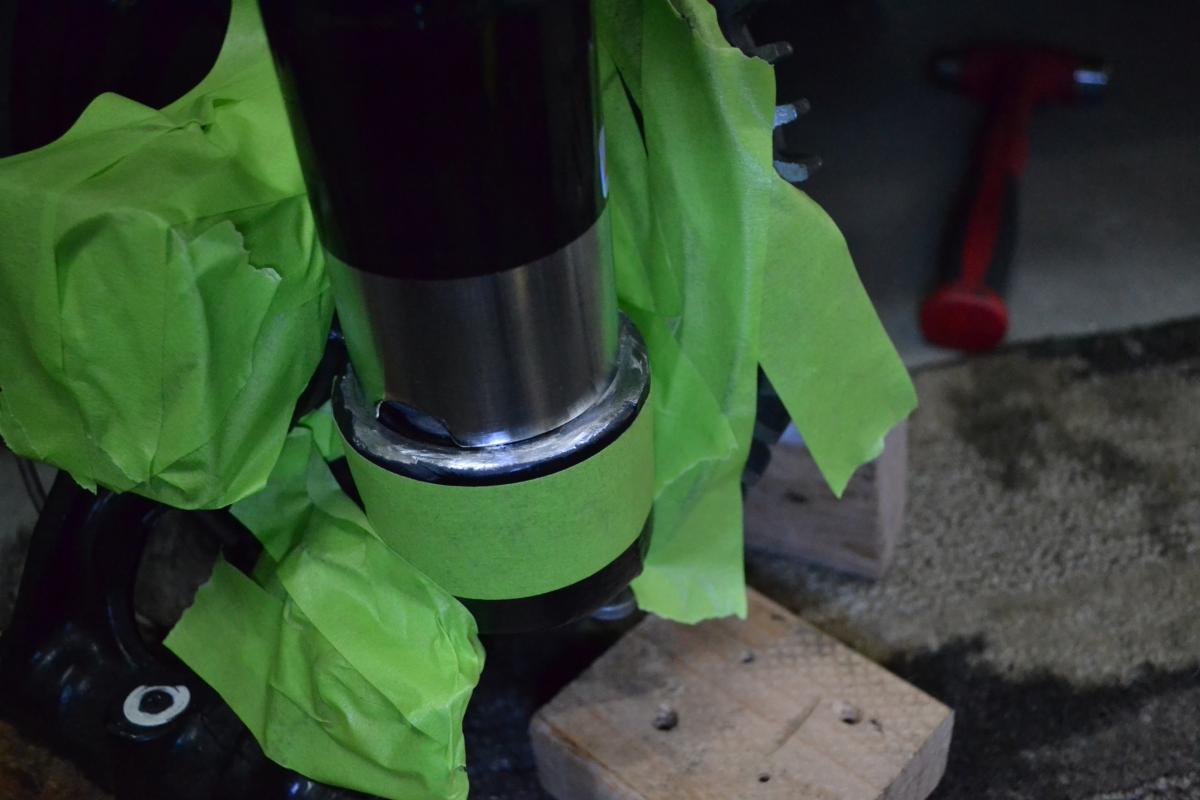

Prepped for welding

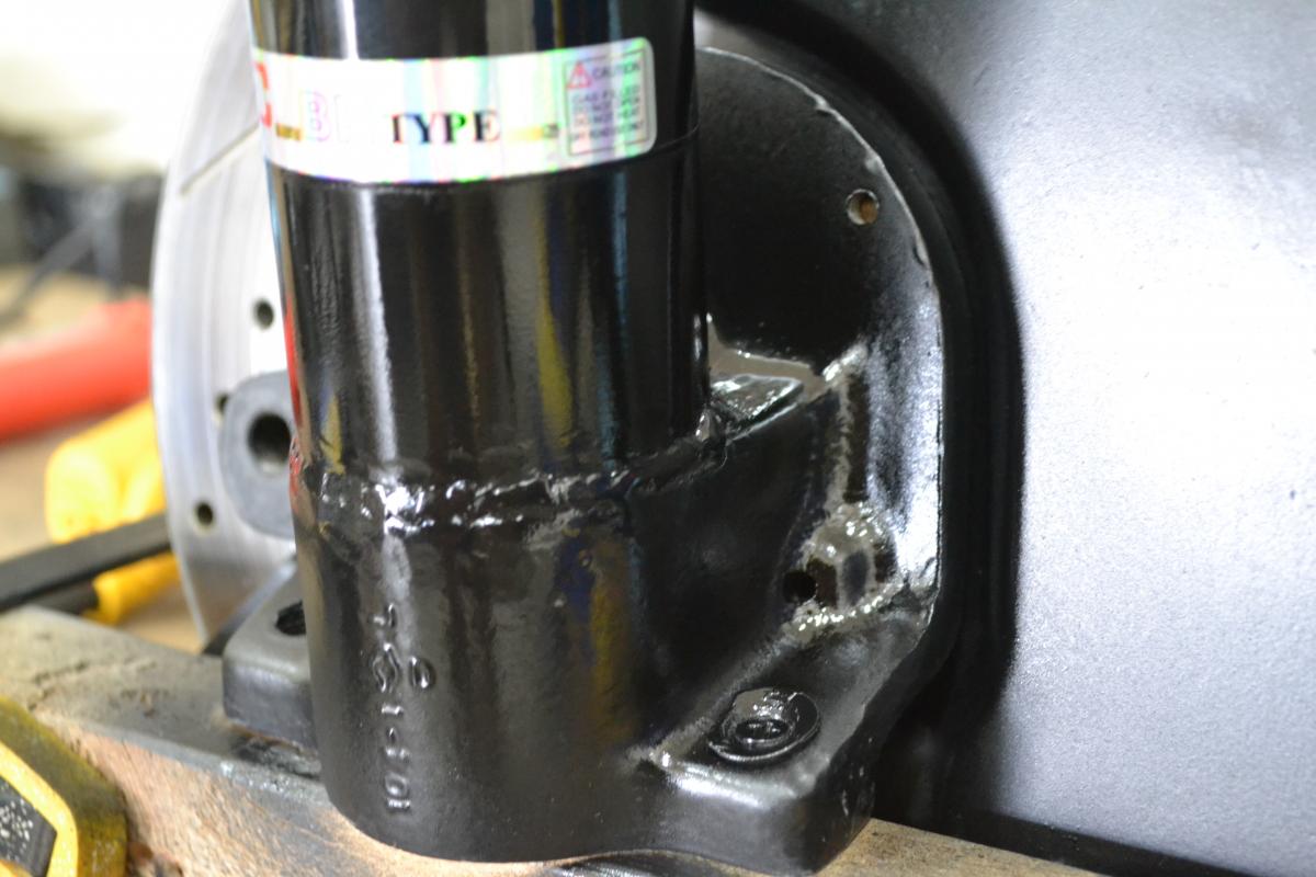

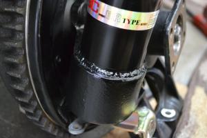

post-28616-0-50397700-1431830284_thumb.j

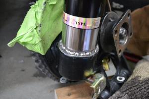

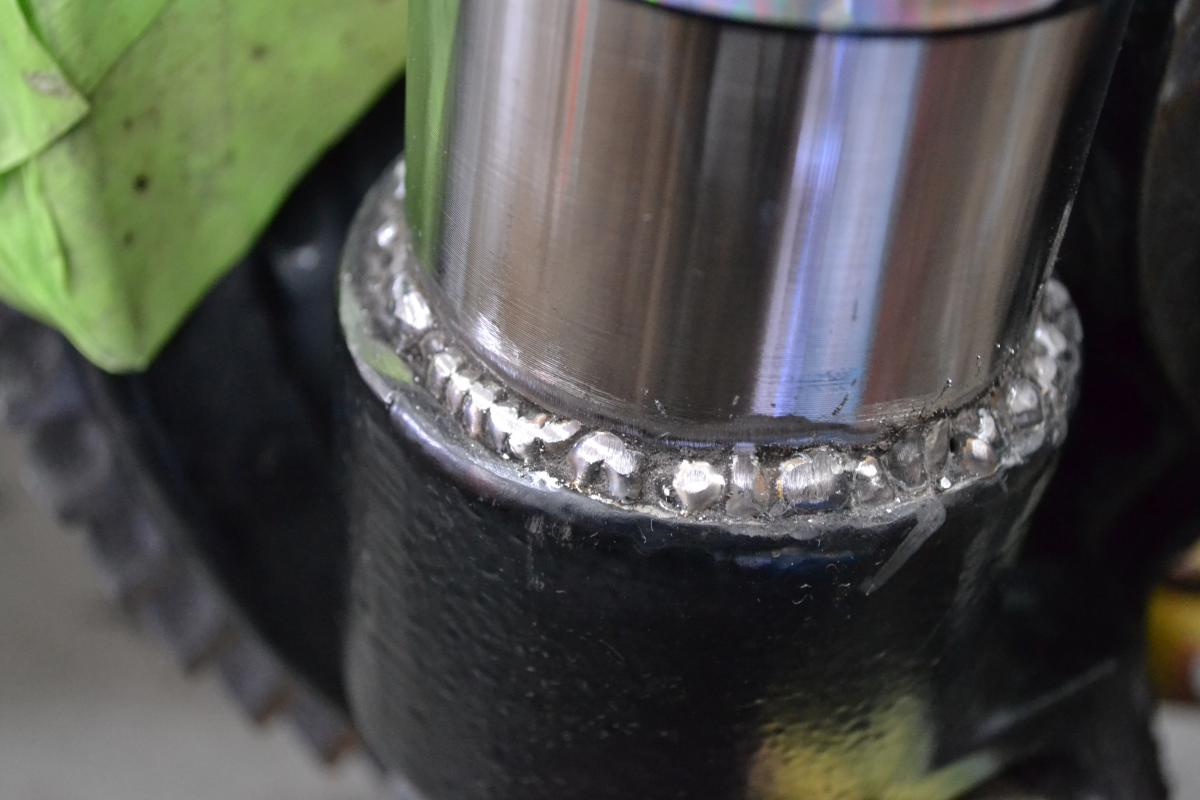

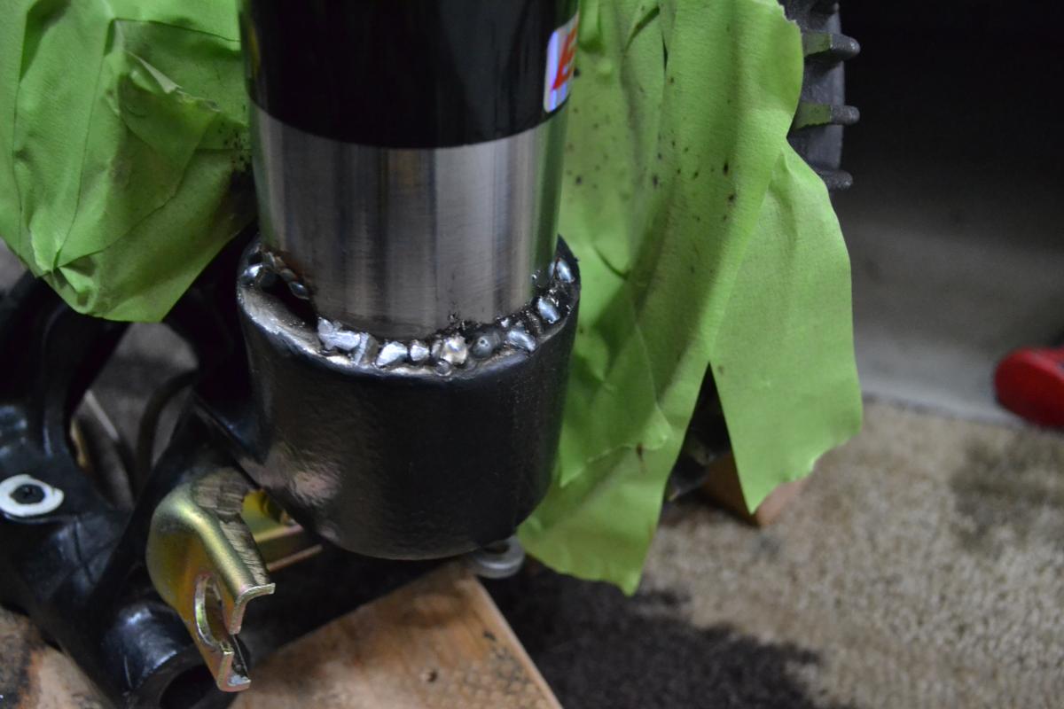

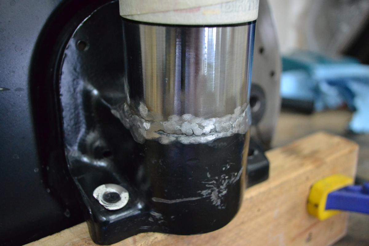

This was the first strut housing I welded. It didnt turn out great but I am confident in the welds. As a matter of fact these could've just been tack welded in place because they fit so nice and snug onto the housing.

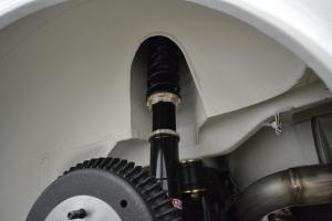

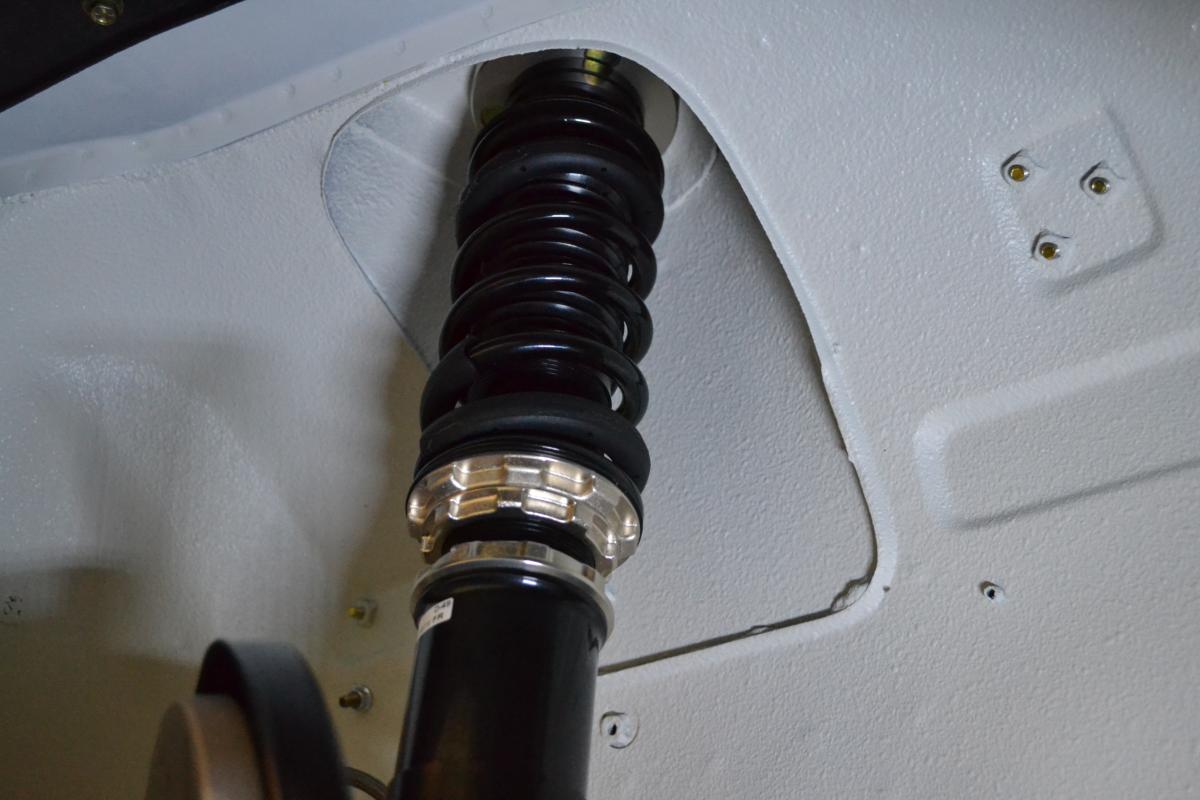

post-28616-0-93956800-1431830304_thumb.j

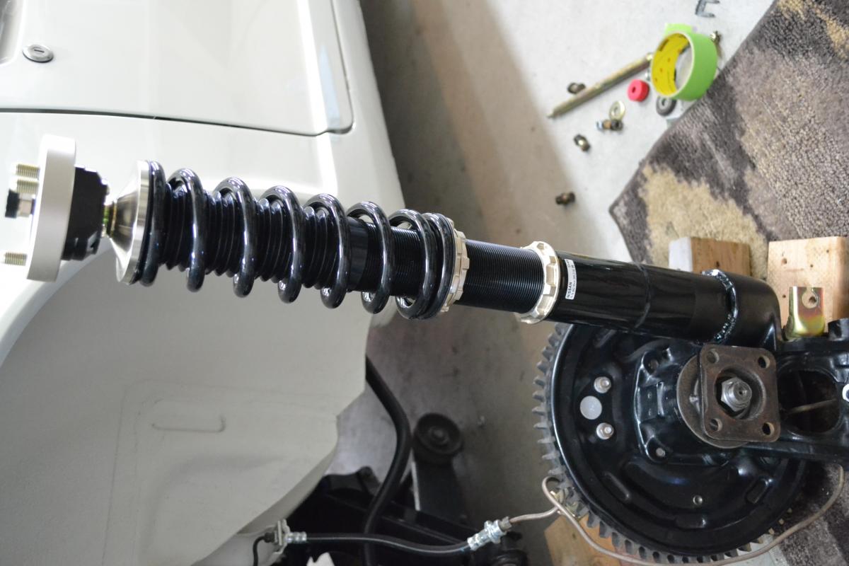

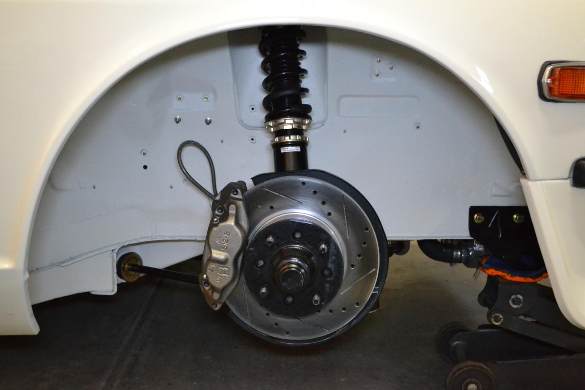

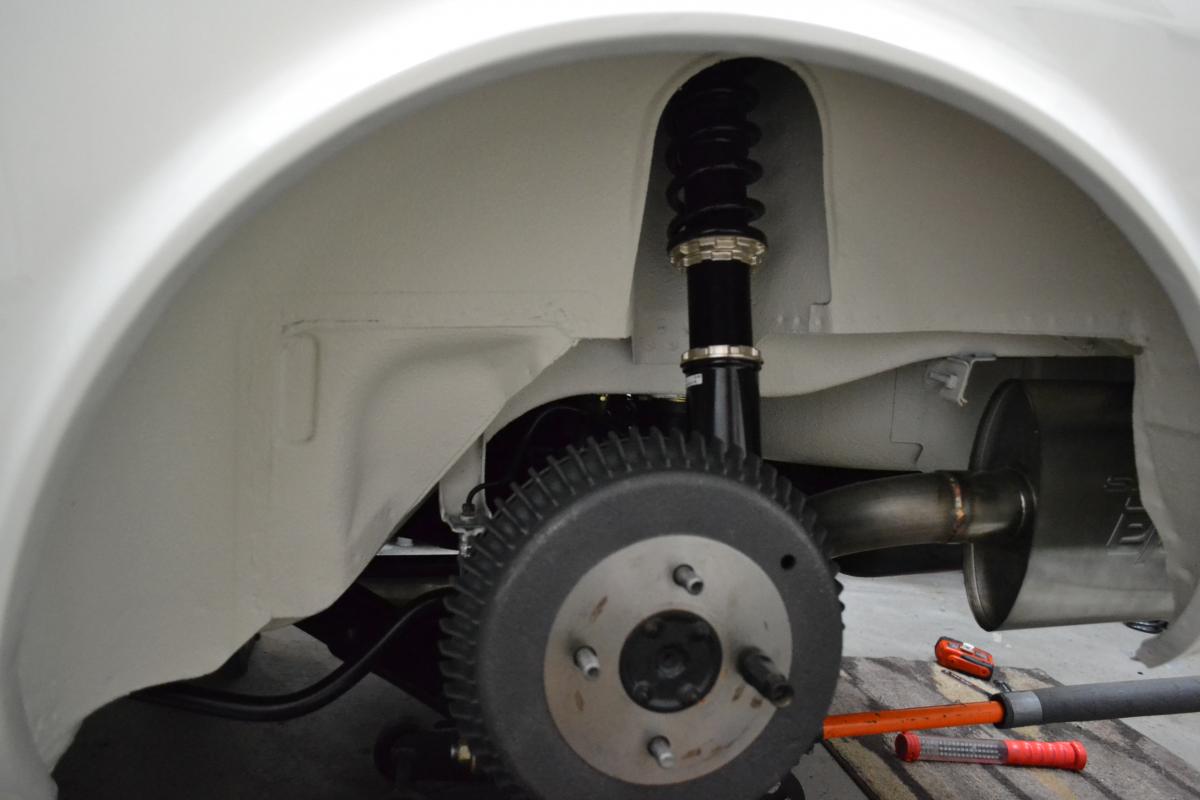

Reassembled and installed. One down three to go!
post-28616-0-87312100-1431830297_thumb.j
post-28616-0-75193300-1431830312_thumb.j

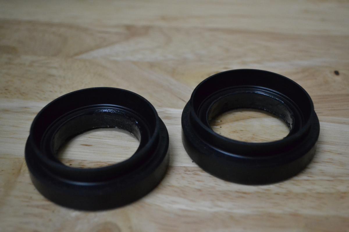

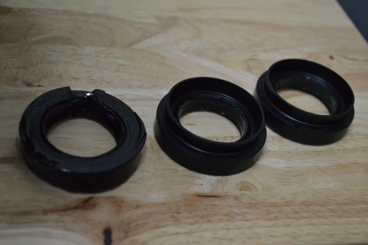

While I was in there I needed to replace my rear diff seals. I initially installed the Black Dragon seals and they were garbage. They started leaking within a week. So I purchased some OEM seals
post-28616-0-67421100-1431830763_thumb.j
Heres the Black Dragon one on the left and the OEM ones on the right

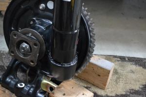

Did the other drivers side rear next (Charlie wanted to help)
post-28616-0-64238700-1431831050_thumb.j
This weld turned out much better I think
post-28616-0-76274000-1431831056_thumb.j

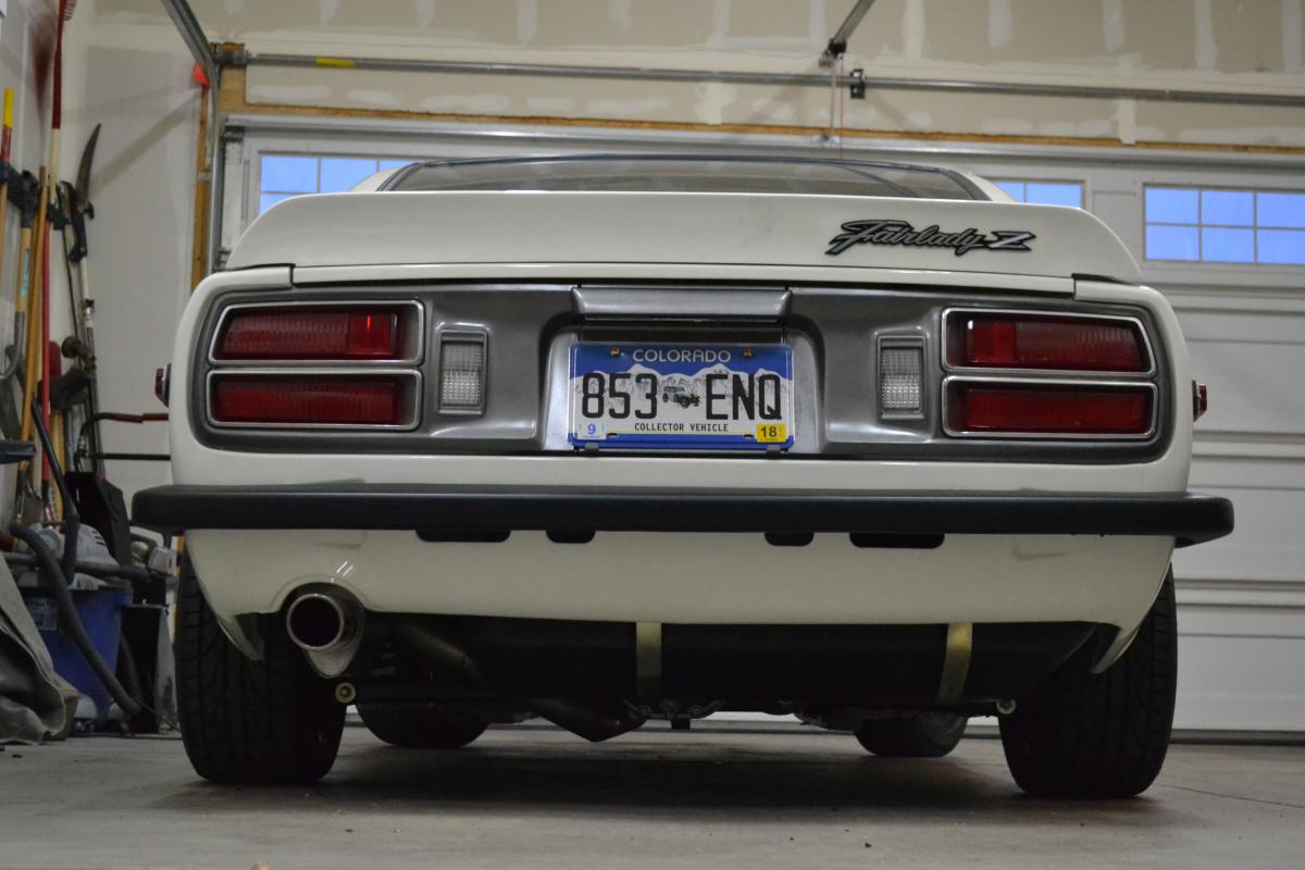

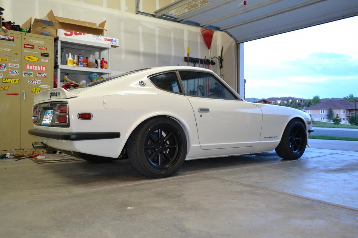

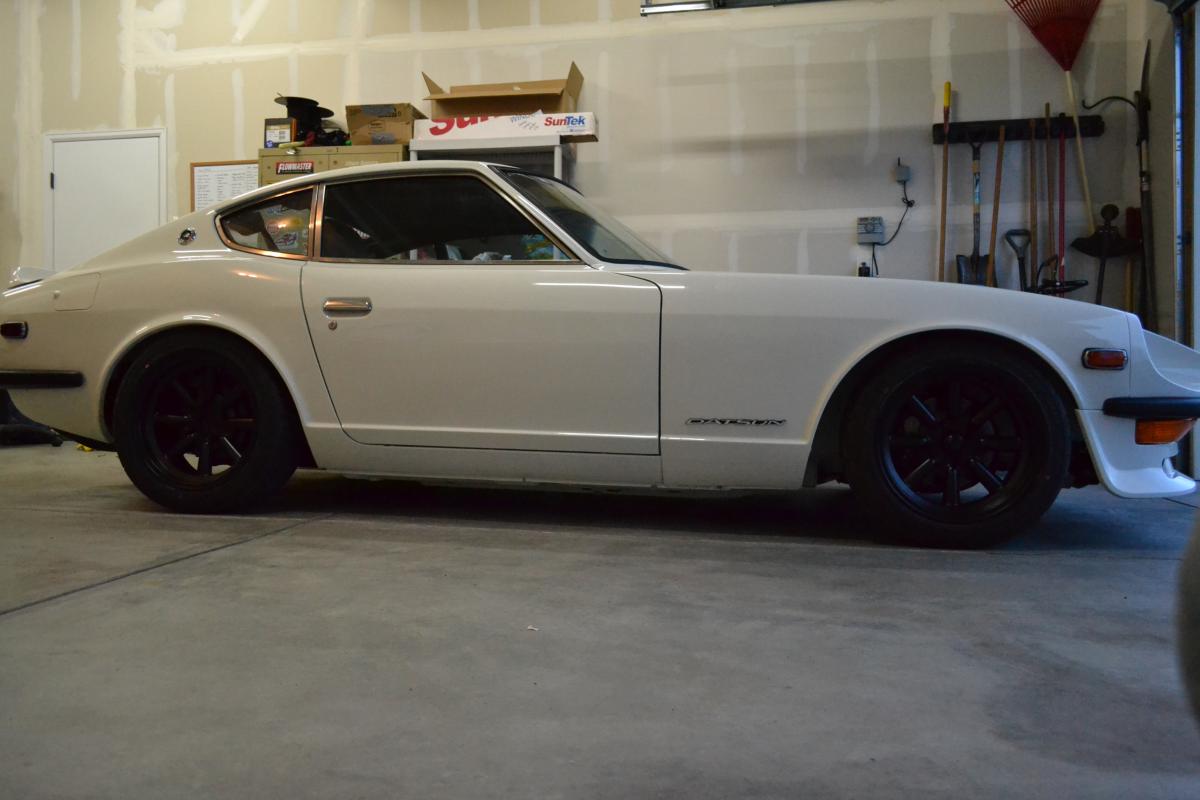

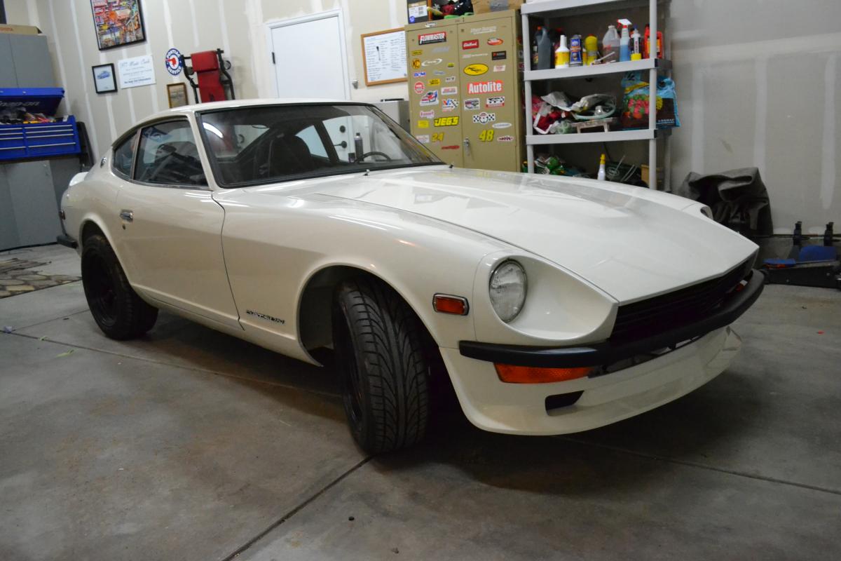

So heres how it sat before
post-28616-0-35125800-1431831751_thumb.j
And the "after" pictures
post-28616-0-17605400-1431831853_thumb.j
post-28616-0-94975000-1431831859_thumb.j
post-28616-0-62244500-1431831866_thumb.j
post-28616-0-53706400-1431831846_thumb.j
post-28616-0-17671700-1431831889_thumb.j
Looks so much better in my opinion, gives the car a little more "attitude"
I will take some better pictures soon

Did the welder use short stitch welding to prevent heat getting into the rear bearings. I remember you mentioned you didn't want to remove them if possable. Im on small tablet and can't see much detail on the photo.

Thanks, yeah I was sure to only do about 1 inch long welds at a time. Allowing it to cool before welding again. The hubs never got that hot.
