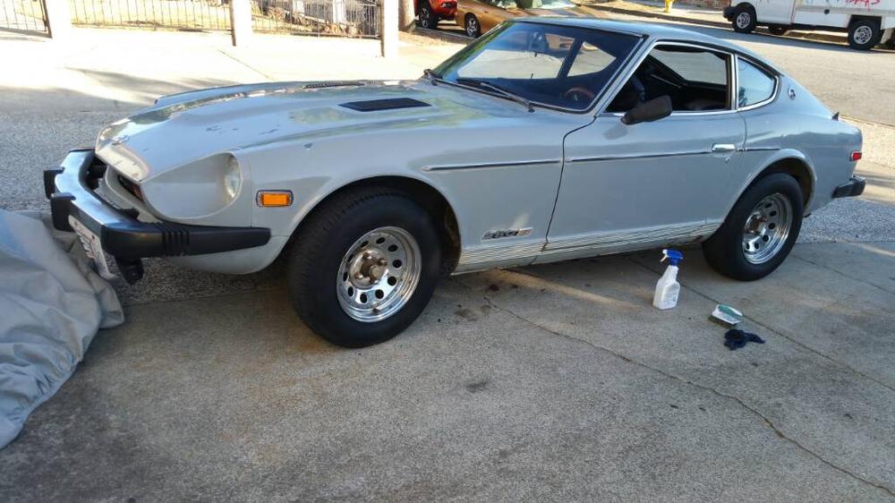

Did an alternator upgrade this weekend. Got the 90amp TYC unit with an internal voltage regulator from Z Car depot.
Straight forward install but bypassing the VR wiring threw my for a loop. All the diagrams I found online had different color wires than what I had. Apparently some 75' models are different than others. But after some research I found a thread by Tamo3 that helped me. Soooo thanks to you my friend!
