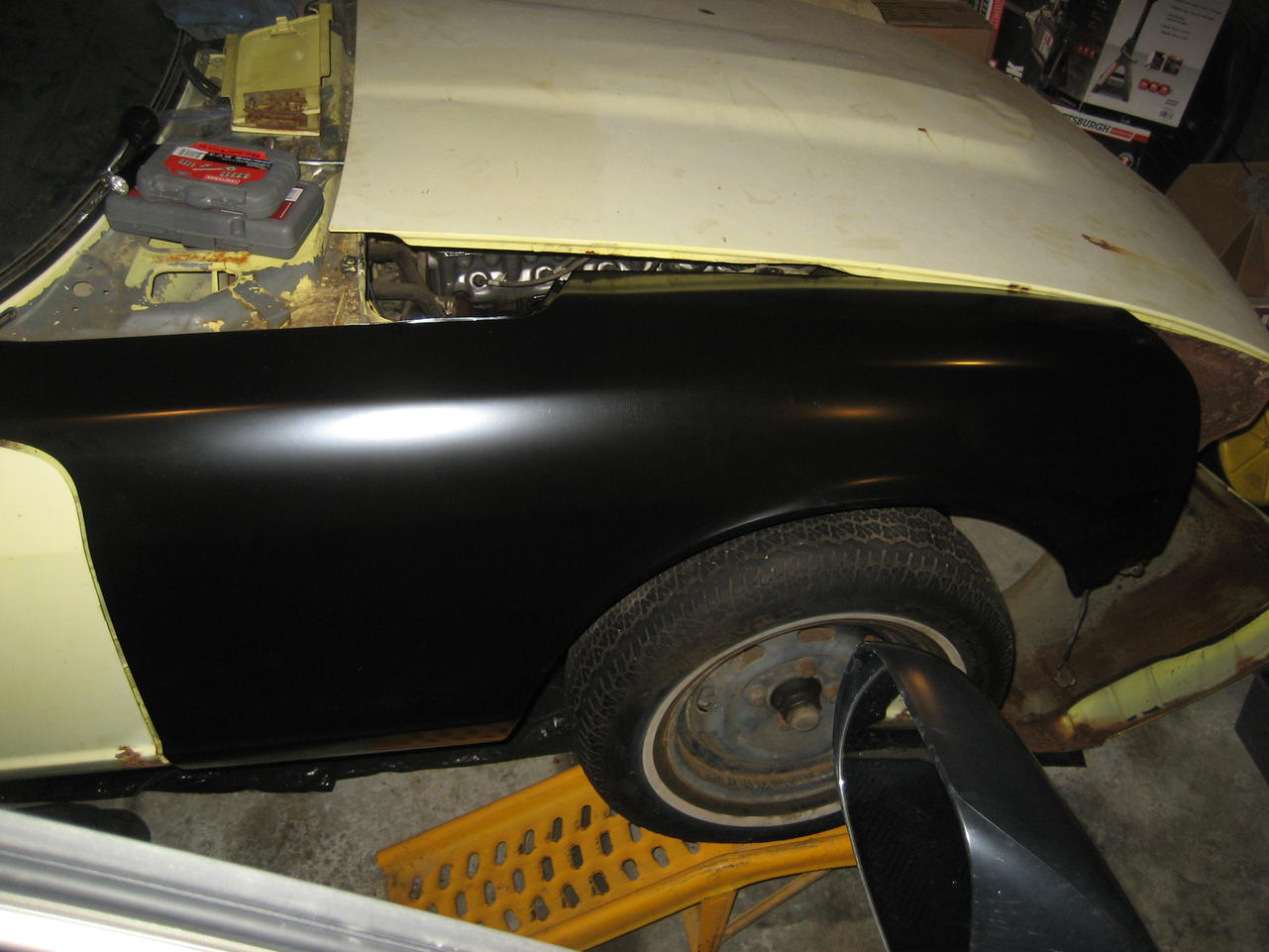

Joe,
I test fitted the new right fender and it lined up well, but it needed to be tweaked where it wraps around the rocker panel and lower mounting bolts. I was checking for overall fit and didn't intend to get it snug, since that will be worked out when the car is ready for paint. Since I've been unable to find good used fenders in the Midwest and my original fenders would require too much work, I decided to spend more and get new ones. However, I think buying used ones in good shape is also a good option, especially if you're working within a budget. The most recent person I know that has used a new Nissan fender on his project is E-tek, and it seemed to work well for him: http://www.classiczcars.com/forums/check-out-my-ride/36032-e-tek-racing-71-parts-car-resto-2.html

Joe,

[ATTACH=CONFIG]71517[/ATTACH]
[ATTACH=CONFIG]71518[/ATTACH]
