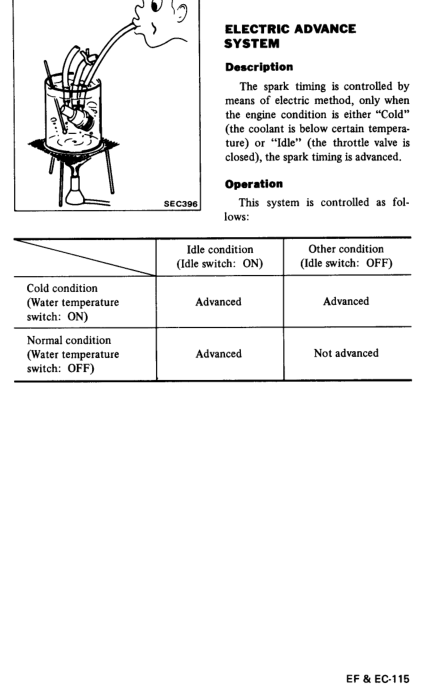

My point was that the ECCS controls timing. And that it only advances timing, which is what you want, when the TPS indicates that the throttle is at idle or the engine is cold. I would get in to the FSM and check that the TPS works right.

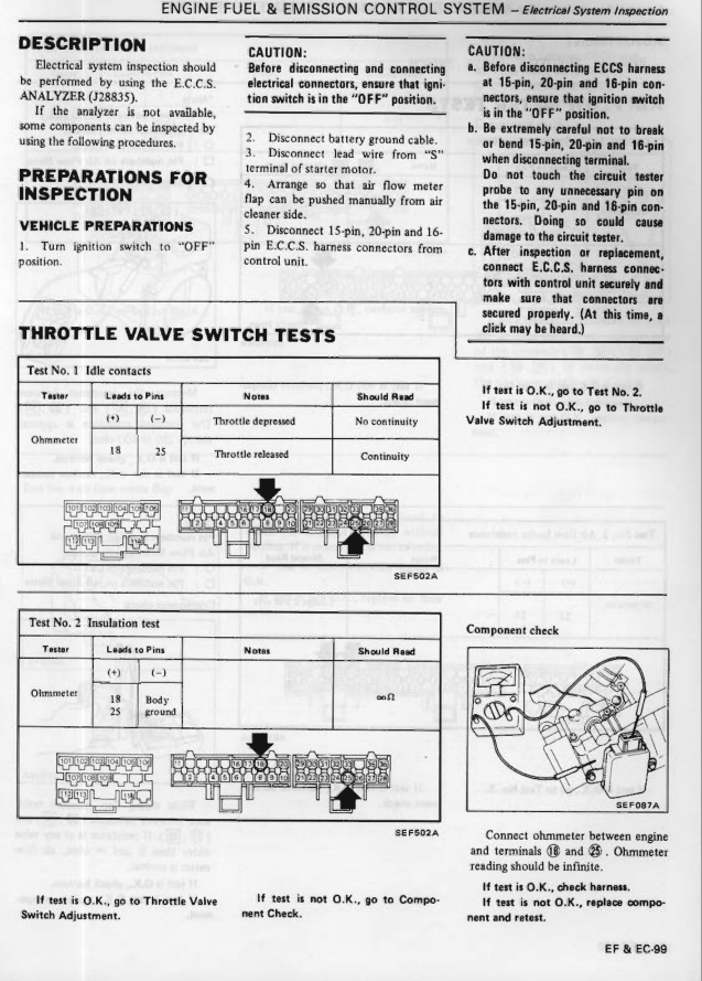

The problem is in the TPS .. my throttle body has been replaced . in the manual it has the TPS facing up mine is horizontal. Make a difference ? when I move it down RPM drops . I did the OHm test per FSM everything checked out. maybe time to pull the TPS apart and clean points ? or try to turn vertical but I would only have one screw to hold it on. Does the placement of the TPS hold open the throttle at idle ?

Did you test the TPS circuit at the ECCS plug, or at the TPS itself. It's always best to test at the plug first so that you know what the information the ECCS or ECU is getting.

Yes I tested the TPS circuit at the ECU box worked connection with no throttle infinity ohms at throttle(no connectivity). There is only a limited amount of adjustment by moving the TPS. I did move it up as far as it could go RPM increased but still did not help problem: Coming off high rev Rpms drop then car dies. Maybe I should open the TPS and clean contacts .
