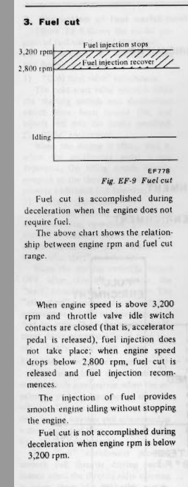

I've never really understood why water in the TPS would cause the problem that it does but I think I have it figured out now, thanks to this thread. I attached the relevant passage from the FSM. Water in the TPS apparently makes the ECU think the throttle is closed. Details in attachment.
One way to get a better idea of if it's the TPS is to watch the tachometer and note the RPM, when the cut out happens, and when it bucks. The tachometers aren't known to be super accurate so you may not see exactly 2800 and 3200 RPM, but if it happens consistently around those numbers, that would be a good indicator.
If that's not it, then the old fuel pressure gauge poking out of the hood plan would let you know that you're maintaining fuel pressure. If you have proper pressure but it still cuts out, then electrical has more potential.
