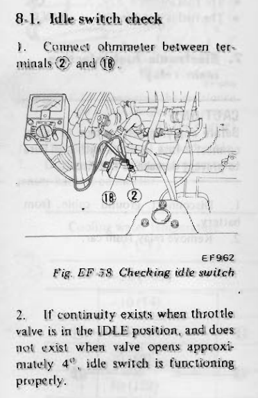

TPS saga: Zed - I reconfirmed that pin 2 at 35 pin shows continuity at idle and open when accelerator is depressed all the way to full throttle. Also, pin 3 is open at idle and all the way until the last couple of degrees till full throttle is reached then it shows continuity. I cleaned the contacts with 1500 grit sandpaper and spray contact cleaner and repeated the above tests. They are the same at the TSP and 35 pin connector.
The fuel cut seems to be consistent at about 3K rpm, only when at full throttle - ie. it will rev past 3K and accelerate well unless the TPS sends the full throttle signal. As soon as I release the throttle, normal running resumes.
As a further test, I disconnected the TPS wiring from the TPS, and there is no cut out in this mode of operation - ie. I can run at WOT with no cut out of the engine.
I guess I'll keep harping on the TPS. This is not right - open when accelerator is depressed all the way to full throttle
I don't know if you can see the picture I attached in my last post, or if you haven't seen that page in the FSM. Pin 2 should show continuity at idle then OPEN when the throttle is just off-idle - 4 degrees is barely cracked open. Basically, when you crack the throttle, Pin 2 shows NO MORE IDLE. What you're writing is that the ECU sees IDLE all the way up to full throttle. That's what I've been proposing. Plus the fact that you don't see the cut with the TPS unplugged supports that it's the IDLE circuit continuity (Pin 2) causing the fuel cut. There appears to be something wrong with the TPS signal to the ECU, not the ECU itself.
Zed,
I guess I'm not saying it correctly. Pin 2 shows continuity at idle. Then, when the throttle is depressed, it is open (no contiguity) all the way through the rest of the stroke of the throttle, including wide open. At all positions other than WOT pin 3 shows No continuity. At WOT pin 3 shows continuity. This is correct per the FSM.

It's odd though, that disconnecting the TPS removes the problem. That doesn't fit with the ECU being bad. Going back to what FastWoman suggested, when you say open, do you mean infinite resistance? Do you have a high quality meter that shows infiinty, or are you using a test probe with a beep? It might be that there's enough conductivity to trip the ECU's idle circuit, bit not enough to show on your probe.
Zed,
I'm using a middle of the road multimeter to do my checks. It's no Fluke, but no harbor freight either. It shows infinite resistance. Dan's post above (# 25) shows a similar result with the TPS disconnected. I surmise that the disconnecting the TPS removes any signal from entering the ECU's fuel cut circuit. I'd love to get a schematic for the ECU, so I could see how the signal is processed.
