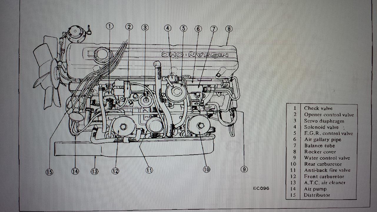

So from what i can tell I'm missing numbers 1,3,9,11,14 also have a small hole in 6.
I snapped some more pictures that i'll add in another post.

I believe the top one is the Anti back fire valve? What do the other 2 go to?
The hose that goes off camera have a screw in it capping it off. I replaced that with a actual vacuum cap but where is it supposed to go?

"I believe the top one is the Anti back fire valve? What do the other 2 go to?"
The large top nipple is supposed to go to the anti-backfire valve. The lower large one went to the air pump. On 74, the smaller one I think went to the thermostatic control on the air cleaner. I believe they moved that control valve around a little depending on year, so I'm wondering... Are you sure you've got the original air cleaner for your year, or maybe someone swapped a 74 air cleaner onto your car?
"The hose that goes off camera have a screw in it capping it off. where is it supposed to go?"
That small hose also went to the anti-backfire valve. It was the control signal that told the anti-backfire valve to open when the vacuum got very high.
